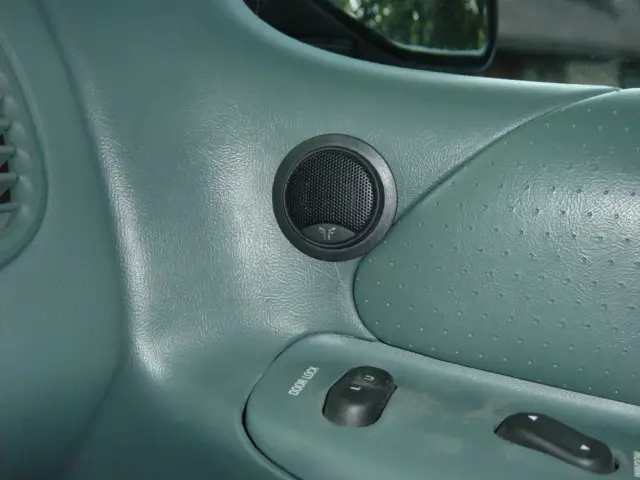

This is where mine went and they sound pretty good,

Mine are mounted in the same spot as Shadow's too. Sounds fine for me.

I did it the way Shadow did too. Although I've not listened to kick panels myself this morning's drive with 4 windows down, sunroof open, and traffic calls for tweets pointing at your head with no interference. That and more power...always more power...

Right under the tweeter behind the door trim there is space for the crossover too. I used stock speaker wires for minimal hassle.
