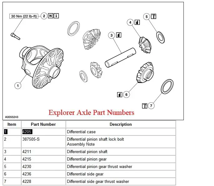

Im not positive for the Explorer, but on Ford's other IRS cars like the MN12 cars and the Cobra, you have to buy a diff that is compatible with the axle snap rings.
A standard 8.8" diff doesn't have any provisions to hold the axle shaft inside the differential.
Are the Explorer and Expedition diffs the same style or not?
can anyone confirm that. someone had access to the shop schematics before when we were trying to determine the front axle.
Not sure if you ordered it already, but here are some pictures of the rear and half shaft removal instructions. It doesn't look like their is a snap ring. And the part numbers for the carrier are the same as the F-150 8.8. The only different part number is the side spider gear thrust washer and the pin that holds the cross shaft, but that doesn't matter. I would imagine the side spiders would be different if their was a snap ring. At the bottom their is a picture of the mustang IRS 8.8, it has a completely different carrier than the F-150 and Explorer 8.8 and the axles on the mustang do have snap rings. Hope this helps and is not too confusing.
