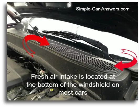

Now lets explain this issue, basically there are two issues.
1.Exhaust Leak from the engine side that will not appear unless there is a hard acceleration.
2. Fresh Air Intake leaks.
and what happen is while acceleration the engine bay gets filled by exhaust odors and the odors finds a way to leak inside cabin through Fresh Air intake.
So anyone want to confirm this go ahead and cover your fresh air intake with duct tape
then go for a ride and try
Careful: the duct tape is not a solution, only to confirm this leak, when you use the duct tape don't run the A\C on non circulation that might damage the A\C fan.
To solve this issue permanently, The whole Fresh Air intake plastic peace need to be take off then seal every whole in it from the engine side and seal the hood rubber with silicon . but for now the silicon is working fine.

i believe the smell also finds a way to leak inside from the front " fresh air intake"![]()
since the cat converters is located right next to the engine i think they are our main issue.
i have noticed after every long drive when i go out of the car i immediately smell the same smell from the sides, if i come closer to the front tiers the smell gets stronger. which prove it's a cat converters issue.
i don't know why ford designers put the cat converters is such location , should be right beneath the car like most of the cars, easy to change also will not cause extra heat to the engine room.
i think the best way to fix this issue to change the entire exhaust system from the engine to the end back and relocate the cats to be beneath the car.
also ford needs to check the front a\c fresh air intake this is also may cause the issue.
