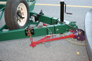

An equalizing hitch has lift bars that transfer some of the trailer's weight to the front end of the chassis. The full tongue weight of the trailer is not carried solely by the rear end of the vehicle. You hook everything up, then pull up the lift bar chains with a pry bar and your truck magically becomes level with the trailer.
