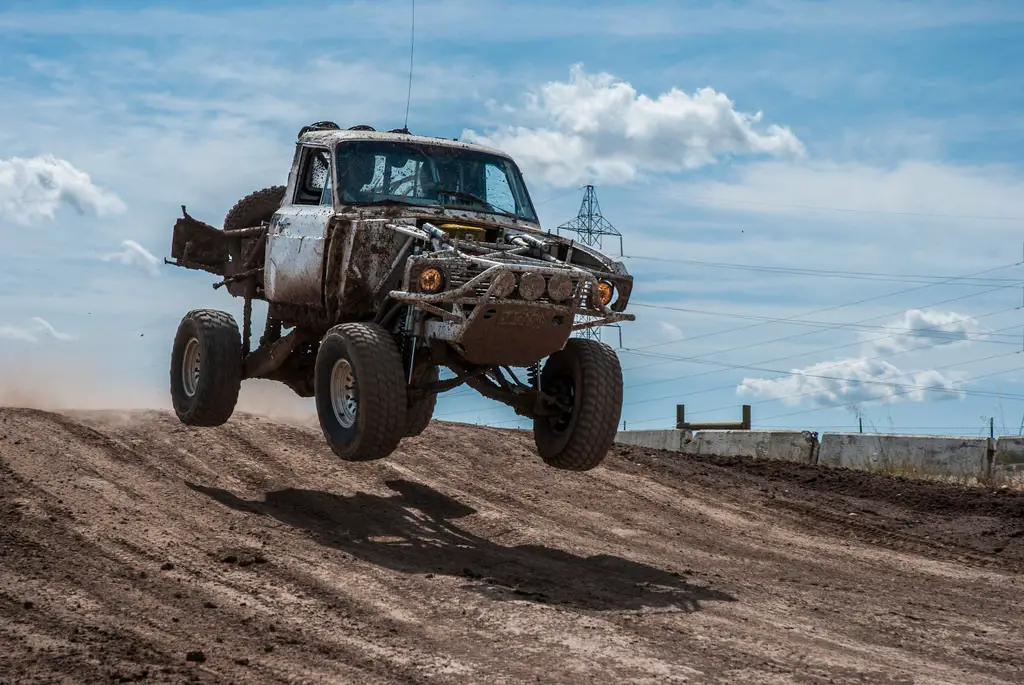

And yes I'm building it into prerunner for my ford courier race truck.
