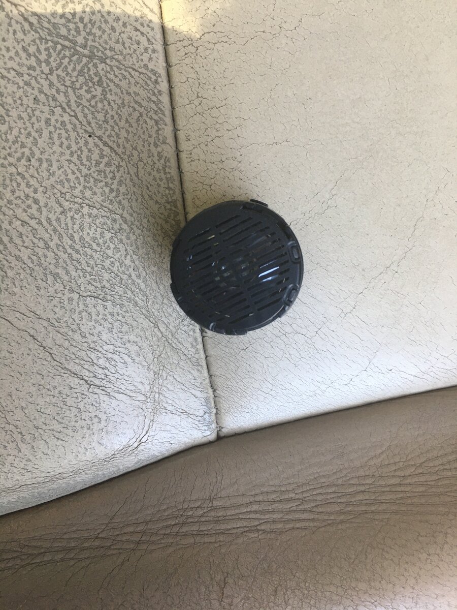

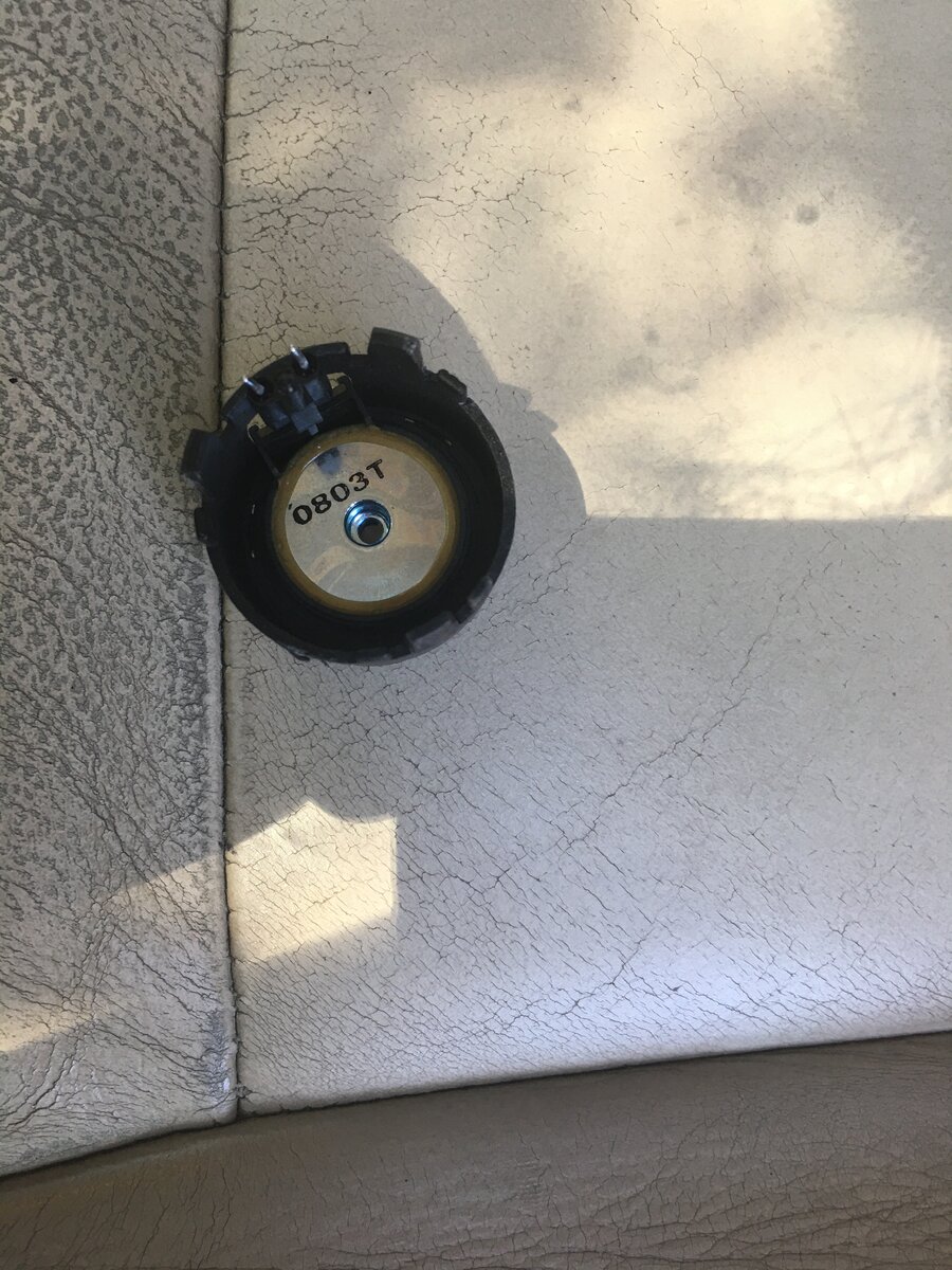

Well, I appreciate everyone’s replies and help….but problem solved. There is a small round speaker that plugs into the back of the instrument cluster. This provides the sounds and dings for all the various alarms: door open, key in ignition, RSC alarms, low fuel as well as turn signals and such. Took a little bit of effort, but it just popped right out. No wires to snip and no permanent damage. Should be easy enough to pop it back in place if the need arises. But at least there are no more alarms sounding off constantly and that’s all I really wanted.
Thanks again.

Hello again. I’ve posted before about the issues I’m having with the RCS warning alerts going off in my 2010 Explorer. Here is a list of everything that’s been done to this vehicle so far, some specifically related to addressing the RCS, some not so much.
All 4 wheel speed sensors have been replaced (one in the back was replaced a second time because the shop said it was cut and another time codes were saying a rear sensor fault so that one got replaced, but I’m unsure if it was the same position. And the ABS light is still on. )
All 4 brakes replaced including pads, calipers and rotors. (There’s been no actual brake related issues since replacing them, however since another unrelated repair was made, the brake is on on the dash.)
Both front wheel hub bearings have been replaced.
One front half shaft replaced.
I believe a rear haft shaft was also replaced along with the pinion seal on the rear diff.
The front differential was either replaced or rebuilt due to bearing noise. (This resulted in the brake light staying on on the dash. It also resulted in a bizarre issue with the operation of the key fob locking and unlocking the doors, setting the alarm and the remote start. Also bizarre, those issues have since cleared up on their own and are now functioning like normal.)
This alarm issue is beyond annoying and happens all the time, randomly. It will go off at anytime, even just sitting still, or just after starting the vehicle and before even putting it in gear.
At this point, I’ve come to the conclusion that the problem is in the computer system that controls it, but it’s way too expensive to replace.
My main question right now is, is it possible to disable the alarm? The sound is coming from behind the instrument cluster, I’m assuming from the same module that makes the blinker noise. I don’t care if all the other alerts and noises, such as turn signals and stuff, are disabled as well, I just want this godawful noise to stop. Help!!!
Thanks again.
View attachment 431158View attachment 431159
I am having the same annoying ABS/RCS alarm problems. How did you remove the speaker? Did you have to remove instrument cluster to access it? This appears to be a plausible fix until I can find a replacement ABS electronic control module.
Hi. Sorry for the delayed response. Been kind of busy. So, to answer your question, yes, I removed the instrument cluster. There are two small bolts that hold the panel underneath the steering column. Once removed, there are two small bolts that hold on the panel surrounding the cluster. With that removed, there are four bolts that hold on the cluster. Pull the cluster out and unplug the wiring harness. It has kind of a lever lock mechanism to it that you’ll need to pry up and it will release. You’ll see the small speaker on the backside of the cluster. It’s small, round, and set into a pocket so it’s difficult to get to, but it just snaps into place. You can pry it out with a flat blade screwdriver. As I mentioned before, this speaker provides the sound for ALL of the alarms, alerts and indicators. You’ll no longer hear the turn signals flash, the buzzer of the key in ignition, seat belt warning or any other alarm. So it’s something of a blessing and a curse.

Had this on my 2010 explorer ended up being the hubs needed replaced.
Pull your cluster out and behind it it a little thing that makes the noise. I took mine out but never put back in. It's kinda soldered on if I remember it's been a couple years, but barely had to heat the soldered and it popped right out. Simple...
But no more tick tick for the turn signals.
Another member had mentioned a battery/starter harness. I looked it up and it’s basically the complete battery cable harness, both positive and negative together along with other connections. He said replacing his solved his problems. Problem is that’s a $130 harness, so I haven’t replaced it yet. I have noticed there is some corrosion around the negative terminal and post, so my next step will be to clean that up and see if that helps, but it will be a few weeks before I’m able to do so. (I’m a truck driver and out on the road right now.) Hope this helps. If you should try cleaning your battery cables, or replace them and it helps with the problem, please let me know. Thanks.
Thank you, thank you, thank you!! It worked!! No problems at all except that I might have gotten a little impatient and broke one of the mounting tangs on the speaker getting it out of the cluster. No biggie, I seriously doubt I'll ever replace it. I've been putting up with that obnoxious alarm for a few months, now my wife and I can drive in comfort without the noise every four minutes. Thanks again for the advice.
