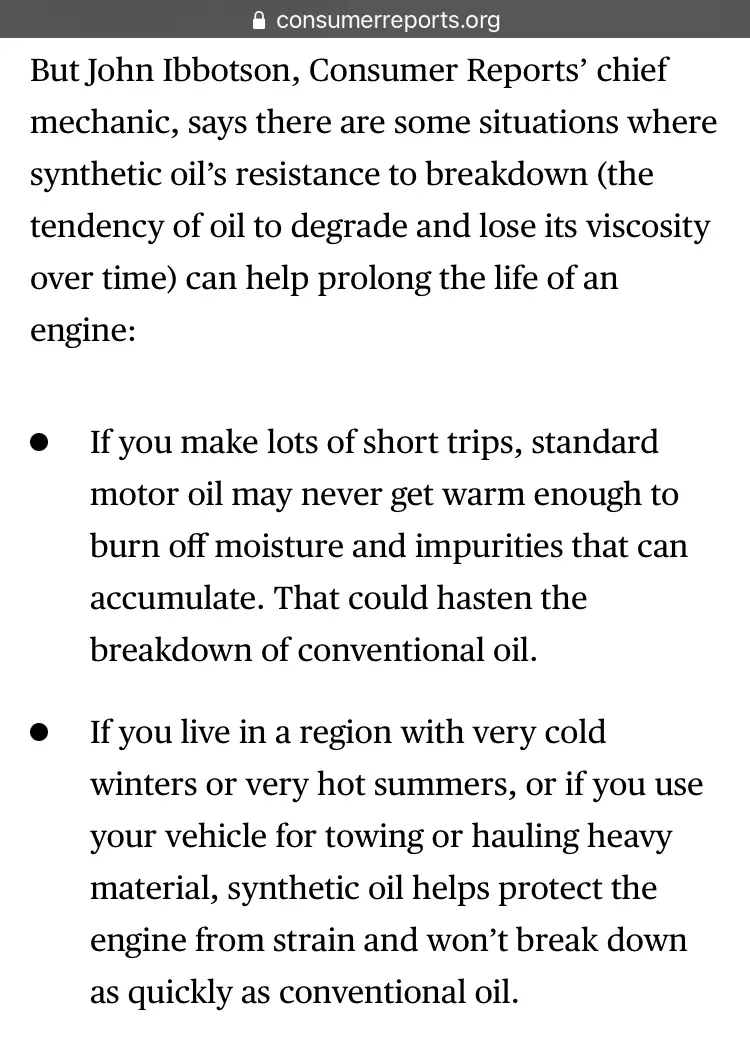

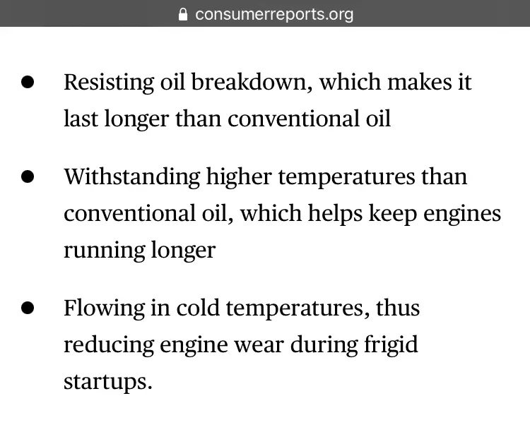

That consumer reports study you mention is way old. Lots have been done since then.
Note, they've changed their tune.

That consumer reports study you mention is way old. Lots have been done since then. View attachment 326754
