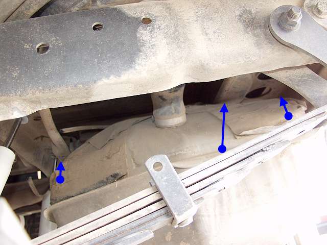

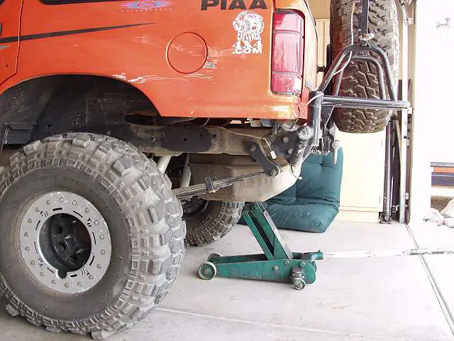

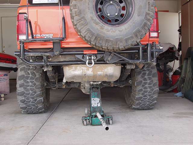

The spacing must be different between the crossmembers. When you raise the tank into position the front (where the pump access hole is) and the rear of the tank come into contact with the frame crossmembers way before the top of the tank comes close to the floor. I'll take a photo for you to see just how low it hangs.

Here's the photos. One other thing... To keep it emissions legal you would need to adapt a vent return line from the filler neck to the tank. They check that in AZ and CA during emissions tests. The B-II tank doesn't have a provision for this.
I already scrape my shackles. This sits another 8" lower than that... no thanks I like my departure angle as is.
