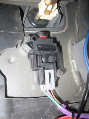

If you aren't hearing that - start with the internal safety switch on the TOP RIGHT of the carpet of passenger side footwell (@imp remembered that detail - I always forget about that damn switch)! Many have reported it "trip" for no explicable reason - so make sure you check this as suggested.
PIC of the switch BELOW

Thank you so much for the reply and the picture! definitely will be checking out these things this coming weekend for sure. Ill post back! thank you man!
No prob - all credit goes to @imp for 1st bringing it up, I always forget about it.
Regarding Switch Location: More than likely you will have to peel back the carpet on the upper right hand side of the passenger side footwell to see the switch.

Gentleman! this morning i was able to try some of these steps. I looked at the switch on the passenger floor with the red plunger. It is in the all the way down position. I checked the fuses with a fuse diagram and none of the fuses or relays appear broken however the #5 50A ignition switch starter relay is a little cloudy on the tabs... Could this mean it wont work because i thought that they were good unless the connection is visibly broken? after checking the fuel pump #9 20A fuse it appears unbroken but slightly clouded on the connectors. The fuel pump relay looked good on all of its prongs. So i connected the battery and cranked a bit. I think this time i heard the fuel pump come on when i turned the key however after a few cranks it would not start. so i followed the path and cracked the fuel schrader valve after cranking and it appeared bone dry. Puzzling because i heard a buzz i was not hearing befotre as if the pump did come on however no fuel at the valve.

Well, sounds like you can eliminate the roll over fuel cut off switch - so that's good.
