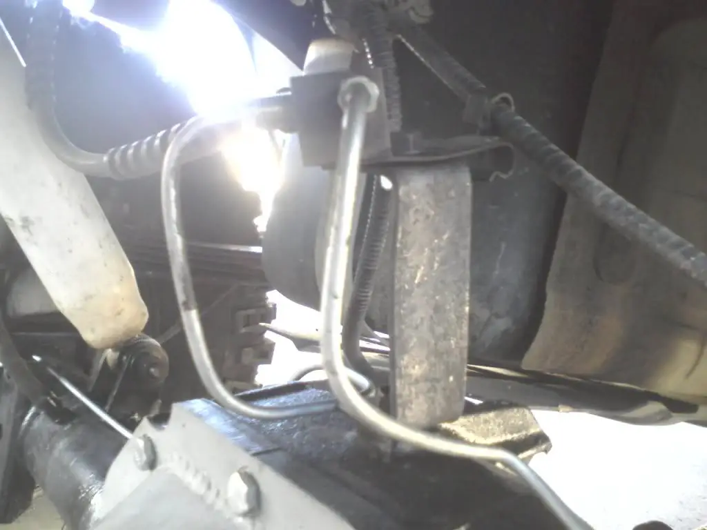

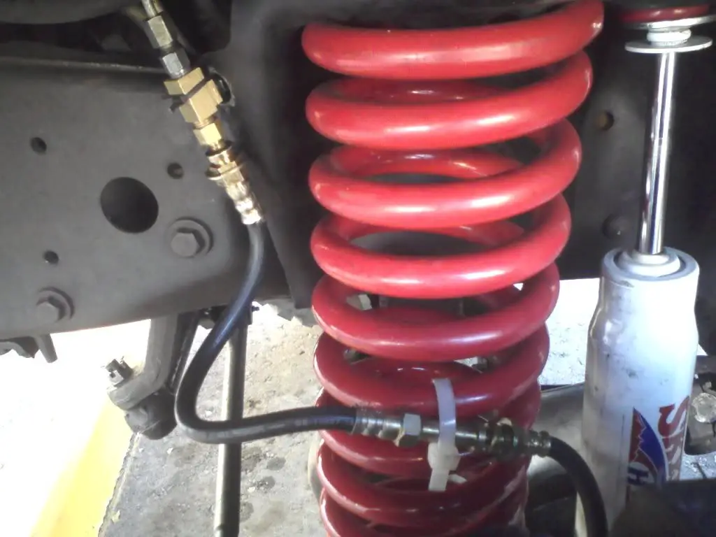

I used 2 piece extended rubber lines
The new lines shown are 'Brakeware' that I bought from Autozone. Their part numbers are listed below you need one of each for both sides. As well as some sort of T fitting for the drivers side as it supplies the passenger line as well.
brakeware 77226
brakeware 88291
here you can see the T fitting used as well as the new 2piece lines..look close and youll see the other line coming from behind the spring bucket
here is my ker####ulated extension for the rear
