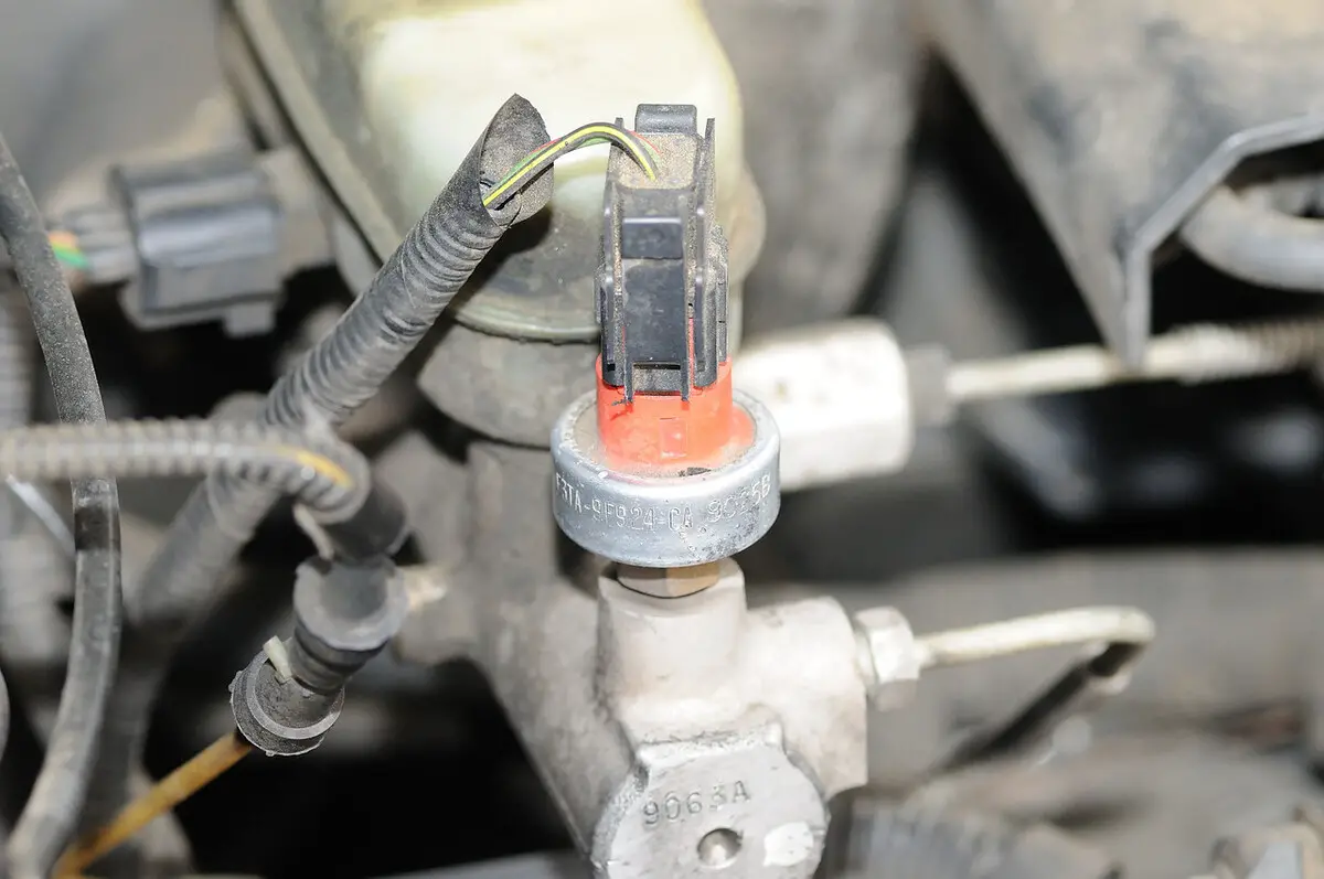

Yes horn works and fuses seem fine??? any ideas Joedirt the prev. owner did hook an electronic trailer brake control up also. there is a fuse coming off the battery hot circuit. is the updates switch screwed into the master cyl. supposed to be black or orange?
orange if original, black if it's been replaced under recall.
