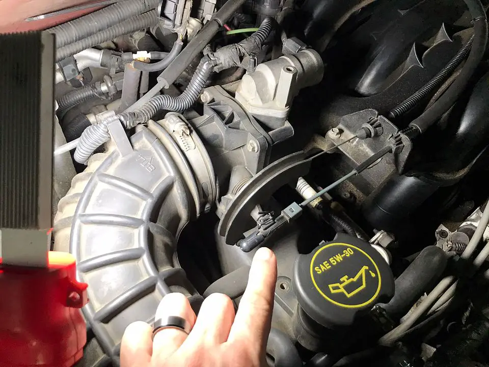

Where exactly is this? My CC is out and I'd dearly love an easy fix. Can you post a pic?

Pic as requested.
Twist tie still working great by the way!
