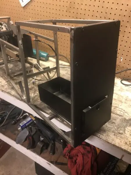

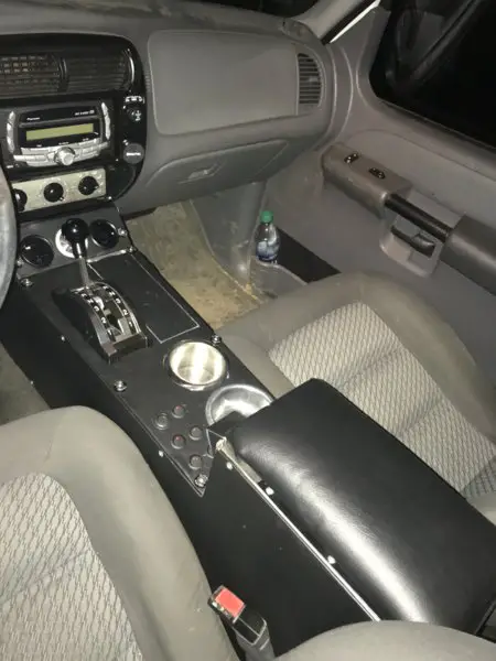

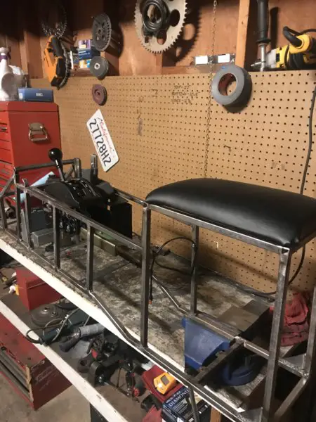

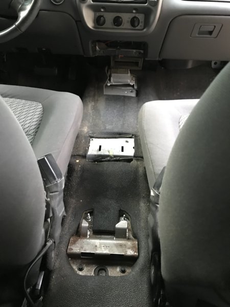

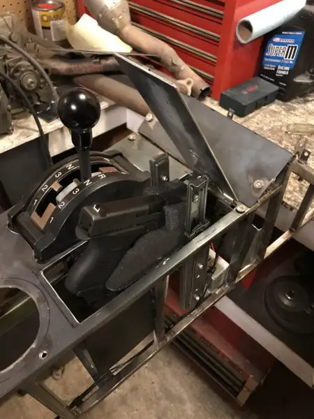

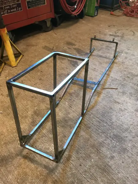

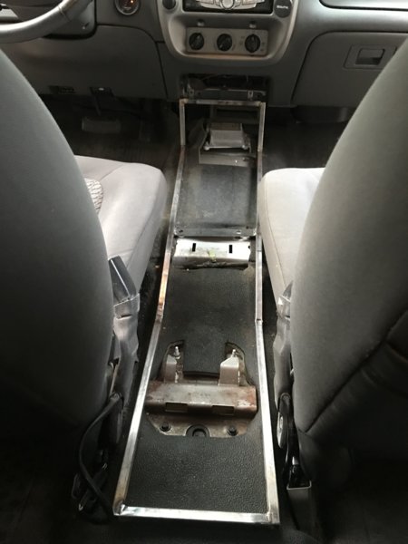

I can’t leave anything stock so of course I built a center console with all I wanted on it (gun lovers, pay attention). I removed my entire center console, designed the bottom frame rails to lay with the floor curves and line up to factory console mounting bolts.

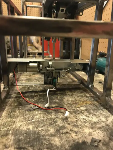

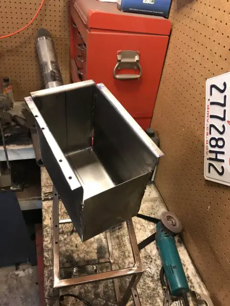

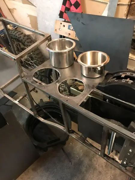

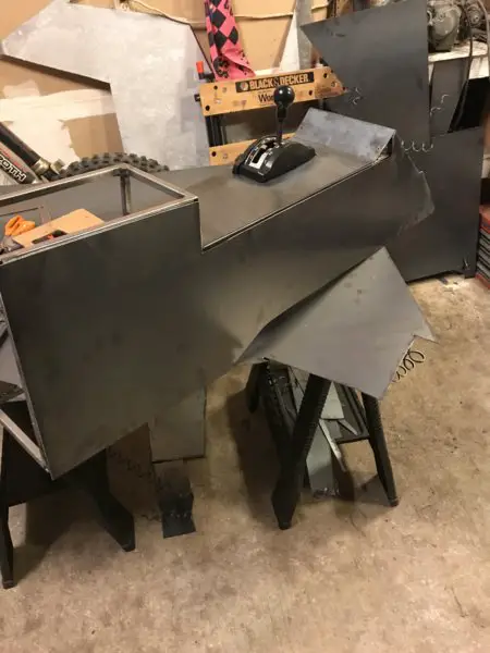

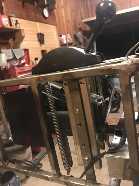

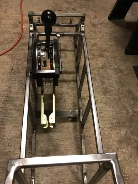

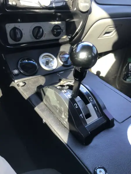

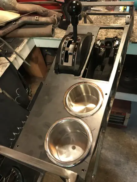

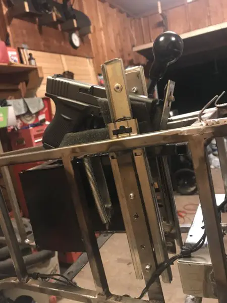

I decided how tall I wanted it to sit, where I wanted the arm rest to be, and where to place the shifter and accessories. I mounted a winters shifter (i wrote an entire forum on the shifter alone to show how to get the winters shifter to work with the 5r55e transmission). I built the framing for the console and cut the sheet steel to fit. After mounting the shifter in place, I designed what I call the “Gun-Pop” and wired it up. After most of my time spent on the gun pop, I cut out spots for the cup holders, gauges, switches, and the hidden button for the gun pop, and where the ignition button would go (not installed yet).
Worst part of the build for me was upholstery... wrapping steel sucks because other than headliner adhesive, I could only use rivets in certain places to hold it all in, while some surfaces I could only rely on glue.. after all said and done and installed, I LOVE it! Here’s the photos I have, enjoy!
