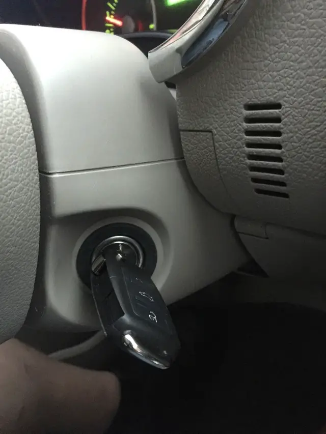

Got my flip key in the mail, don't have it cut yet, but programmed the fob to work in about 30 seconds.
I ordered one (that of course said 06-10 Explorer) but the one I ordered has buttons that resemble our remote fob. I was under the assumption that I put my fob's innards inside this key, so I'm using the OEM fob basically, but when it came I was surprised to find out it's just designed to look like that, and is its own remote.
Opened my drivers door, key on/off 8 times while leaving it in RUN on the 8th cycle, the locks confirmed programming mode, I hit lock and it worked. Heading out now to get it cut and cloned (I don't have a second key, yet) and will post back the results and more info about the one I ordered.

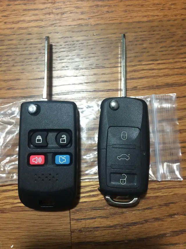

So - Just out of curiosity since I ordered my girlfriend one as well, but the better looking one that looks like the VW style, I tried programming that remote to my Explorer since everybody said it will not work... It worked just fine!
Here are the two fobs I bought. As you can see, the bigger ones buttons resemble our remote fobs, which is why I thought we put our actual remote inside of it.
I paid about $16 for each of them. Different seller, but same shipping area so it may be the same place shipping them with a different name. The remote on the right has a panic button as well, but its on the side. That fob also has an LED indicator when you press a button which is a nice feature. Overall, that one is my favorite, smaller, feels a bit more weighted (in a good way) and the buttons are alot nicer.
Problem is, NOBODY WILL CUT THEM FOR ME!
Walmart: I asked if they clone or program car keys, since they have a whole rack of transponder keys, kid looked at me like I spoke Chinese. "Uhhhh whuuut?" I said, do you cut/copy car keys? "Uhhh no."
Across to Lowe's: Oh we dont touch those chipped keys, only non-chipped. I said thats fine, cant you just cut it for me though? Oh we dont have that machine, some Lowe's do, but not us. OK.
Called Ace/Aco Hardware: They only touch keys that you buy from them. Of course.
So now im down to finding a locksmith, there are a couple here in Monroe, BUT perfect enough, they all close at or before 5pm. I usually dont get back in town from work until 5 or later. GREAT!
So, for now, I have two nice extra remotes, lol.
