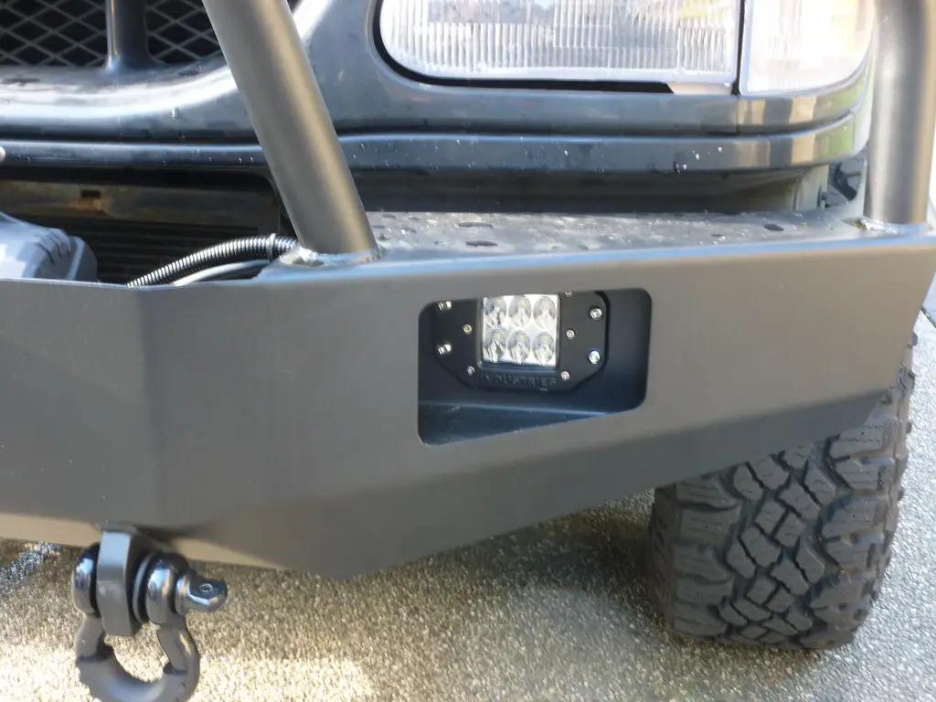

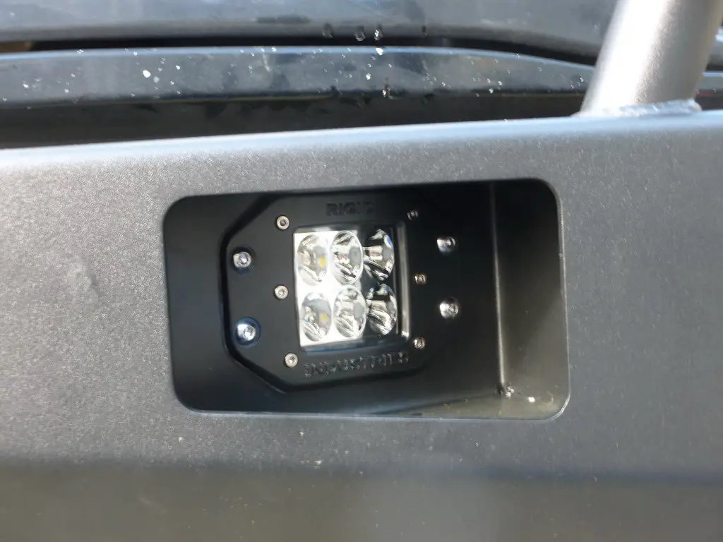

I wanted to use the Rigid flush mount driving lights, and originally planned on using the angled mounts for them to point them straight ahead. James recommended Frenching them in into the bumper instead. I think the final result turned out great.

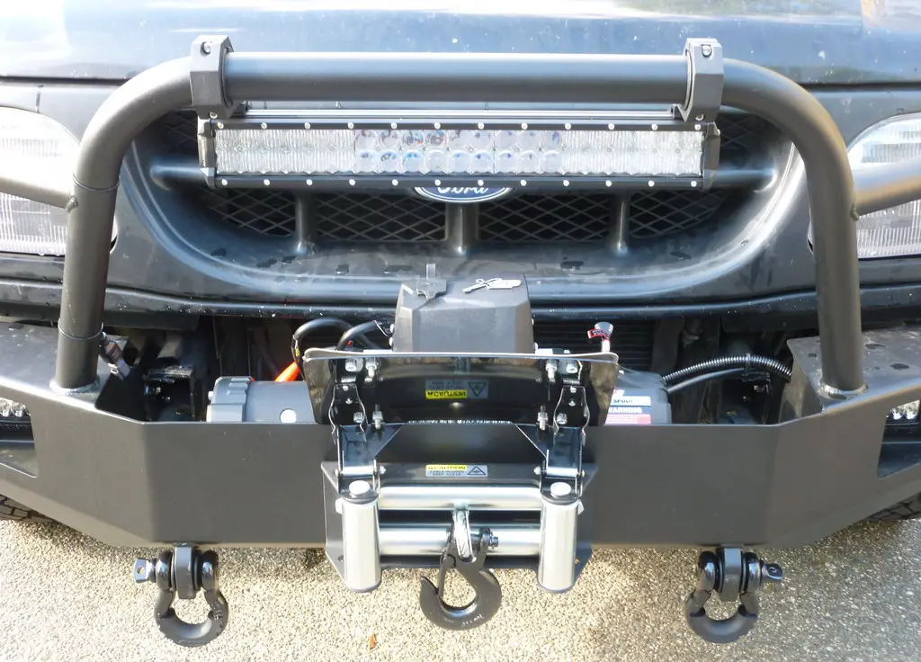

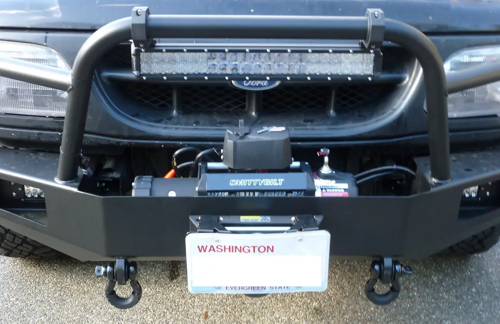

I have a Smitybilt XRC 2 9500.
I like the look of the winch set down in the bumper, almost hidden.
Plus the tray is wide enough, I may be able to mount the solenoid box on the side of the winch out of the way.

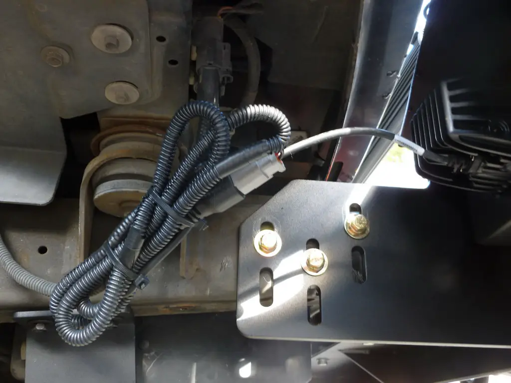

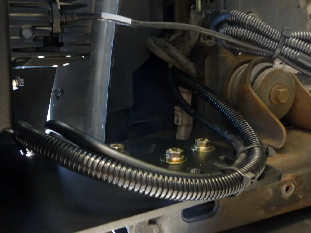

I got the lights installed tonight. I'm using the driving lights. Mini suns, dang these things are bright!

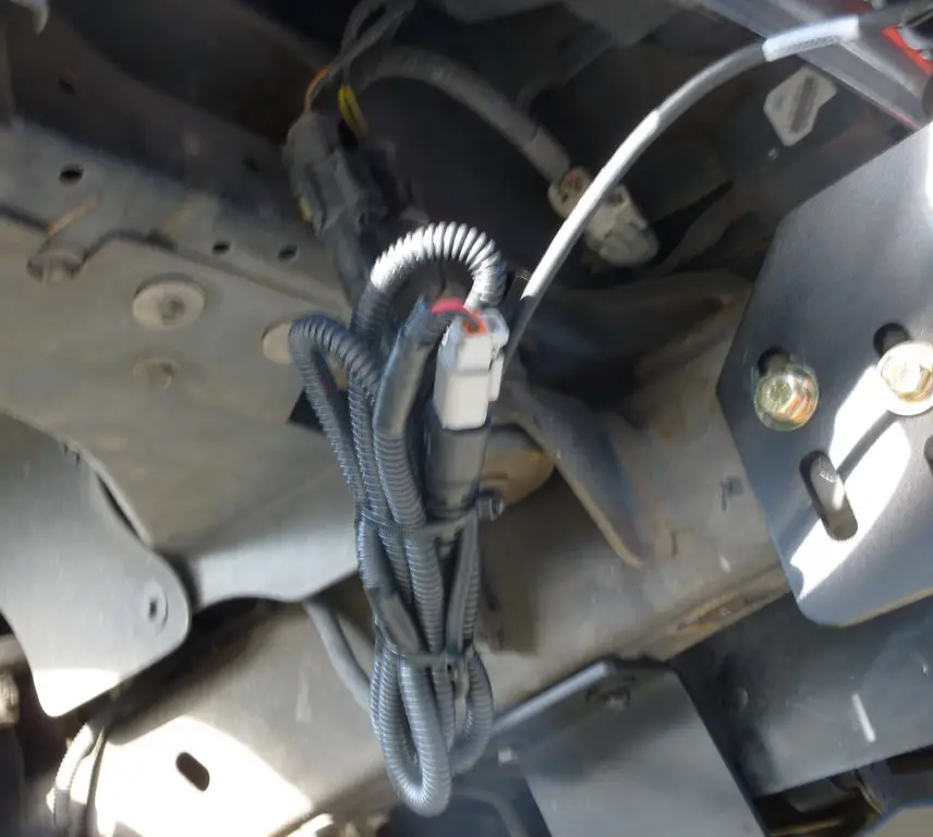

I used the existing fog lamp circuit and made up new pig tails by splicing the original fog lamp connectors with the new Deutsch connector. Same switch and relay.
I'll eventually have a 20" bar over the winch under the center bar.

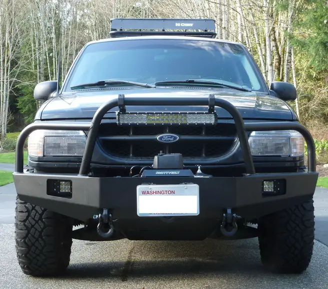

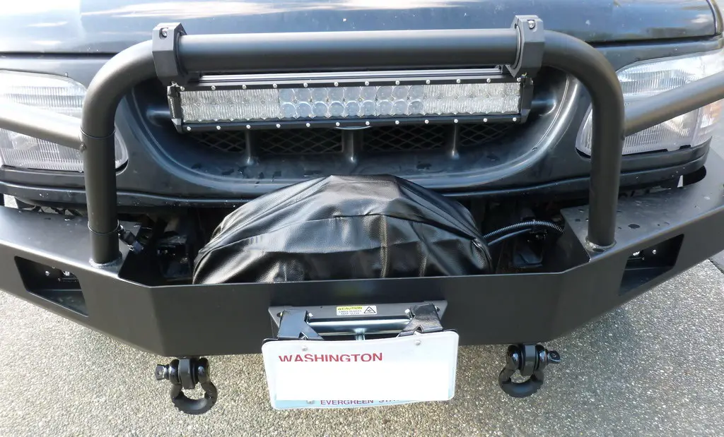

I got the lights and winch mounted.
Did a pretensioning run on the winch, works great.
I have a relay box and a switch group for the lights I need to install, so for now the center bar is inop.
I did a test with it temporarily wired up and it fills in the driving lights perfectly.

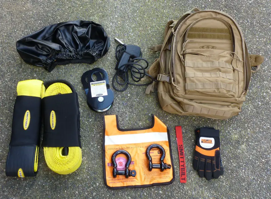

The last pic is a recovery kit my wife got my for my birthday.
It needs a bath!

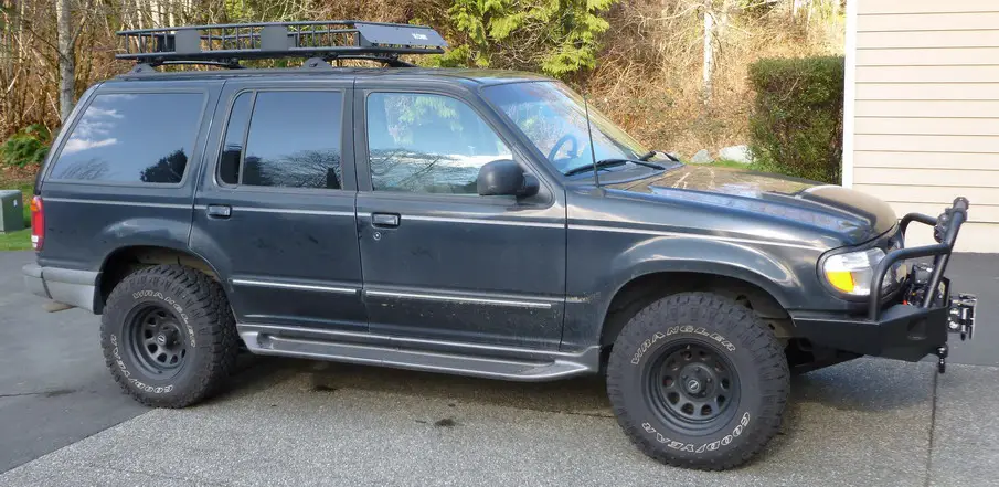

I bought it new in 1998.
I've been refreshing and renewing it since last winter.
I was concerned the recessed lights would block some of the throw, but they don't seem to.
I was originally thinking a set of floods and a set of driving lights, but the CAD mockups he made looked too cramped, so I went with the single pair.
I'm glad I did.
What's the diam of the tubing & did RLC make them as well? What brand of light bar brackets & light bar are you using?
The tubing is 1.75". Yes RLC fabricated It as well.
The two pics with it in the white were texted to me by RLC during the process.
It's welded to the bumper so it came as a single piece.
The lights in the bumper cutouts are Rigid Industries Flush (D Series I think).
I went cheaper on the 21" bar. It's an Auxbeam 5D Cree unit.
It has a center spot and side flood lenses.
The brackets I grabbed off of Amazon.
They're "House Tuning" brand which is a Chinese knock off company.
They actually have reasonable quality.
The brackets are aluminum 2 piece with a rubber insert inside.
https://www.amazon.com/gp/product/B075QKLJVT/ref=oh_aui_detailpage_o04_s00?ie=UTF8&psc=1
