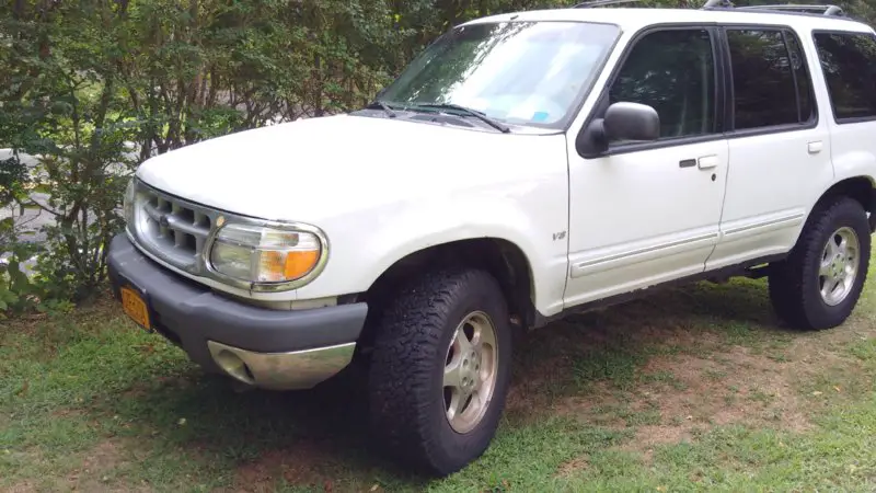

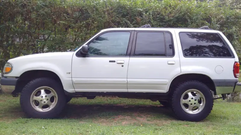

Some photos of the rig here:

Thanks. I cleaned it up a decent amount when I picked it up 3 years and 30k miles ago. Was just thinking if I am keeping it I should start considering more preventative rust maintenance.
