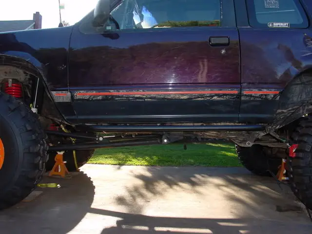

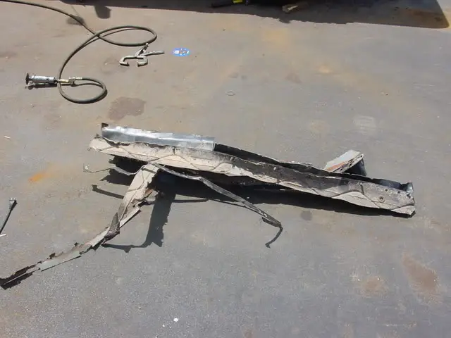

A different view of the cut rocker.
Sliders on.

Not sure what you mean... I cut mine off much the same way Firezapper did (I used a sawzall with a fine-tooth blade for a good clean cut), although on mine there was a small gap that opened up for a few inches just in front of the rear wheelwell where I had to cut a pinched seam off between the exterior side panel and the floorboard (not sure if the Ex is the same structurally in that spot), so I just filled it with that expanding foam stuff, then trimmed it so it was flush underneath, sprayed it with flat primer and left it at that.
Here's a couple pics showing mine (sliders made of 2x3" tube, capped at the ends, if that's what you meant):

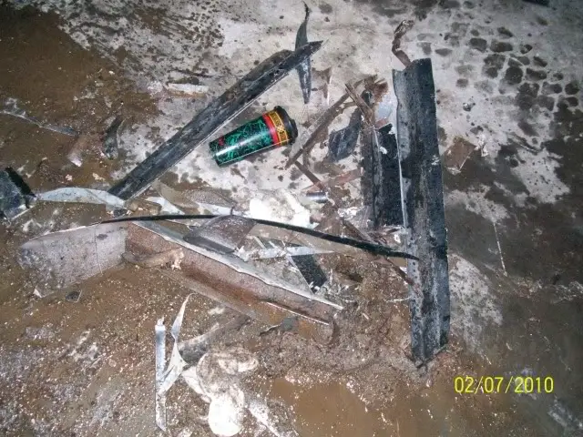

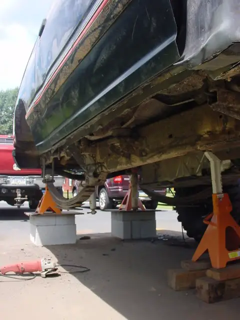

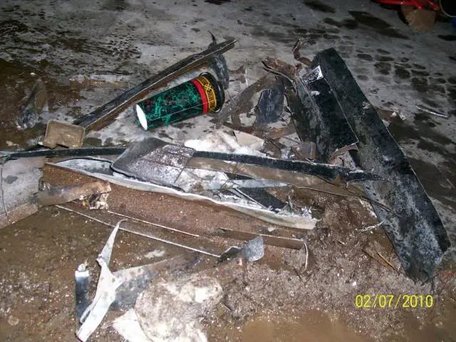

ok so they are officially GONE now... not too bad, an hour or two and a couple 9" bi metal blades... it only slowed down when i hit a BUNCH of bondo from a previous owner, like 1/4" thick bondo.
some pics
the hole junkie is talkin about

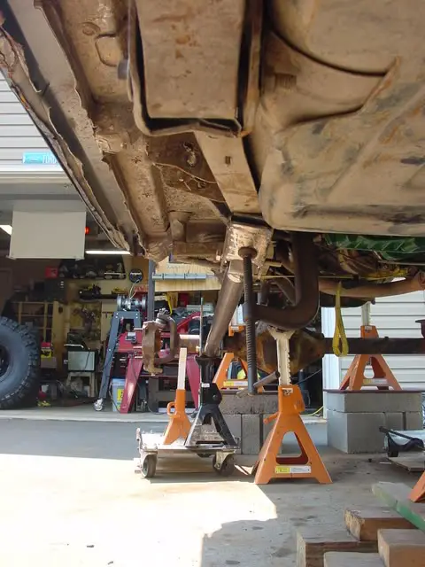

i chose not to cut my fenders yet. my sliders are just long enough to fit in the main body part. i may cut them later and make a L bracket to mount the fender to.
cut the quarters too
the final result
can you get a pic from underneath where you cut the rear quarter?
I cut my quaters and made the bumper wrap around. Protects the rear pretty good:thumbsup:
