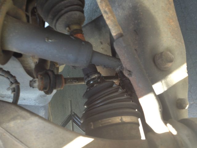

some pictures
please let me know what you guys think :-)
sorry better sized
Well i can tell you right off the bat you need new upper ball joints. Basically entirely new upper control arms actually (unless you really want to press them out - but considering how beat up the control arms are you may as well kill two birds with one stone)
It also looks like your CV boots are leaking grease, which means they need to be looked at, cleaned, repacked, resealed, etc. (unless they're damaged, which means new ones).
Feel those brake rotors - if they're heavily grooved while running your finger against them, it's time for new disks (and probably pads).
I wouldn't bother doing anything with the cv boots it's more economical to go with a new cv shaft they only cost around $70 or so.

Entirely valid point.
