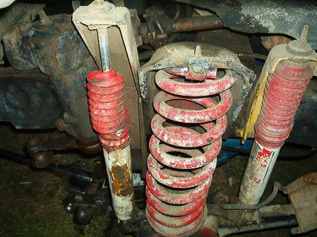

The truck has a 4" suspension lift, I have some concerns that the coil springs will be to stiff. I don't know who the manufacture of the lift is, I got a chance last month to weigh my explorer when it was loaded with my normal trail gear and 4 adults = 6,100 pounds so those springs might work.
I have been looking at some 5.5" progressive springs from cage automotive, I can get them $122 shipped so if I need new springs that is probably the route I will go.

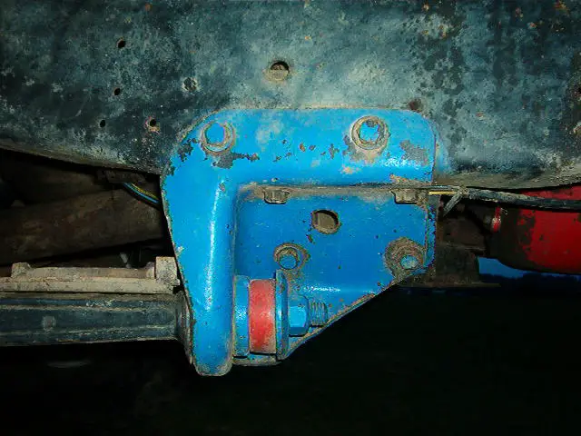

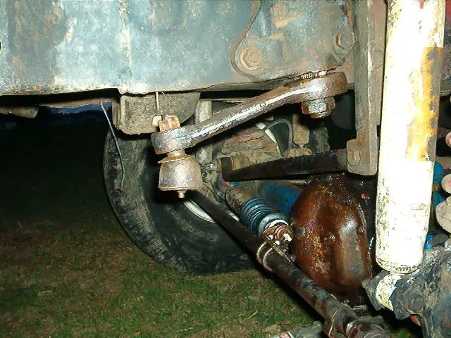

It looks like alot of this swap will be bolt on. radius arm brackets, coil buckets and trac bar mount. I may end up buying a adjustable trac bar and some tube and rod ends for the drag link, I haven't measured to see I can make the factory parts work.
These photos show how the 78-79 ford's front suspension looks the oil on the front diff is from the power steering pump.

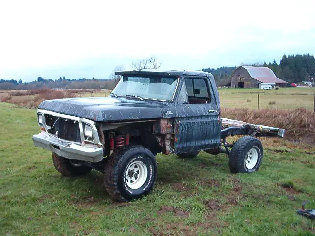

I had a kid come up to tonight when I got home from work wanting to know if i wanted to sell my truck, so after I told him the engine, transmision and transfer case was already sold and I was taking all the suspension off and all there would be left is the cab and frame, he still wanted it so I told him I would give it to him if he would haul it off. :D
I don't know what he was thinking, this is not a pretty truck

Actually, it doesnt look any worse than the 78 model i picked up for parts. Bed rotted out, 4 different wheels/tires, and painted brush on black and white camo and zebra stripes. We've been calling it the Ted Nugent truck. :p I gave it to a friend who (i guess) collects junk since i basically took everything running gear related off of it.
