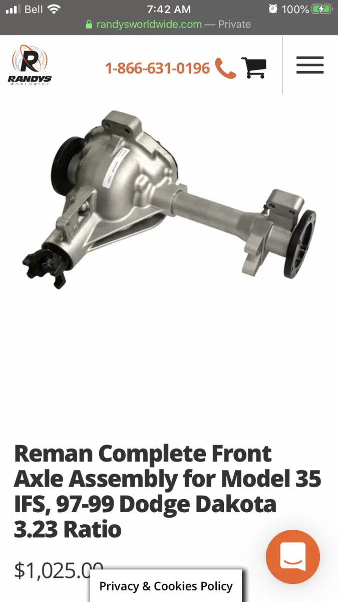

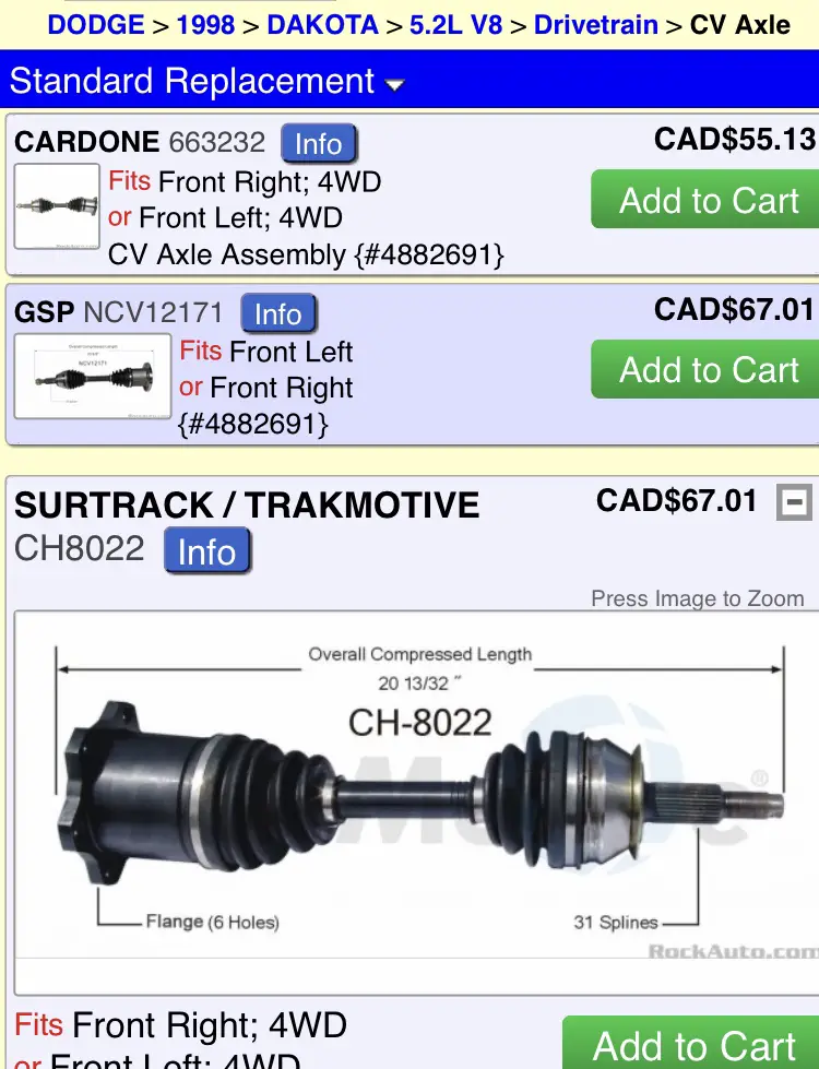

So I noticed that 1997-2000 Dakotas and Durango’s also came with an IFS Dana 35 and that they have a track with that is 3.3” wider than a ranger. However, I can’t find any information specifically on how long the axles are or any details on inboard stubs or outboard splines and dust seals.

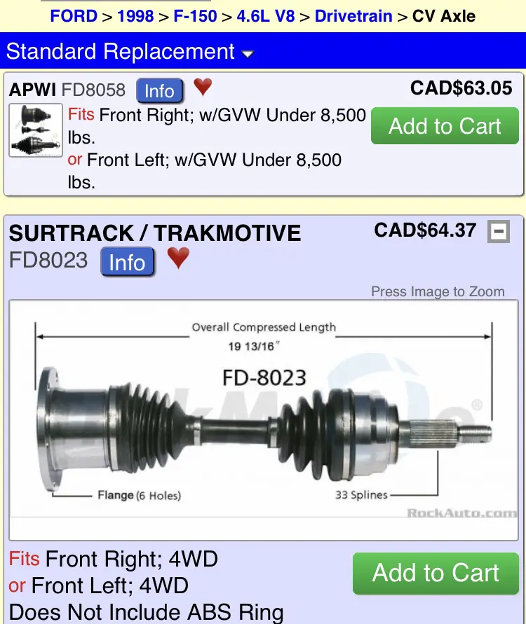

Or is there another possible donor? 1998 f150? chev ifs?
Even if you had to swap stubs and find a reasonable length that would not require “custom” fabrication for the axle that could save a lot of up front cost on a kit ... as well as replacement axle costs.

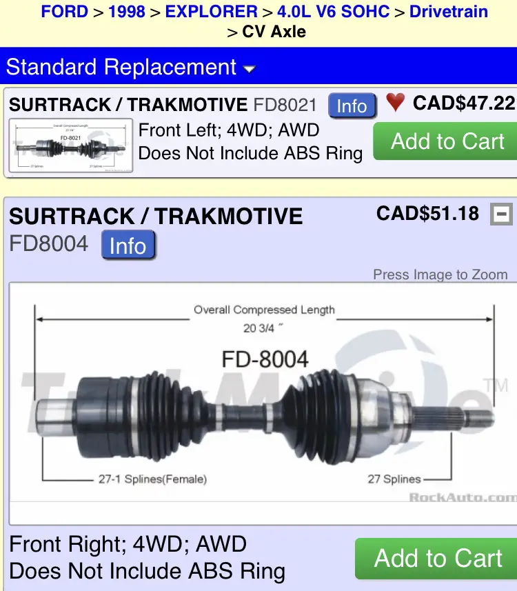

Courtesy or RA the Dakota axles have an inboard flange rather than a stub on the explorer. And the outboard stub and spline count is different. The flange is the more common configuration, I thought maybe it was a D35 IFS thing and the Dakota axles would be similar ...

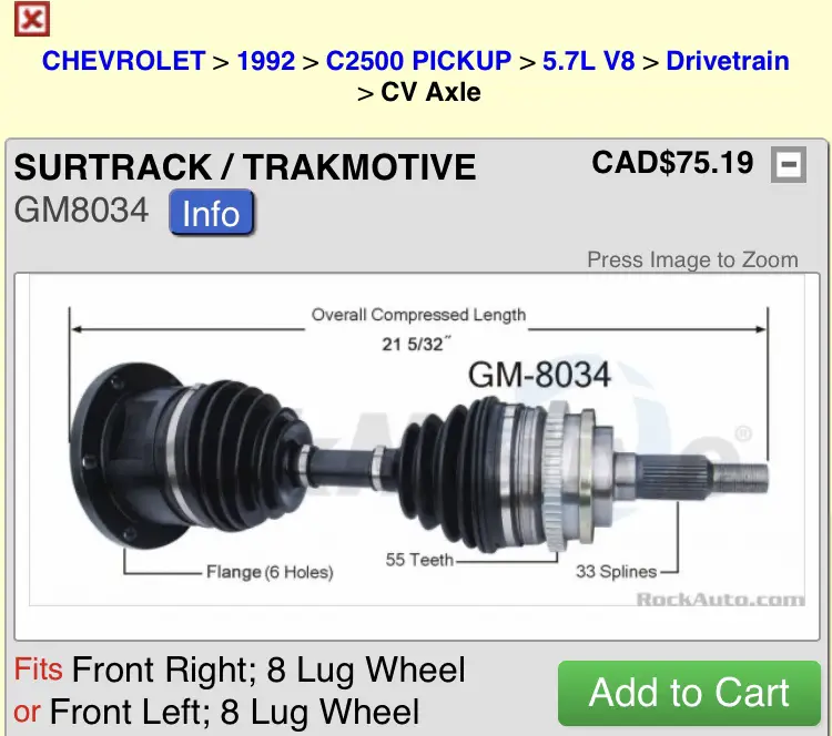

Plan B is to find “axles” of a good length and then swap the stock inner and outer joints on.
I like how Factory Five takes this approach with the 818 kit rather than selling complete axles.
Anyone know of a resource to find stock center axle lengths? (The shaft between the joints)

I did turn up the sleeve option while digging around in the desert forums. I am always amazed and humbled by the fabrication skills of others ... far beyond my own. I hoping I can make up for my lack of fabrication skill with catalog and junk yard research.
the shafts should have circlips that engage on the inboard and outboard CV joints. The trick will be sourcing longer OEM axles with the same diameter and spline count.
