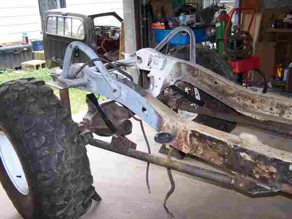

Well I didn't get the 44 :( but I got the 30 in and it looks really good now I just have to put the new trans in(broke the a4ld again this will be my 4th trans) so it's just sitting right now but I'm gonna get new gears 37's and 17 inch wheels I'm liking the 30 for the short time I got it on the road and off lol not too bad I switched out the vaccum to a manual system for the front end it flexes like crazy now
