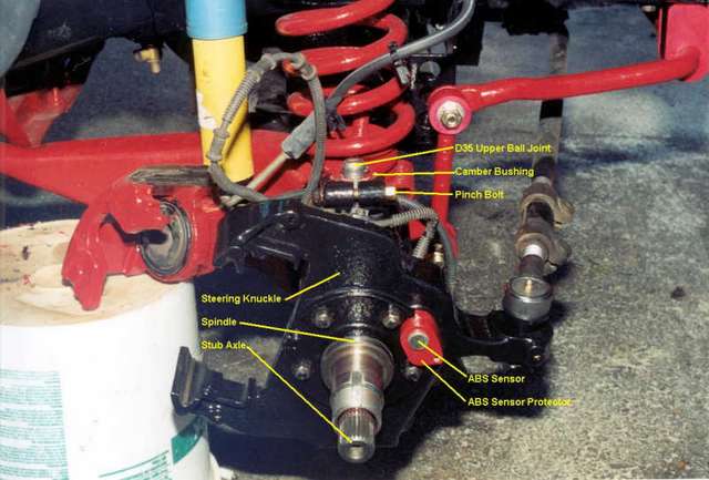

99.8% of all explorers came with the Dana 35 axle.. Its easy to tell a Dana 35 apart from a 28. The dana 35 in the picture below has a smooth upper ball joint that is held in place by a pinch bolt. On a Dana 28 both the upper and lower ball joints are threaded and held in place by a large castle nut.
