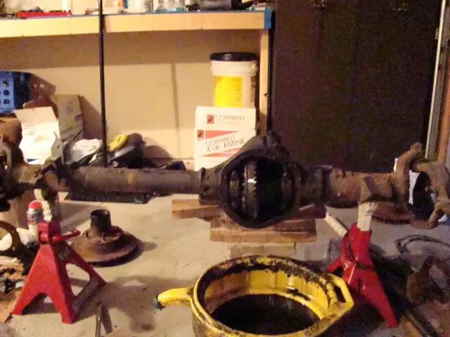

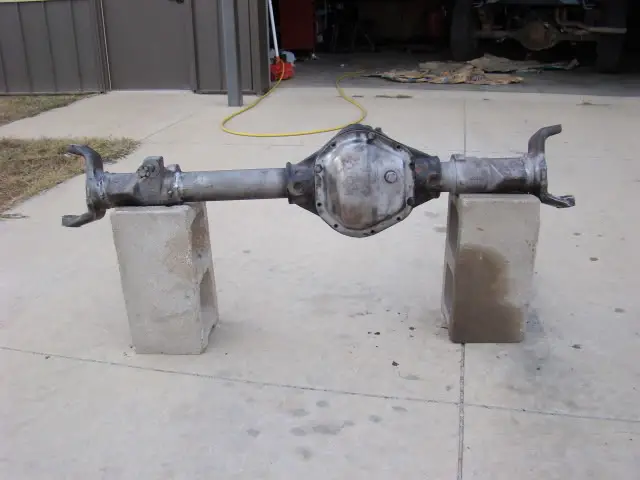

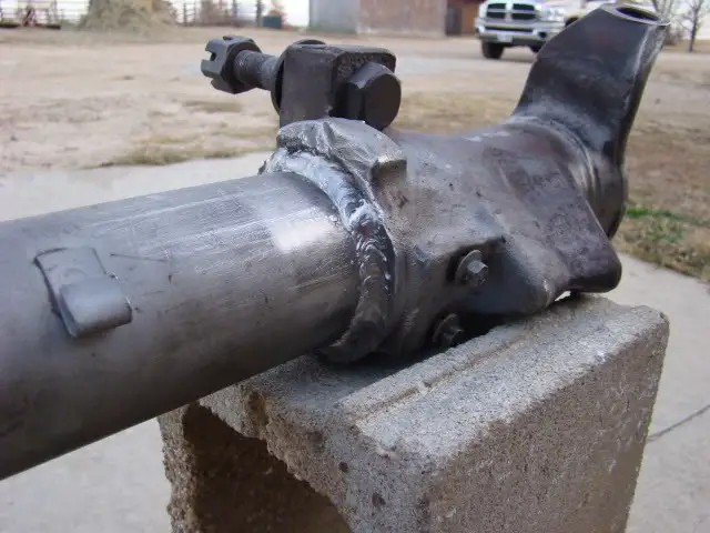

The plans for a hp d44 from a 79 fs bronco :p::
Zip Locker
4.56s
complete rebuild (mostly stock)
Oh...and 6 inches narrower:D

Progress looks awesome, are you going to be able to just run EB shafts with the narrowed width.

I was talking about the axleshafts since he is changing the width.
dkchrist
August 13, 2006
1,338
Fayetteville, AR
93 XLT 4DR
Yup, the plan is aftermarket Spicer shafts (760x) u-joint. As for the d-shaft it may bolt up but might end up being too short.

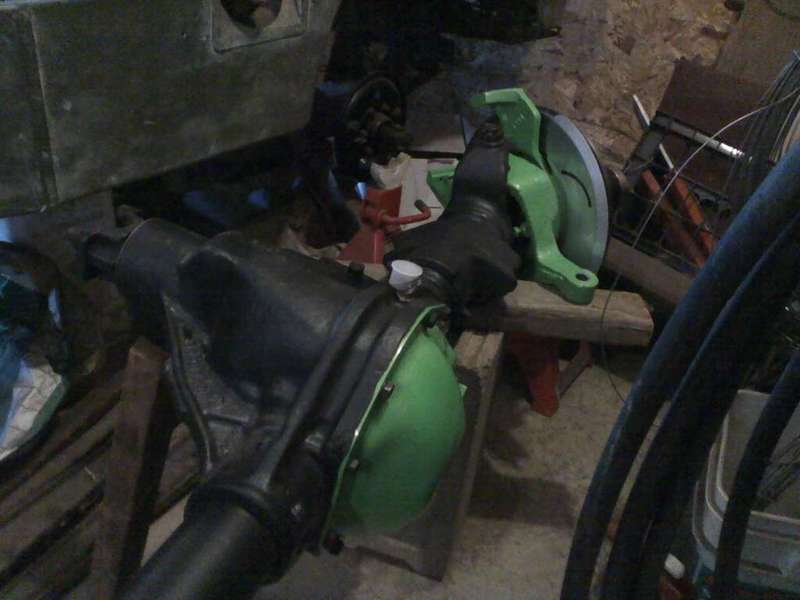

More Progress. New bearings, air locker, new brakes, warn premiums, and a little custom color. Now waiting to start towards the end of the month.

Looks to be coming along nicely!!!
Is it worth having the dust shields on? Mine used to get clogged with mud and it was a pain to clean, so I took them off if I remember correctly.

That is going to work nicely under your Ranger. Pictures can't get the true tone of the green, but it is going to look sick with the dark blue
The EB shaft was perfect 6 in. off the long side.
This truck doesn't really see any mud unless it prevents me from getting to a rock garden. So I am not too worried about the dust covers.
The green looks rocking on the axle. I took those with a cell phone. :rolleyes:
