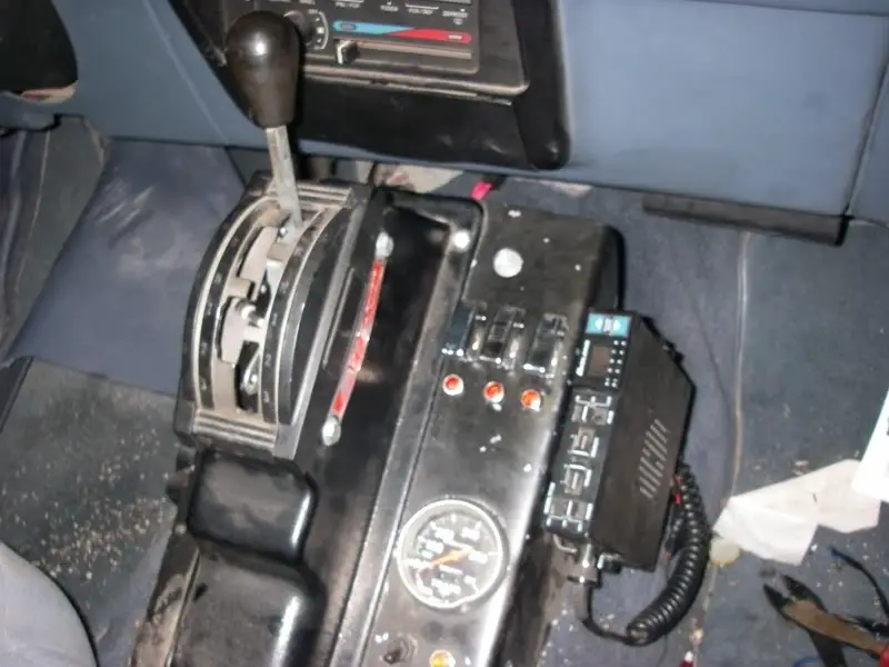

C5 3 speed built by Mogi Enterprises with all C4 internals
reverse valve bodied (an auto but you need to manually shift)
Art Carr shifter
B&M tranny pan

Stock pushbutton transfer case (button in a not-so-stock dash)

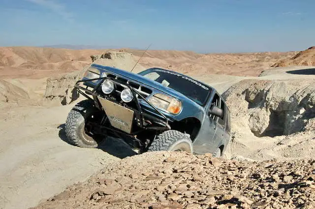

Dana 35 TTB, AutoFab kit (the $3600 kit before shocks!!!) inlcudes extended radius arms, tranny crossmember, triple shock mount (1 behind, 2 in front) currently running Rancho 5000s but 3 of them keep it in control
16" of wheel travel approx 6" of raised height over stock

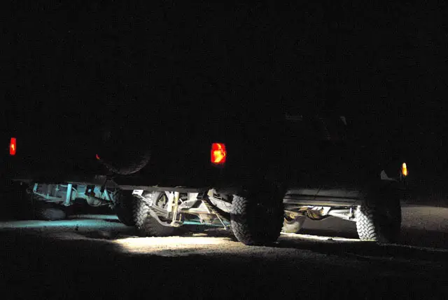

4 rocklights mounted 2' behind each wheel
