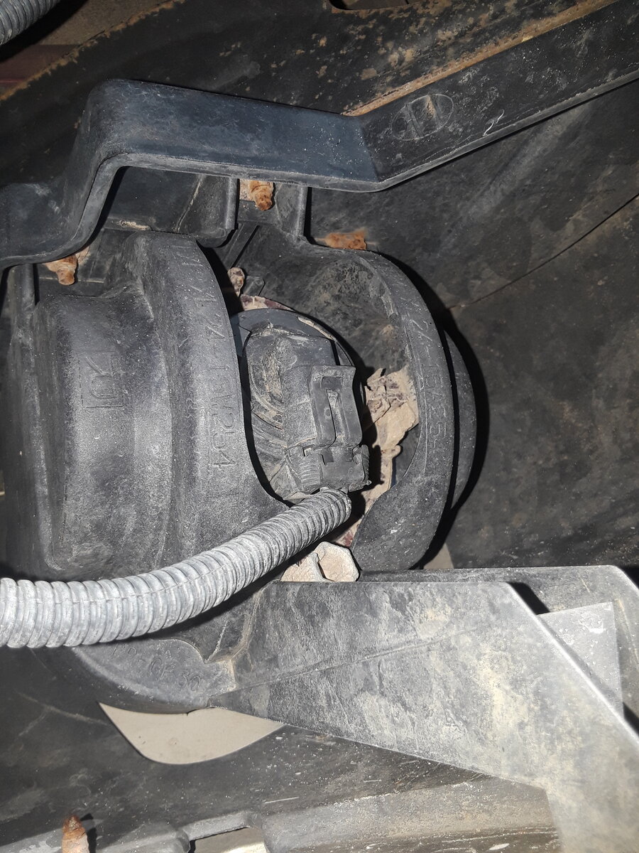

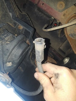

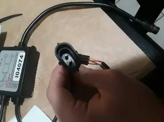

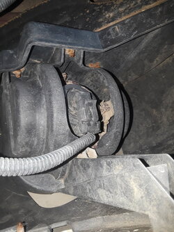

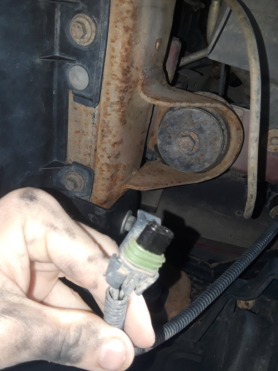

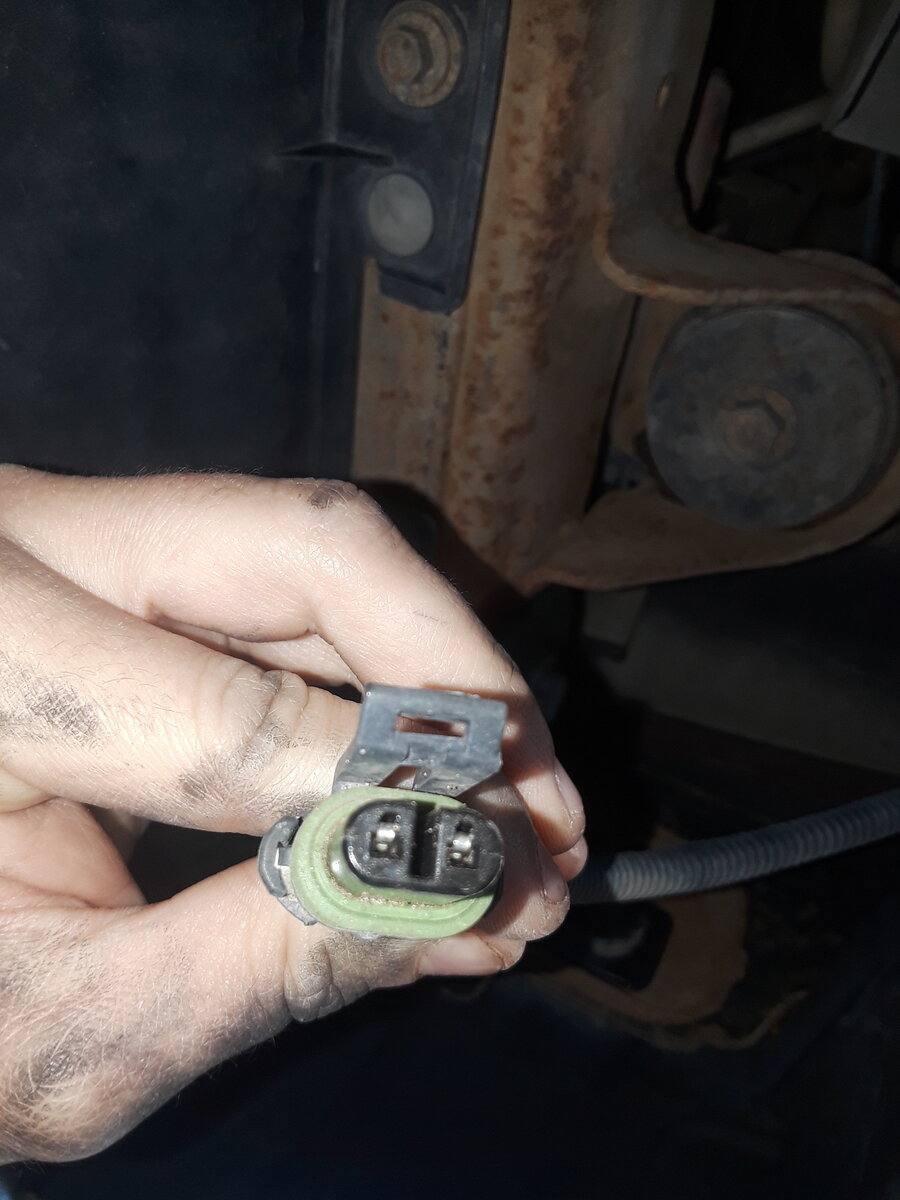

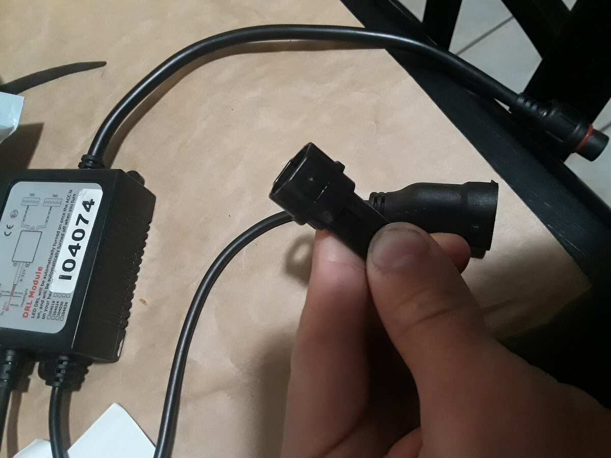

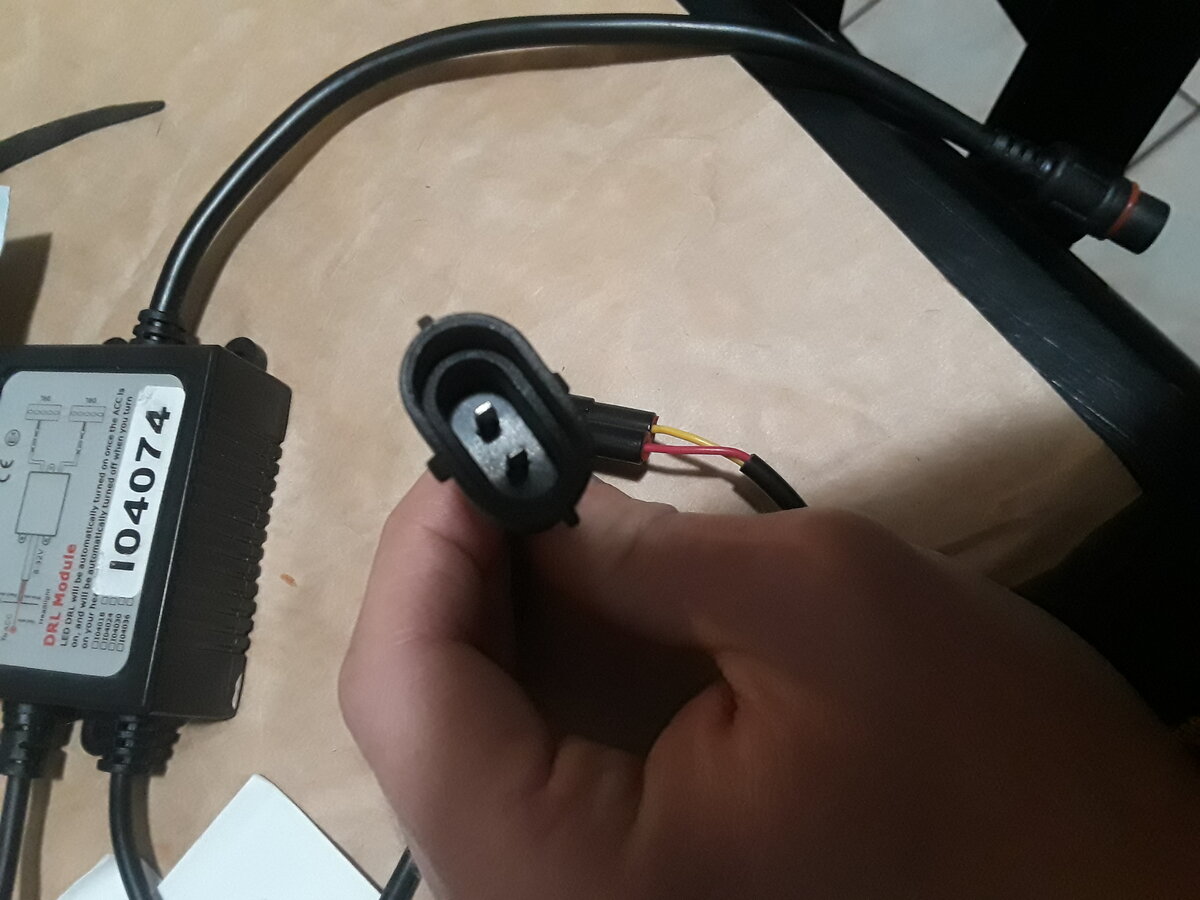

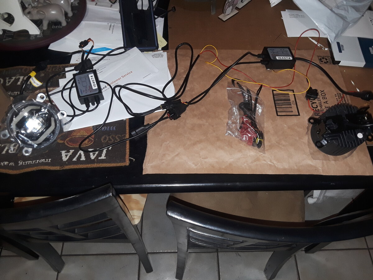

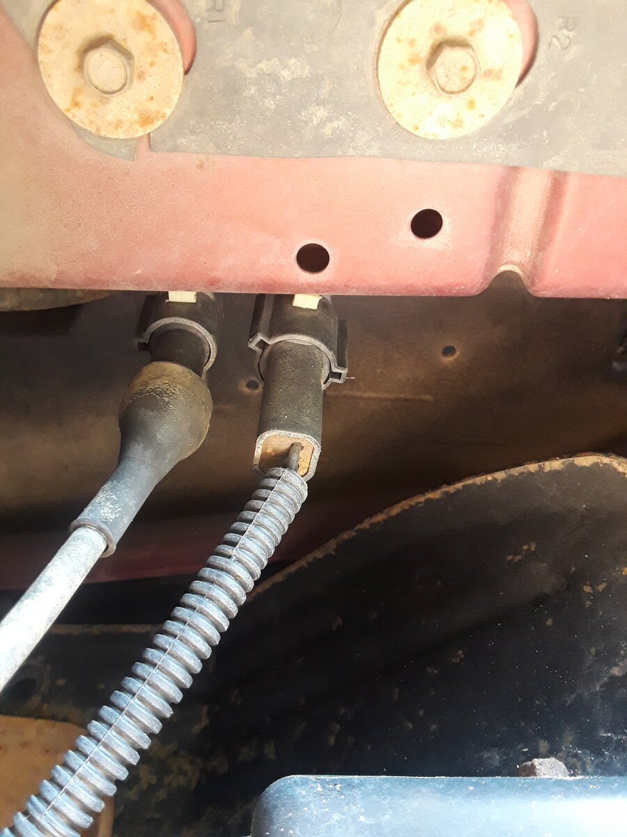

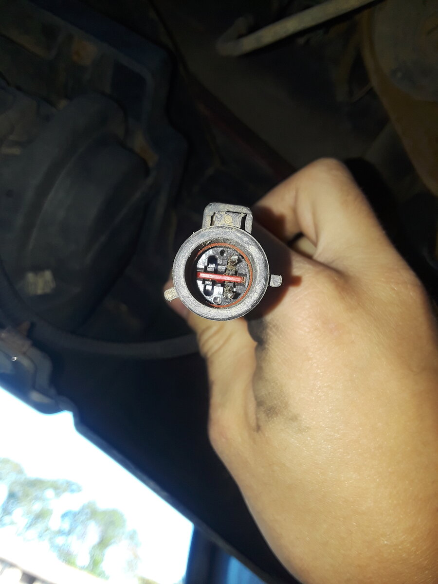

Okay, getting back on top of A LOT of projects that have been put off for too long. Any suggestions for connecting two different pigtails? As mentioned in my foglight thread, they don't fit the oem mounts, which is still causing a bit of a problem that I'm working with, but the pigtails were different too. Thought about trying to just cut them and hardwire it, but that's a difficult task since I think I'd have to manually hook up the daytime running lights on the fogs separately. I'm not finding much on google for connecting different pigtails, so I figured I'd ask before I mess with anything. I can get pictures of the pigtails of each in the morning and send them. The link to the original thread when I first was trying to do this, is in the original post here. That and where do you think would be a good spot to mount about a 1" tall, like 20" long light strip on the front with 3m (possibly some mounts with screws on each end as well for a precaution)? Can't decide between the bumper or the grille guard mainly, debated the grille itself but I don't want it too hidden, besides I'll have the grille lights in there whenever I have those added and on (will have a seperate switch like the visor so I dont always have it on). I'm thinking it would do best right towards the top of the bumper, just going to suck to deal with later on when I try to swap it out for a steel one (as much as I want to, probably won't happen for a year or so, need that rear one though for the spare), or just take the plastic cover off and leave the reinforcement behind it on while keeping the fog light mounts like in the Project Vulture thread.
What do the pigtail connectors look like, and are they OEM? I have added a ton of OEM connectors in my 99 Explorer for many added circuits I installed. I love the OEM connectors of the late 90's Fords, those are vastly better than older stock connectors. They come in many sizes and varying numbers of wires. The ones outside all have seals for the wires to keep out most moisture.
So you would do best with OEM connectors that are found outside of the passenger compartment. There are several kind that have four wires, which may be what you need. Or things like the O2 sensors may have two or four wires depending on years etc. You can use any of those that you find as spares. Then after finding a pair that match, you hard wire the light wires to one connector, and the vehicle wires to the other. Then it plugs in and is protected well, unlike trailer wiring for example.

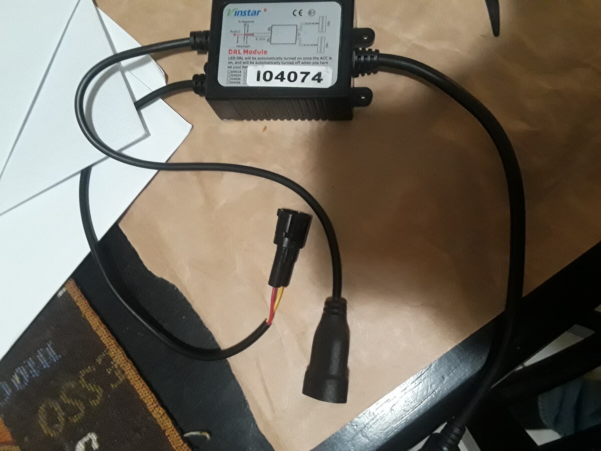

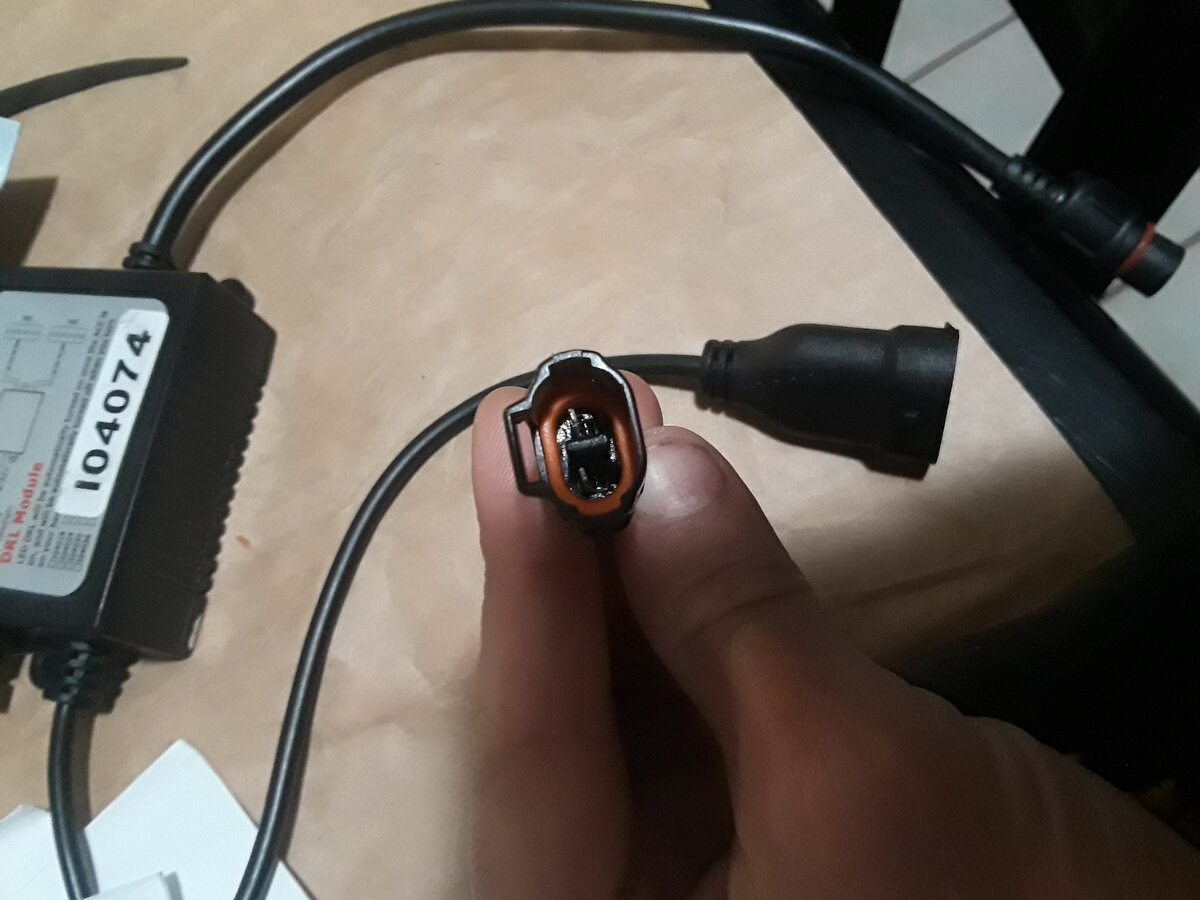

This is what I mean, the connectors between the oem and the aftermarket ones are different styles. The diagram is the start of the new ones. They won't connect to the factory harness, meaning I can't use the foglight switch, which is exactly what I need. The wider connector is the factory harness, the smaller one is for connecting the harness between both fogs for the daytime running lights. Theres a long harness between the two to hook up the daytime running lights via one ground and one positive with an inline fuse with the end connector. Theres also some small extension bits for the "supposed" to attach to the factory harness. Also, tested them, they work when given power. The daytime running lights do not, so we were thinking maybe it's a common ground between them and the fog, so if those aren't ground then it won't come on, but then I'm not sure what the yellow wire is. Unless the yellow is a second positive for connecting a switch, just without a fuse like the other two had, but if that were the case, the red would be useless. I'm started to see why I put this project off again, pita of a project. They came with zero instructions than what's shown on that diagram which is backwards on the box

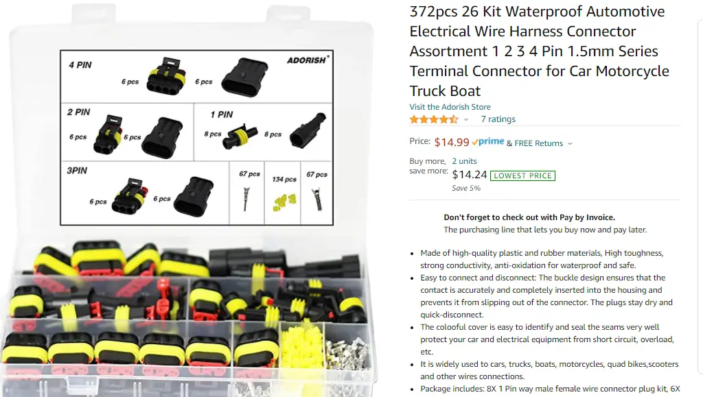

You might consider making your own. I use this kit from Amazon. Works amazing, and looks much like the OEM style. Get the tool for crimping as a kit.
Honestly at that point, may just hardwire my oem connector to the the new one if I'm going to that extent. I'm sure it'll fit that way

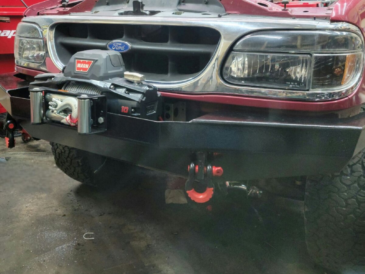

There's a guy that makes front/rear bumpers for the 2nd Gen Explorers, probably can for about any generation. I just finished mine last weekend.
Here's a peek at her, more to come ;)
I know RLC does, a few others they're more expensive than rlc is. So I'll probably go that route and spend 2k versus 4k for both bumpers.
Understood, and yes it will. Just use heat shrink butt connectors.
That kit is great for adding in other items, works great and looks stock.

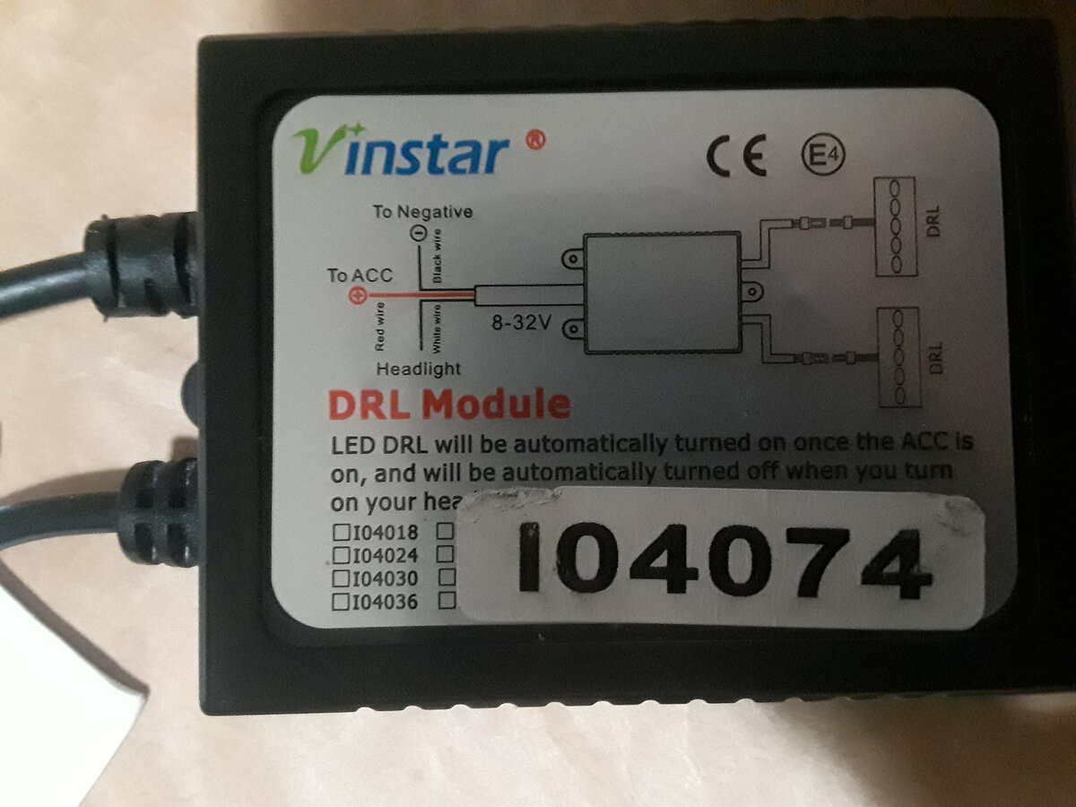

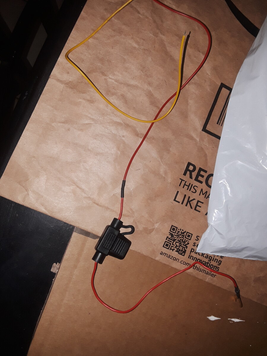

Cannot figure out the DRLs to save my life. Thought maybe the yellow is a switched ground, tried that and nothing still, the fogs work, DRLs we're at a loss for.
RLC made this one. Not a straight bolt-on, gotta cut/drill the frame ends, but not bad.
Yeah, but I'm cheap and can hardwire it for free 😂
