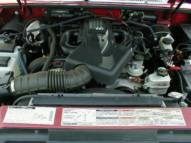

huh the more you know!!! i thought moddbox said their kit was only for the pretzels... hmm...
Scroll down the page
it says pretzel here, or are there different variations in kits?
From the link
Any engine that looks like the following photo is compatible. We have confirmed that our kit is compatible and several of our customers have already installed our product successfully. You will require a throttle body off a Ford Ranger (4.0L 2002-2011). We do not advertise this compatibility, however, we have all the parts instock and we can set them up for you. This setup can be found on various Gen II Explorer models between 1997-2003.
I'll maybe do that eventually! But sadly not any time soon with the price for it! For now I'll stick with the exhaust and cai swap for a little power add. But I will almost bet that I'll go that route over a 5.0 swap, at least for a while, especially if I can make my exhaust sound real nice with this motor. I do appreciate all the information and advice y'all have been giving! I'll nab a pic tomorrow, but anyone else ever thrown a small boat on the roof? It's about the size of the roof basket, had it since I was a kid and figured I can make use of it on the trip, secured and ready!
From the link
whoops, i stand corrected ;)
