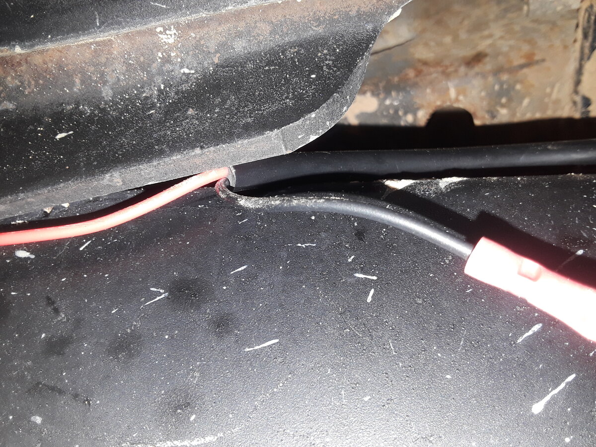

Let yet another project begin! At least this is halfway done (pictures were from the beginning), just need to run the wires up to the battery, but they're already hooked to eachother and to the reverse. Should have 'em done either tonight or in the morning.
Okay, need some quick help. Wired them up and nothing. Hooked to the black and red reverse wire, connected to (according to the instructions) the correct number on the block. Connected both lights positives together and quick spliced them to the block. Took the passenger light negative to it's own bumper bolt. The driver light negative quick spliced to the blocks negative wire grounded to a bumper bolt. The final wire runs along the frame, up to the fuse block with currently a 20 amp fuse. Why the heck ain't they on? The reverse comes on just fine, supposed to trigger them too. Y'all see anything I don't?
Edit: swapped the connections off of the block to a switch. Still no lights but the switch itself lights up, so power from the fuse block is fine at leas
20220115_085436.jpg 20220115_085448.jpg 20220115_085457.jpg 20220115_085403.jpg 20220115_085340.jpg 20220115_085315.jpg 20220115_083342.jpg 20220115_085051.jpg PicsArt_01-15-09.08.02.jpg PicsArt_01-15-09.12.01.jpg 20220115_094625.jpg

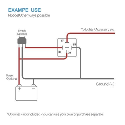

Typical relay wiring

Remove all of those wire cutting connectors, those leave bare wire exposed to the elements(rain, water), which makes shorts and/or waste juice. Those should never be used outside, or in high current circuits, or for permanent use. I don't own any of those, I toss them like cork gaskets, they're terrible.
As said, just wanted make sure they were up and running, I'm going to clean them up and actually solder them together later. The wire running to the battery is in a tube and should be fine, need to get some more tubing for it. Plenty of zip ties, electrical tape and tubing.
