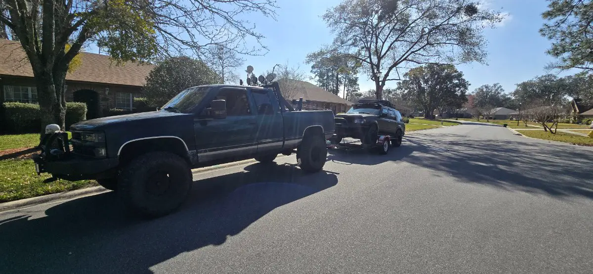

Well, even having tranny issues of its own, the rado ceases to disappoint. Sad saying this is the fourth time that poor explorer has had to be towed somewhere. But she's home, now I just gotta crank her from time to time and wait on parts to come in. Anything yall recommend checking or doing while waiting? May do the brakes too, I can't even lock the tires up if I tried really, guessing the booster is the main culprit, but I'll probably do the master cylinder too.

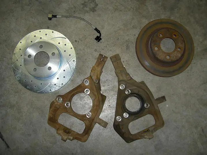

You need the factory 1" rotor upgrade of 2001, the Sport Trac and Sport models got a different spindle, which locates the caliper outboard 1/2" farther. I have those on my 99 Explorer, it isn't a big change, but it's the only cheap and easy upgrade. I have custom 12.75" rotors on my Mountaineer, but those ended up turning into a much more expensive project than I hoped for.
Sport Trac spindle and rotor on the left, stock 99 spindle and rotor on the right. Note the caliper holes, that's the only change. You can use your existing calipers, pads, and lines.
Has to fit within my 16" wheels, but also, I just replaced the front ones with new drilled and slotted, hate to put them aside for a second set that's not going to help much more. Did a lot of reading through threads last night, saw yours a few times, still considering, just wondering if its worth it in my case.

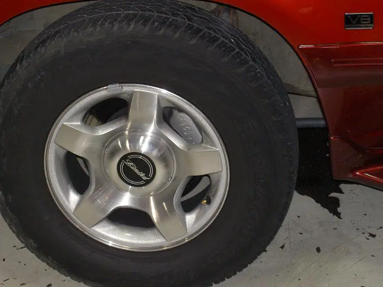

Yeah, replace the booster if it may be suspect. I would expect it to work fairly well with 32" tires. I could tell a big difference with 31.5" tires when I first tried an 18" wheel package. The total weight of the wheel and tire was 72.5lbs, while the old 17" Cobra wheel and tires were 58lbs.
Weigh your wheel and tire, see how much that is. I have aftermarket Volk Racing 17x9's that with tires should be under 60lbs, that will be back close to the stock weight levels.

The total weight of mine i belive are a out 90lbs, the wheel ain't sold anymore but based on a 6 lug version being 34 lbs and the tire being 56 lbs, definitely makes a difference, but still should have more power than I do based on yours.
