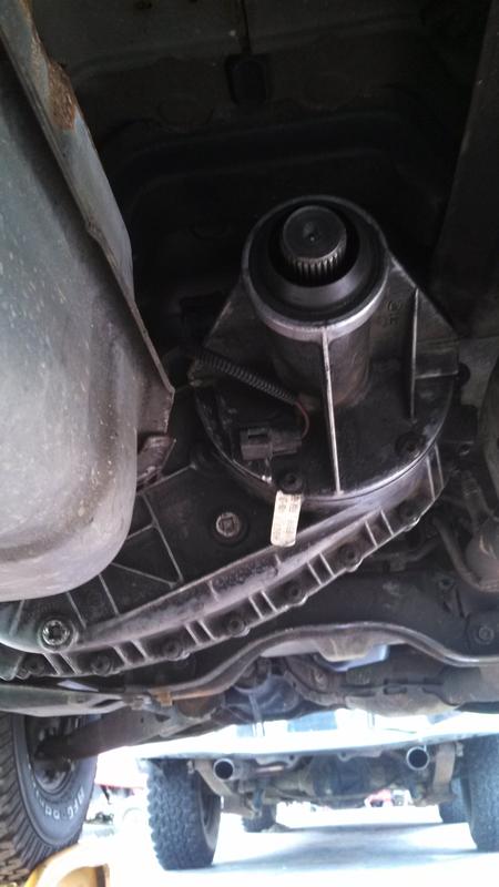

Just a few pics of the process, I cut the tabs off of the case and then smoothed them with a flap disc, I have the truck on ramps and stands in my driveway , the driveshafts are out and I've started on the awd case to tranny bolts , just stopped for lunch ,

That's where I'm at and its bad enough its a heavy awkward pig but it is a very tight fit and has to go in just so , but I'll get it ,
More pics , after I took these this morning I got the case installed along with the rear driveshaft , the ratchet straps helped keep the tank and exhaust out of the way , you can also see my tank bracket , I just cut off the the part that was in the way and it seems plenty strong
Well I got the shifter in and took it for a ride , wow what a difference! I didn't get to the front driveshaft but that doesn't really matter since I have the manual hubs , I'll post a few more pics in a few
Shifter located, I'm not gonna use the boot and bezel I have because it doesn't fit quite rite but I'll get the f150 one in the morning from the junkyard, the mileage is now saying I'm getting 23/24 mpg at 55/60 mph , it was 17/18 mpg at those speeds, it steers like an old crown Vic and it will smoke the tires very easily,
