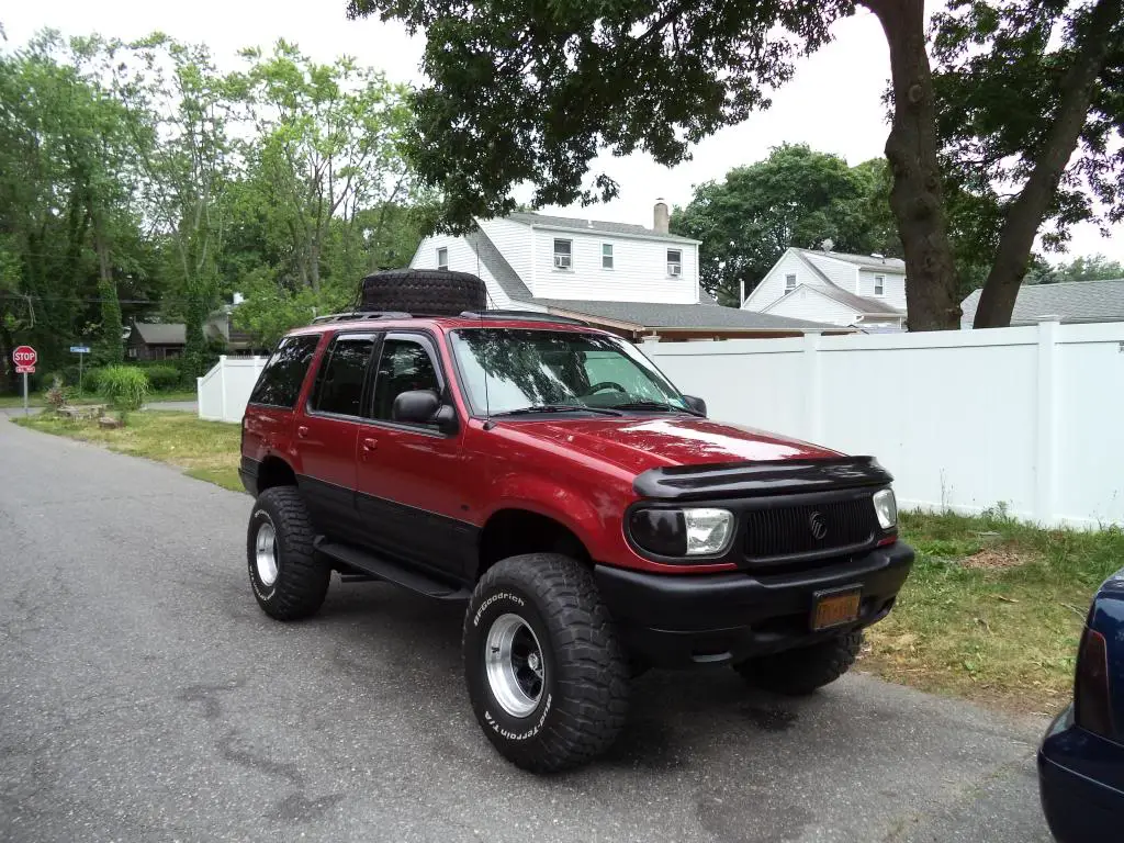

You have a very nice looking Mounty. Love what you've done with it! :thumbsup:
Looks awesome dude. I was about to scrap mine, and decided to just slowly bring it back. Normally not one for fixing rust, but I figure the rough body lets me give zero fu%$s on a trail. 209k on it, and starts every single day, and runs perfectly smooth. Hard to let it go, so I wont haha.

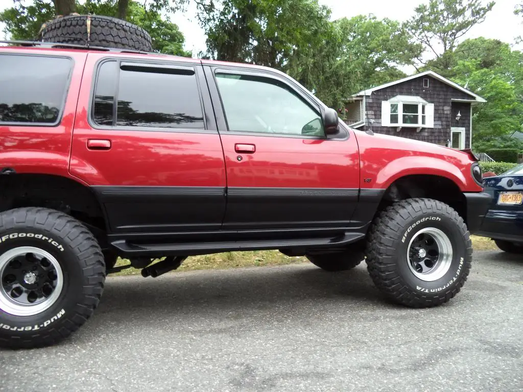

i did the procomp "long" and "short" leafs 100bux total for both sets
pretty much gave me 3inches....and i put them in the order they go...
and i swapped the right and left leaf packs while i had them down.
it fixed the "drivers side lean"....
hope this helps you....what do you plan to do with your x???...

just a lil trimming....about 2 inches on both sides of the tire...not much at all

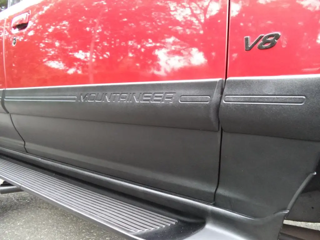

ive since truck bed coated the sides (that are grey).

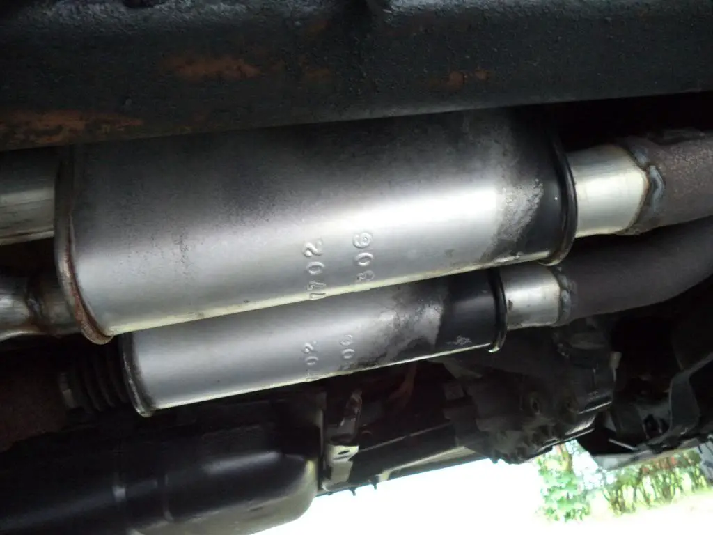

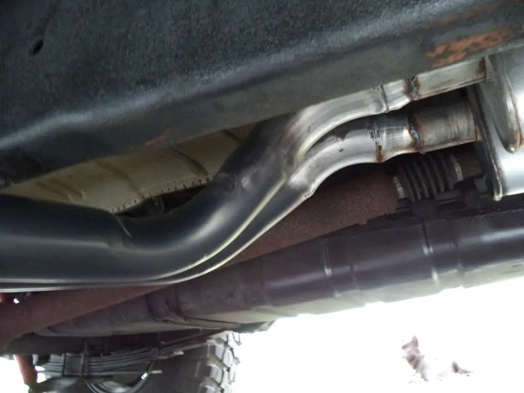

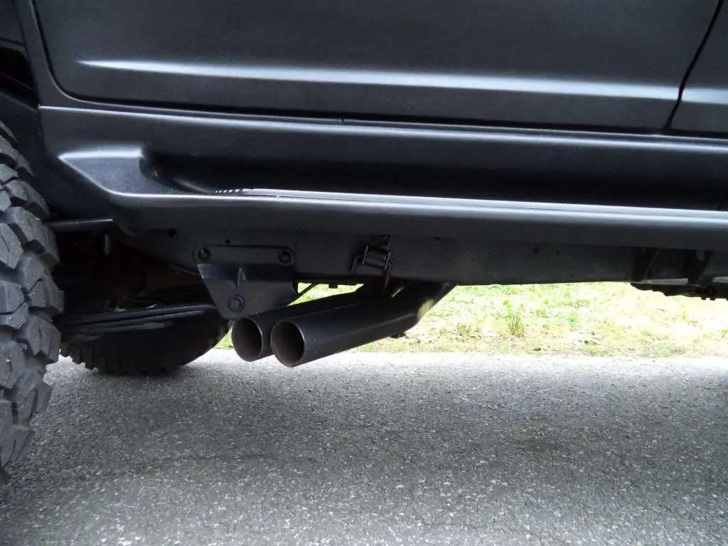

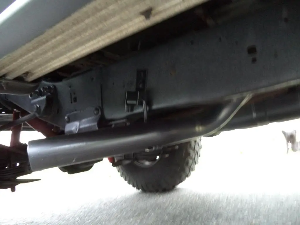

and added a sweet exhaust, ( dual trush turbos with dual side exit).
I love the truck....haha
:salute:
Post some pics up of your exhaust I been thinking about doing that same setup.
thanks alot man...

wow that is a nice truck sir!
i have a mounty also love it! i have been considering the 3" BL myself but if i do that will try and buy tires lol and that wont be good for the bank account. im on a TT/ shackles AAL on 32's.

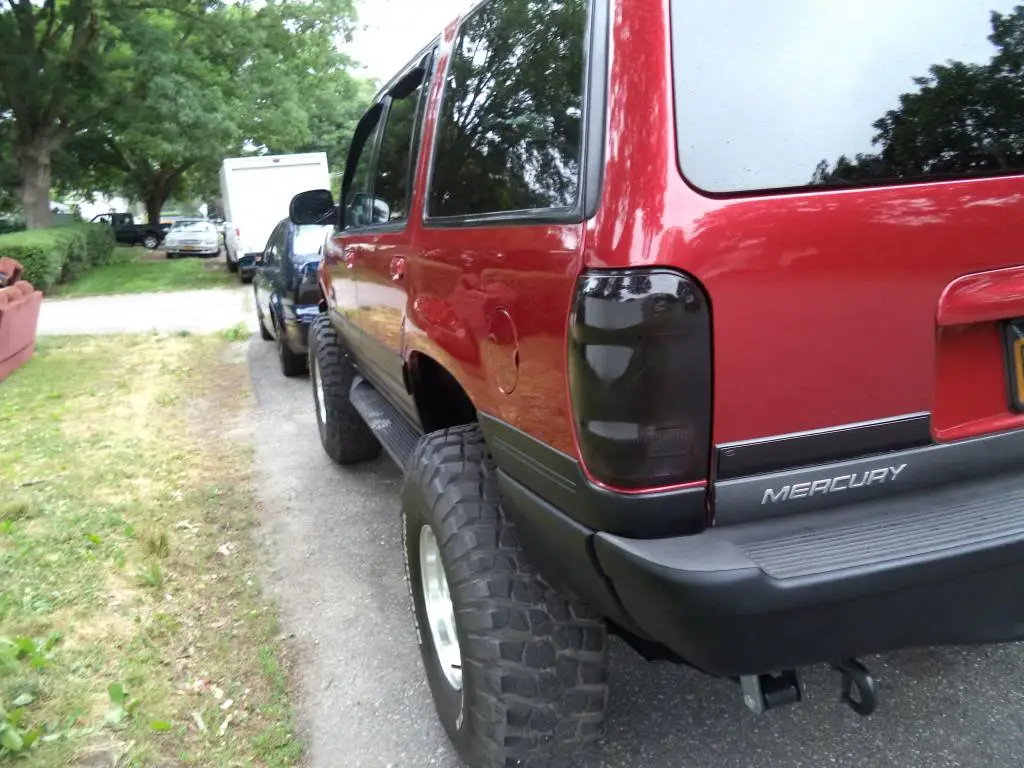

where did you get those covers on the front corner lights? or did you do it yourself?
I thought you were going with SAS...???
I also did the tint myself, on the lights.....VHT tint spray.

I took some pics of the truck and the exhaust...tell me what you think.

Looks really good exactly what i was planning on doing with 2 flowmasters. How loud is it can ya post a sound clip?
