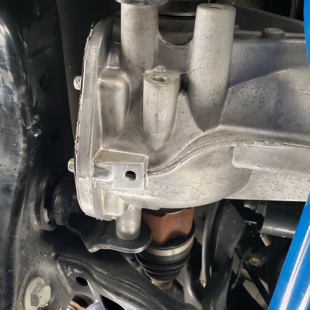

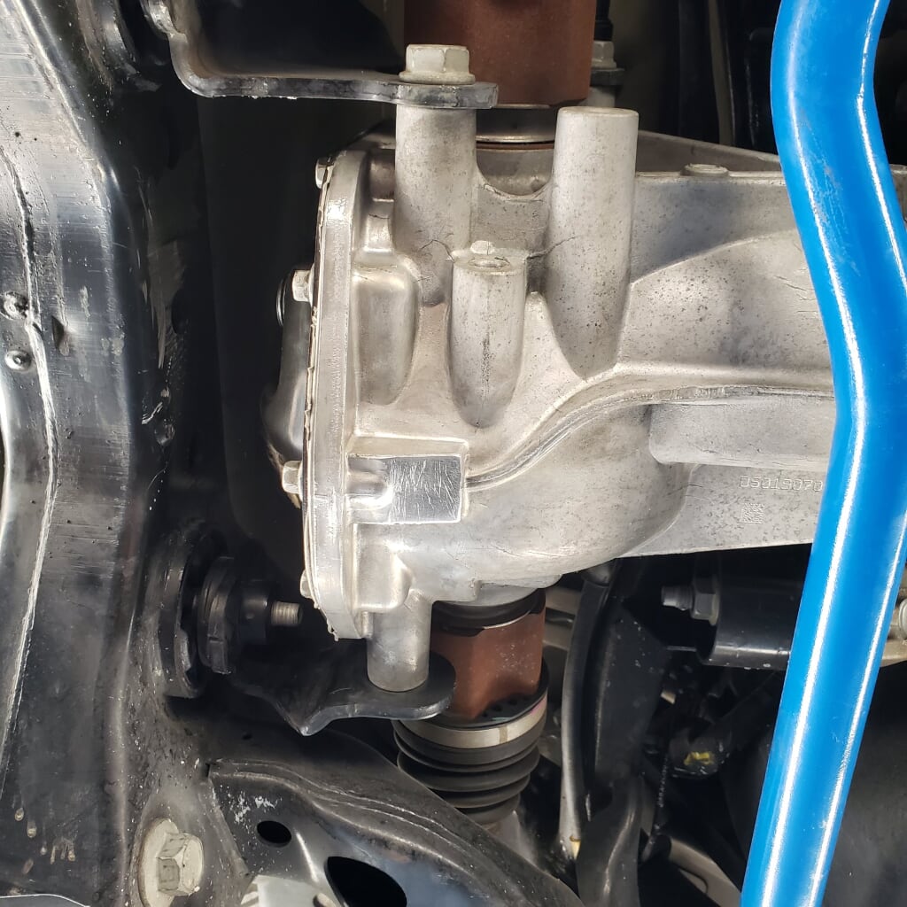

Had to get rid of this silly hanger first:
Smooth the location of the plug:

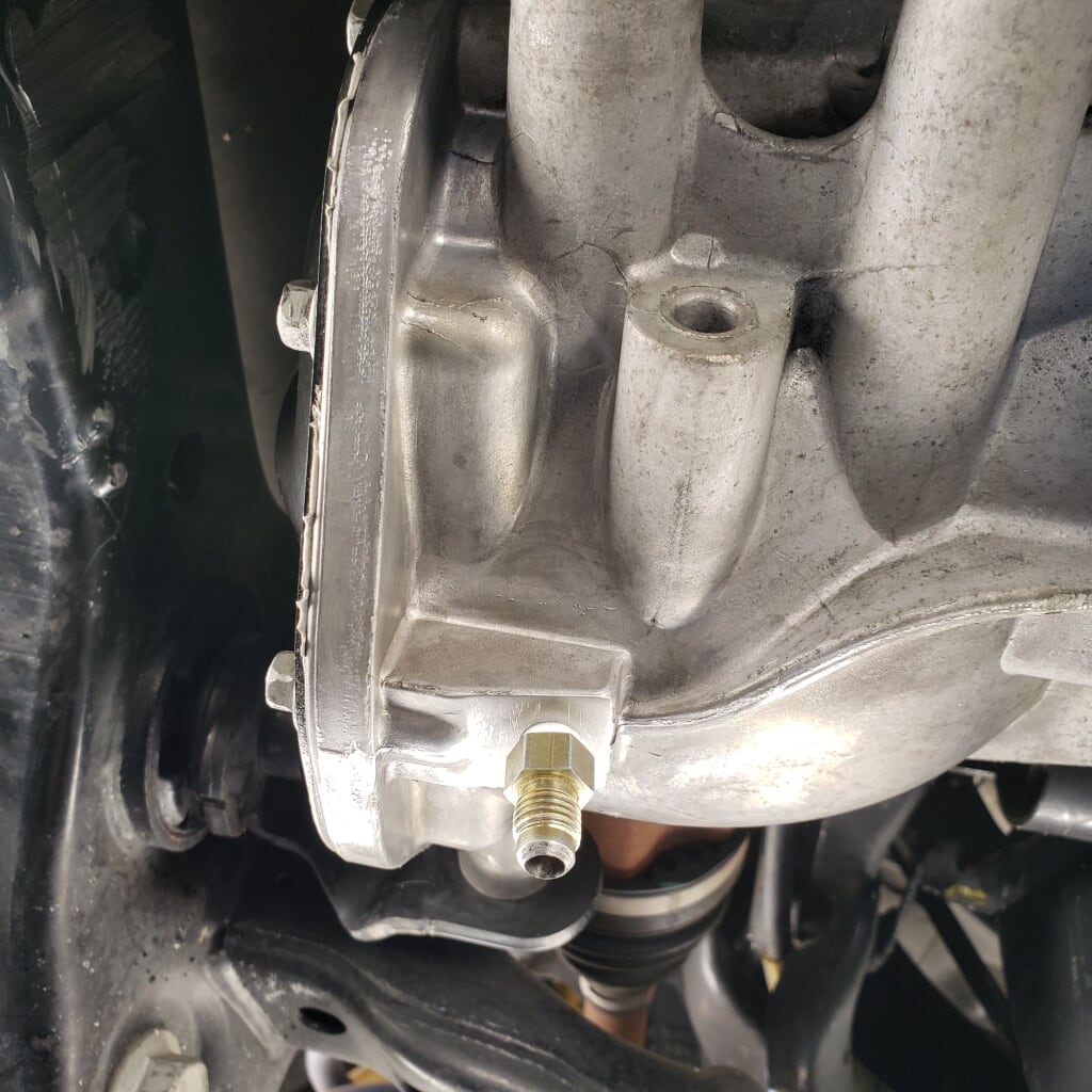

Drilled then tapped for 1/8-27 NPT:
I was gonna go with the magnetic NPT drain plug, but I don't like the idea of constantly breaking the seal of an NPT fitting doing maintenance. Decided on an NPT to Flare fitting adapter:
Now I'll never have to break that NPT seal. Just undo the cap...

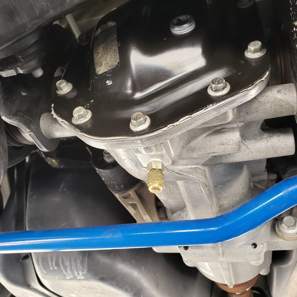

Cap is on tight with an o-ring seal, but just in case, for double protection, here is some adhesive heat shrink to keep it from spinning off over time (that would be catastrophic, lol). It's easy enough to cut with a razor and peel off when time to do the service:

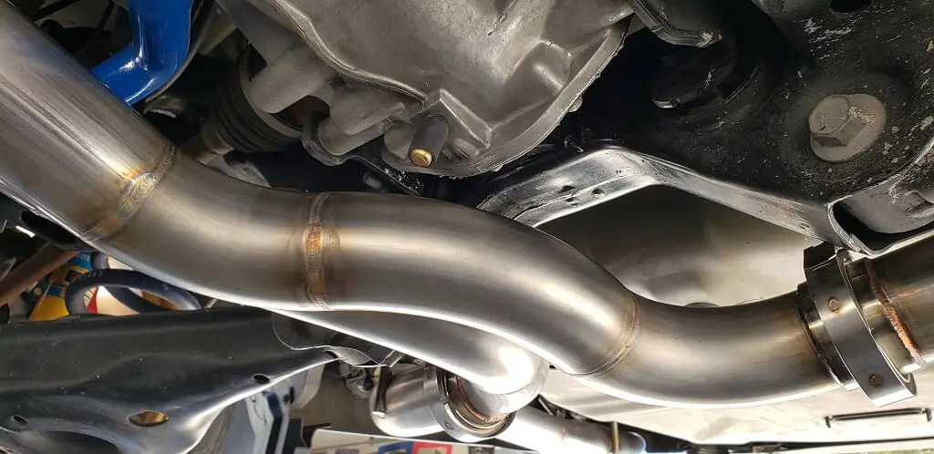

SOOOOO easy with those v-bands on the exhaust...
