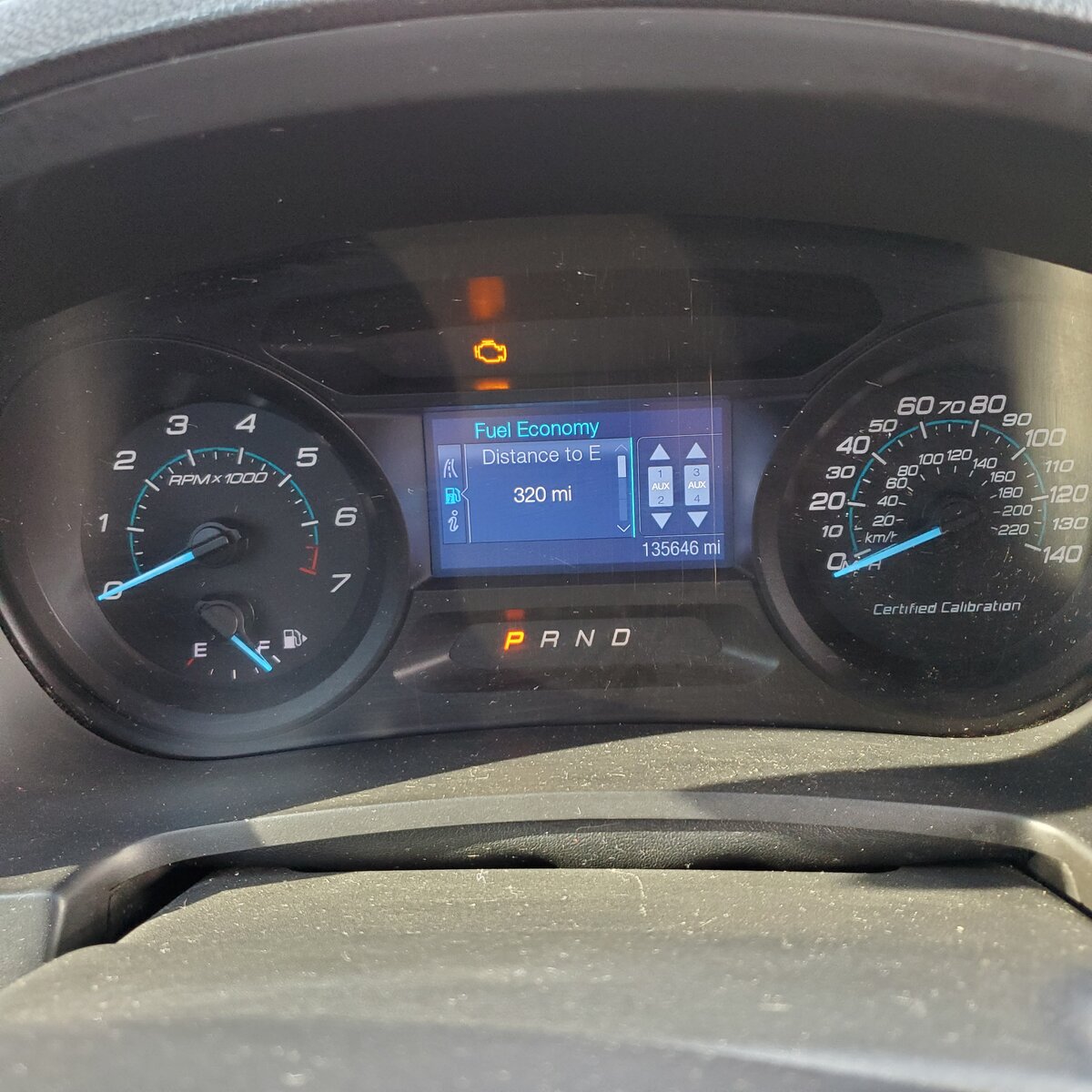

I have a 2013 Ford Explorer Police Utility, how can I get my digital speedometer to display under the Trip tab? I know most of our others in the fleet have it?

Try this, it worked for my 2014 PIU.
Use the steering wheel up/down buttons to scroll through the menus until screen displays TRIP 1/2, then press right to get to digital speedometer, then press okay.
