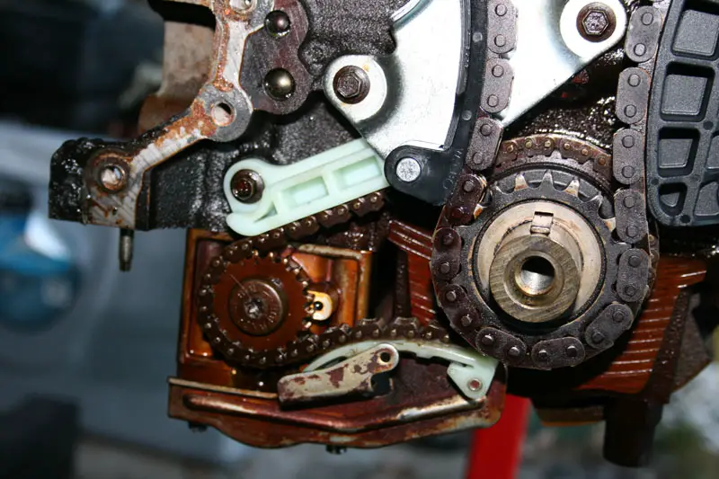

I recently Bought a explorer with bad timing chains and bent valves so I bought a wrecked truck with a what i thought was quiet good 4.0L as a replacement. I started resealing the valve cover and noticed the rear cassette is broke, I understand the timing procedure as I have done several 4.0s and have all the proper hold down tools and jackshaft wrench from otc. Now I am contemplating pulling the front cover to inspect but fear I will find a bad tensioner on the balance chain. This project already got more expensive than I planed with finding the rear cassette broke. I think I might do the front chains right away as preventive maintenance but do not want to remove the girdle. has anybody just disabled the balance chain by removing the chain and guides? its another moving part that seems to not be needed and has a high failure rate.
