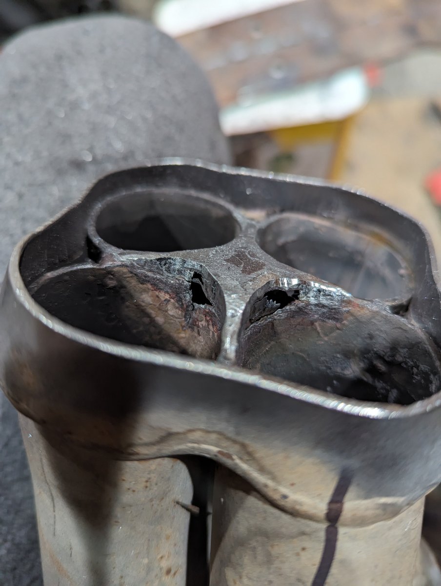

Oof, merge spike aside, the TMH primaries are pretty rotted at the collector.
I've got some ideas and I'm curious what the fab guys think too.
what side is that?
Passenger side. Fab guy said it'll probably be best to cut out all the rot, then rebuild with sleeves from the inside out. He's probably right. I was just going to use a square nut as a backer and burn right through the thin material into the nut, but he thought that wouldn't hold for long.
When I leak tested last night, the driver's side is blown out even worse, although it does still have the merge spike in place.
I think the root cause is likely the way the merge stars overhang the tubing. That little "shelf" creates a spot where condensation can sit and eat away at the weld.

No worries, there was no way to know without cutting collectors off and grinding into the rust. If fixing them is going to be too expensive, I'll still keep them for future reference/jig building.
I went ahead and ordered some blue magic like @Turdle suggested and plan to smooth the welds on my headers, paste the goo on, then hit each primary with the shop vac to pull the thermosteel into all the gaps. Of all the products I read about, that one seemed to have the highest temp rating and most positive reviews. Like anything, I'll want the headers very clean before I apply it. If subsequent leak test looks okay, I'll proceed with ceramic coating and wrap as I was already planning.

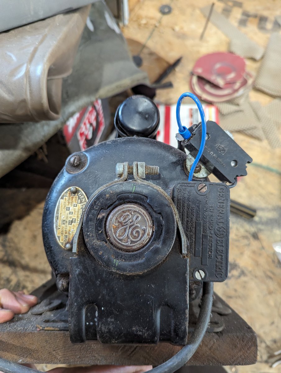

Smooth it out on my "sander" aka 1930s GE fridge motor

Cool! This one's a full DIY job made by my grandpa's cousin who was a great depression era handyman. The base is a plank of wood and the work surface is all galvanized metal (probably leftover air duct).
I think my dad added the toggle switch. All I've done is add oil and put Velcro backing on the disk so I can use hook/loop sanding pads instead of adhesive-backed ones. Pretty cool that these were made to be serviceable back in the day. I wouldn't doubt that this thing will outlive me.
