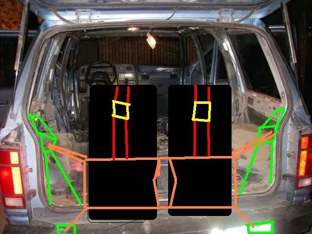

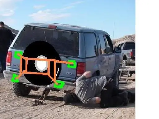

Here are some weak sketches for the tire carrier(s)
Green points will be tied into bumper and cage, orange points will be fully removable.
So the hatch will be removeable, right? And when it's off you'll have two spares next to each other, and when it's on you'll have one spare facing backwards? Just wanna be sure i know what's goin on.

no, it's not to scale, it will sit up as high as a normal spare, I jsut only had this pic of the rear and used MS paint to mock it up. The carrier will be much higher and have a totally different design.

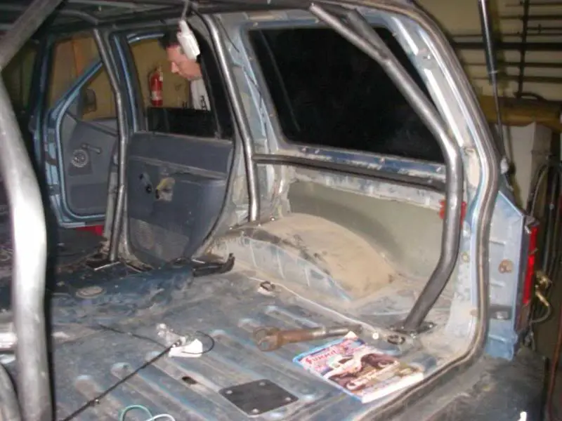

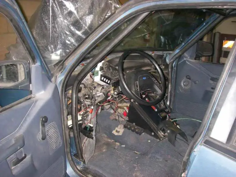

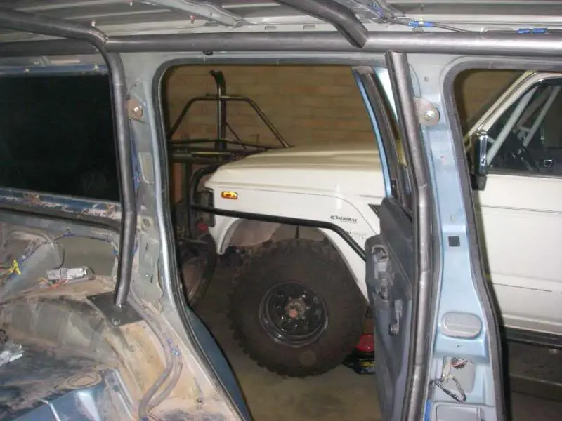

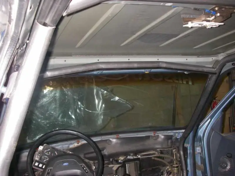

Pics coming, stay tuned. Seats will be here today or tomorrow, cage is coming along nicely. The cargo area is complete, a different look but it will work great for my tire idea. something like 18 bends on 24 feet of steel!
a few pics of progress

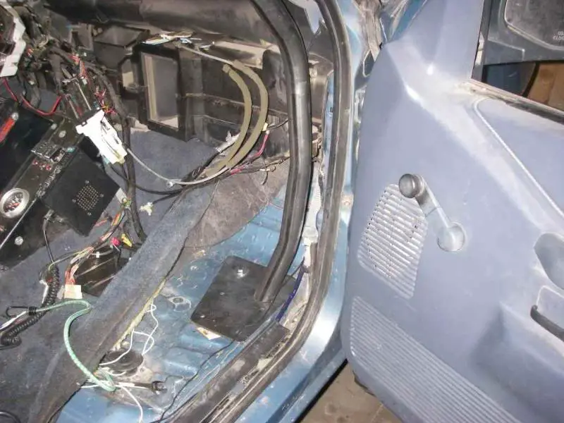

This design should work well for my rear tire carrier idea, also the front plate to tie into the frame near the back and also replaces stock body bolt, with a sleeve sandwiched between the two plates to eliminate crushing of the body together at the floor.
Still a long ways to go!
