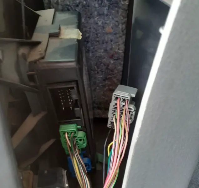

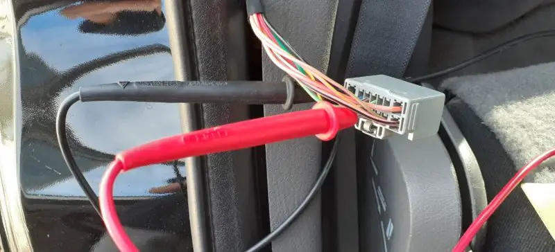

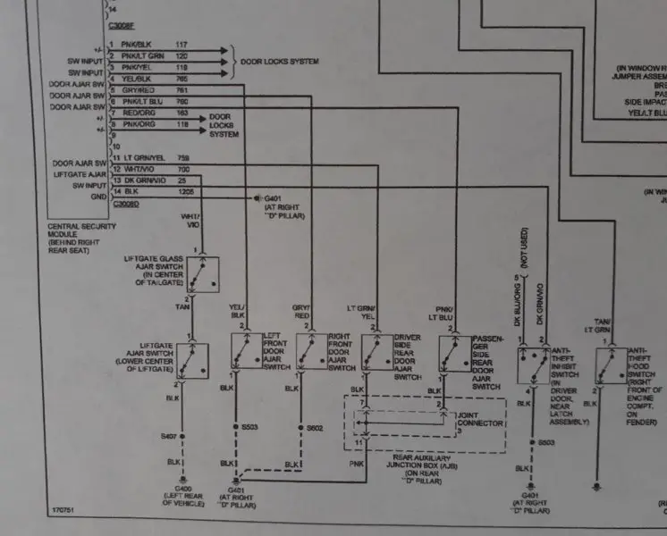

There is somewhat faster way to diagnose it.
Pull the cover from rear passenger door pillar (pillar D). There you can access a main security module that monitors all the doors too. Pull the top (grey) connector out and check continuity between contact 14 (ground) and:
12 - Lift gate and lift gate glass (these are daisy chain connected)
11 - Driver side rear door
6 - Passenger side rear door
5 - Right front door
4 - Left front door
Whichever line doesn't ring - that door switch most likely damaged, and you will have to go into the door. If none of them rings - most likely main ground wire is damaged and the repair will be like shane10 and abcducati mentioned.
