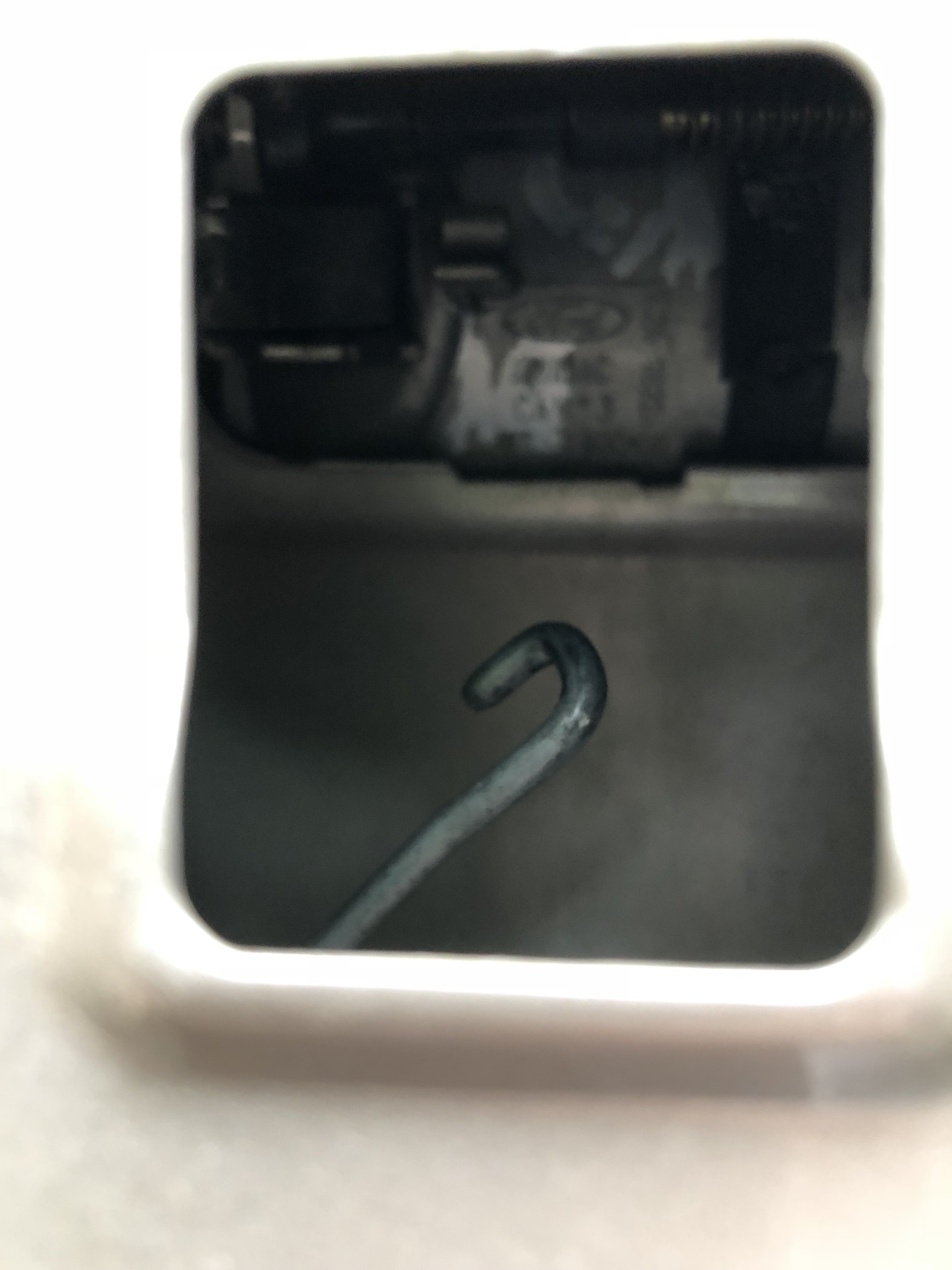

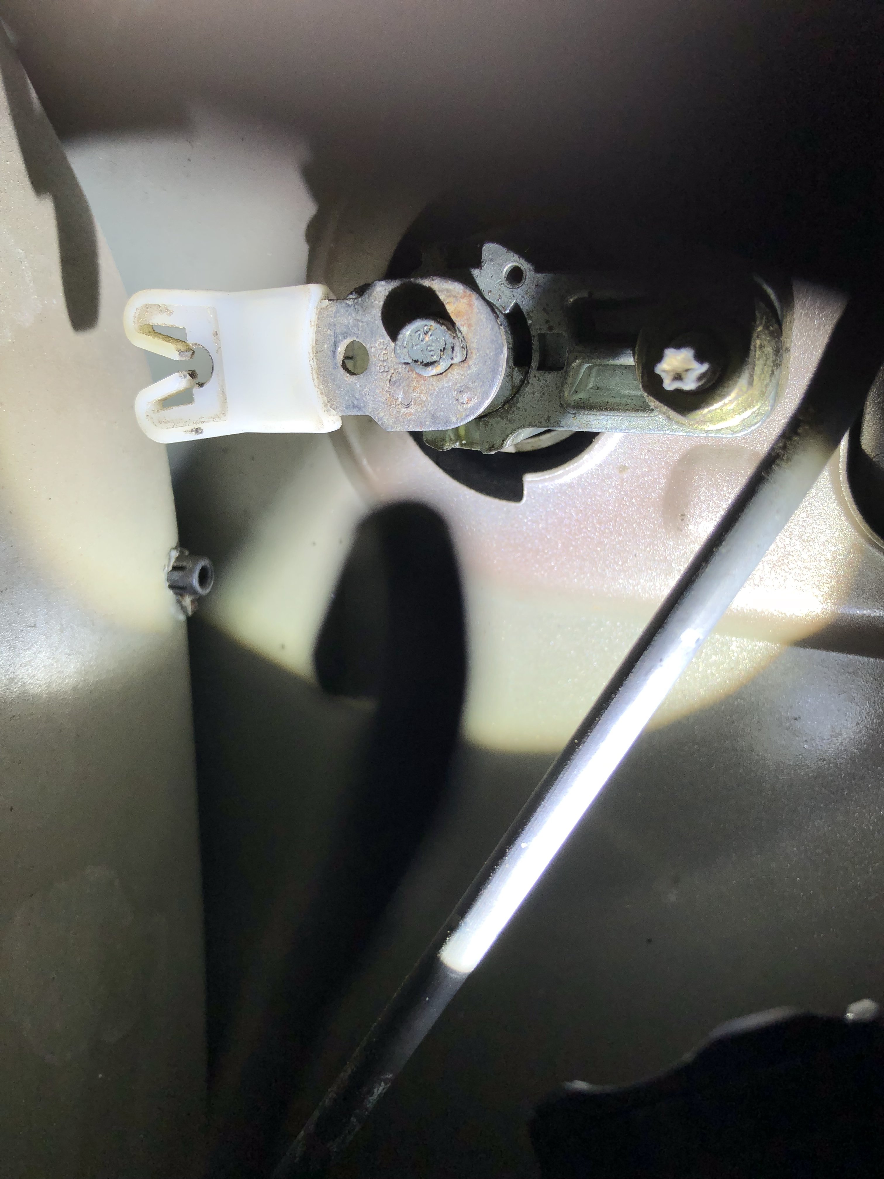

so I removed the door panel to take a look. The key had no resistance when trying to lock/unlock.

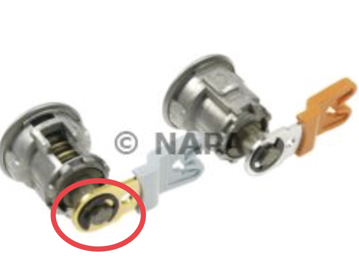

Found the rod completely disengaged and the lock to rod piece off. I’m assuming there’s supposed to be a E-Clip style fastener here?
Anyone had this happen?

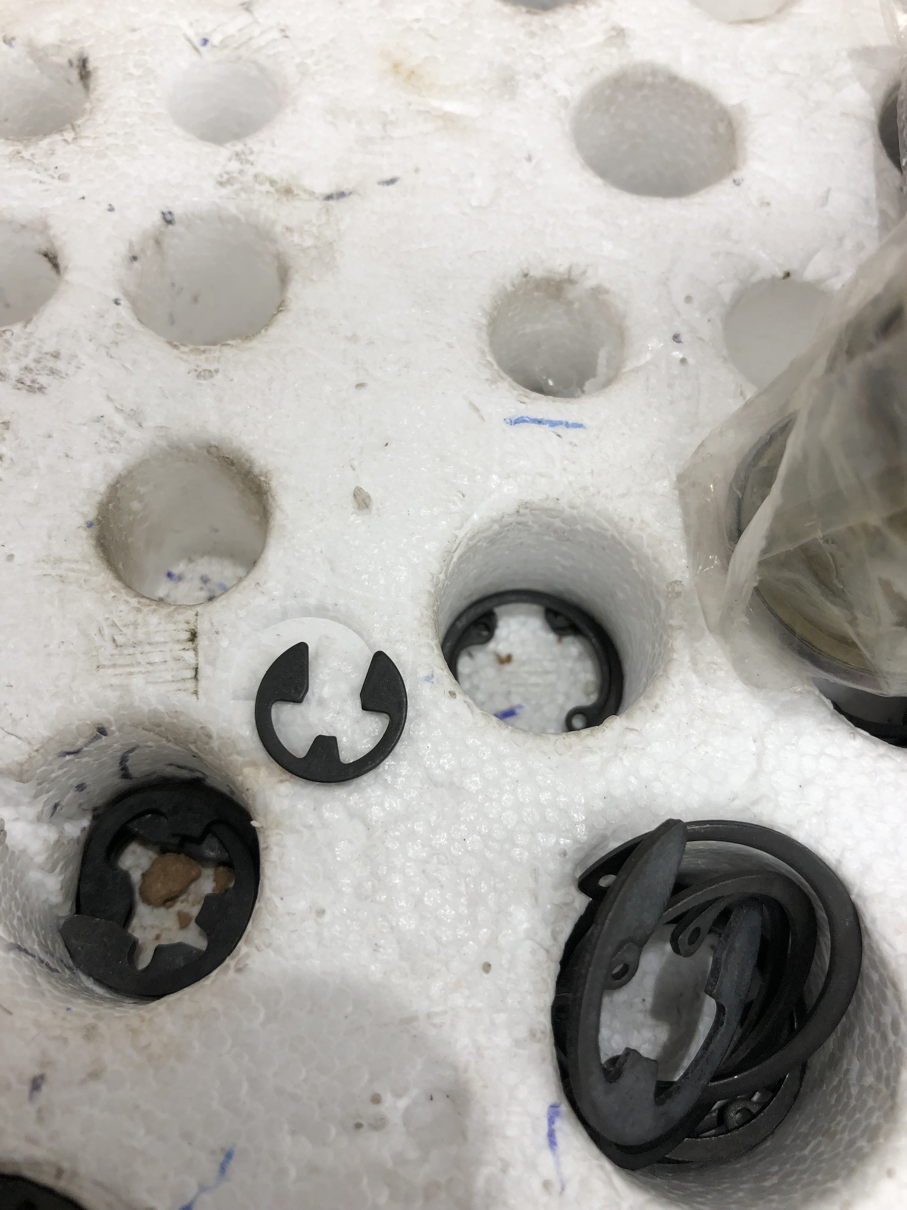

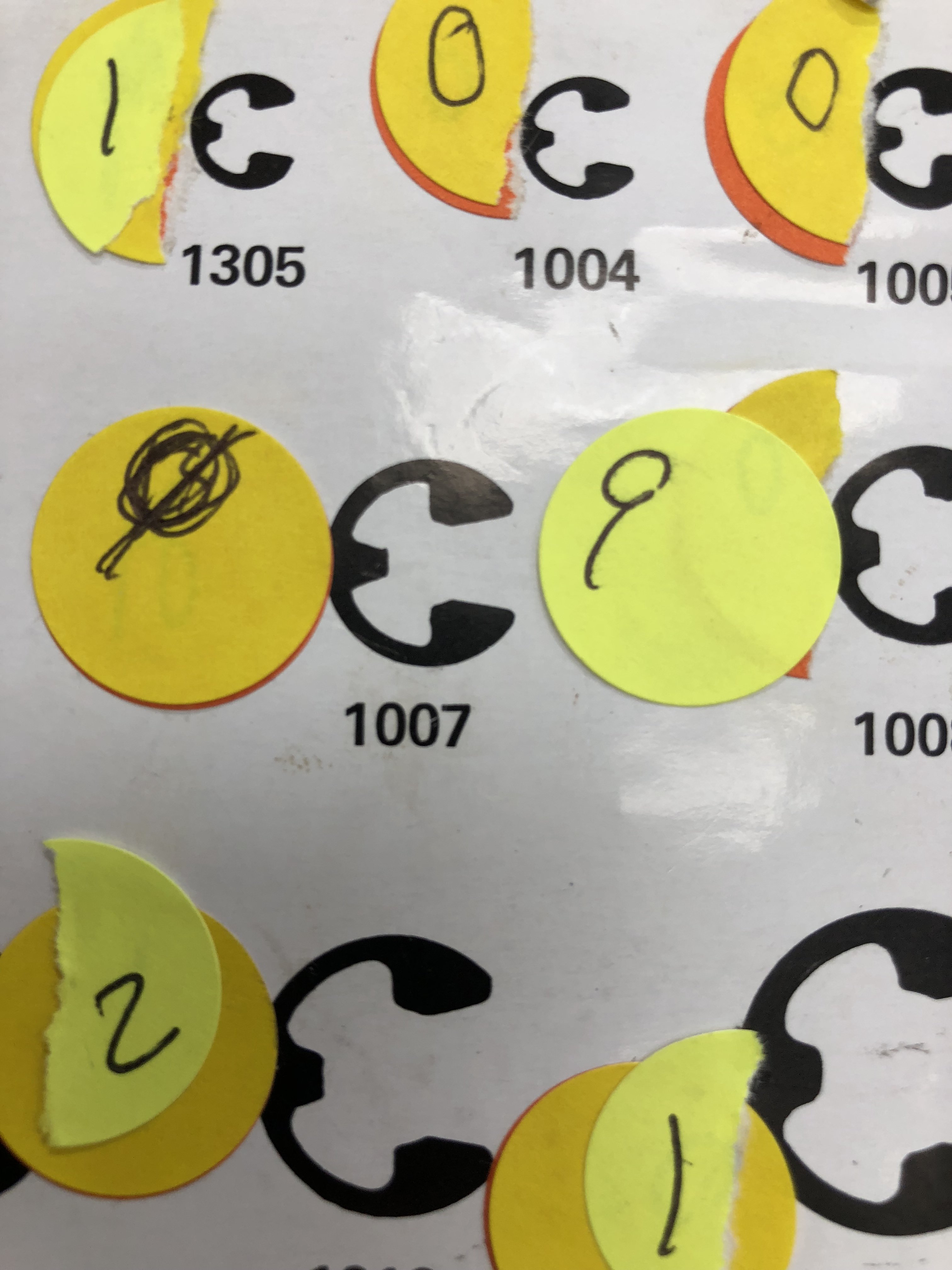

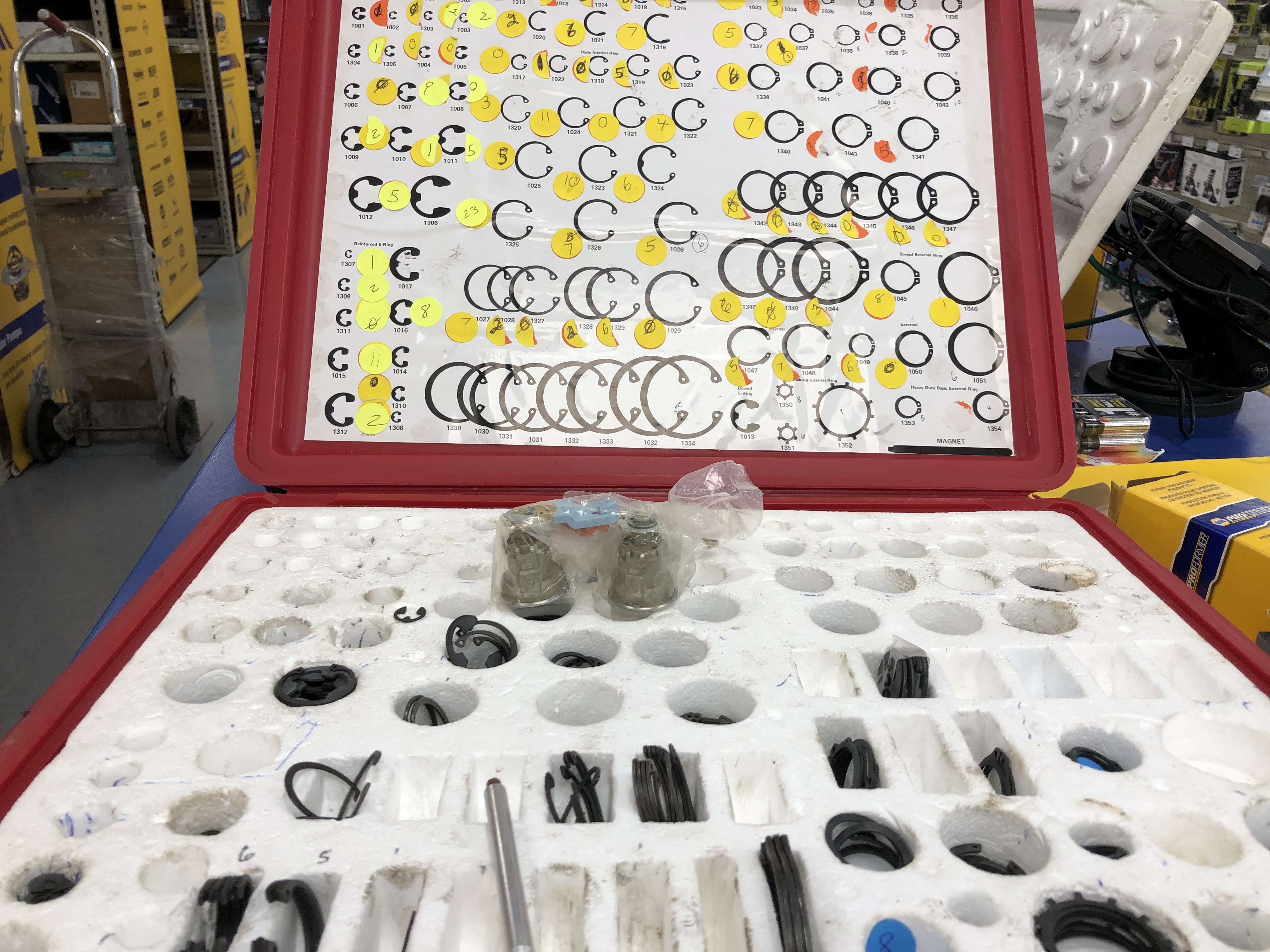

Yup, looked at NAPA online and it does use an E-Clip. Now to find the right size....
I really just posted this because I hadn’t created a post in who-knows-how-long.

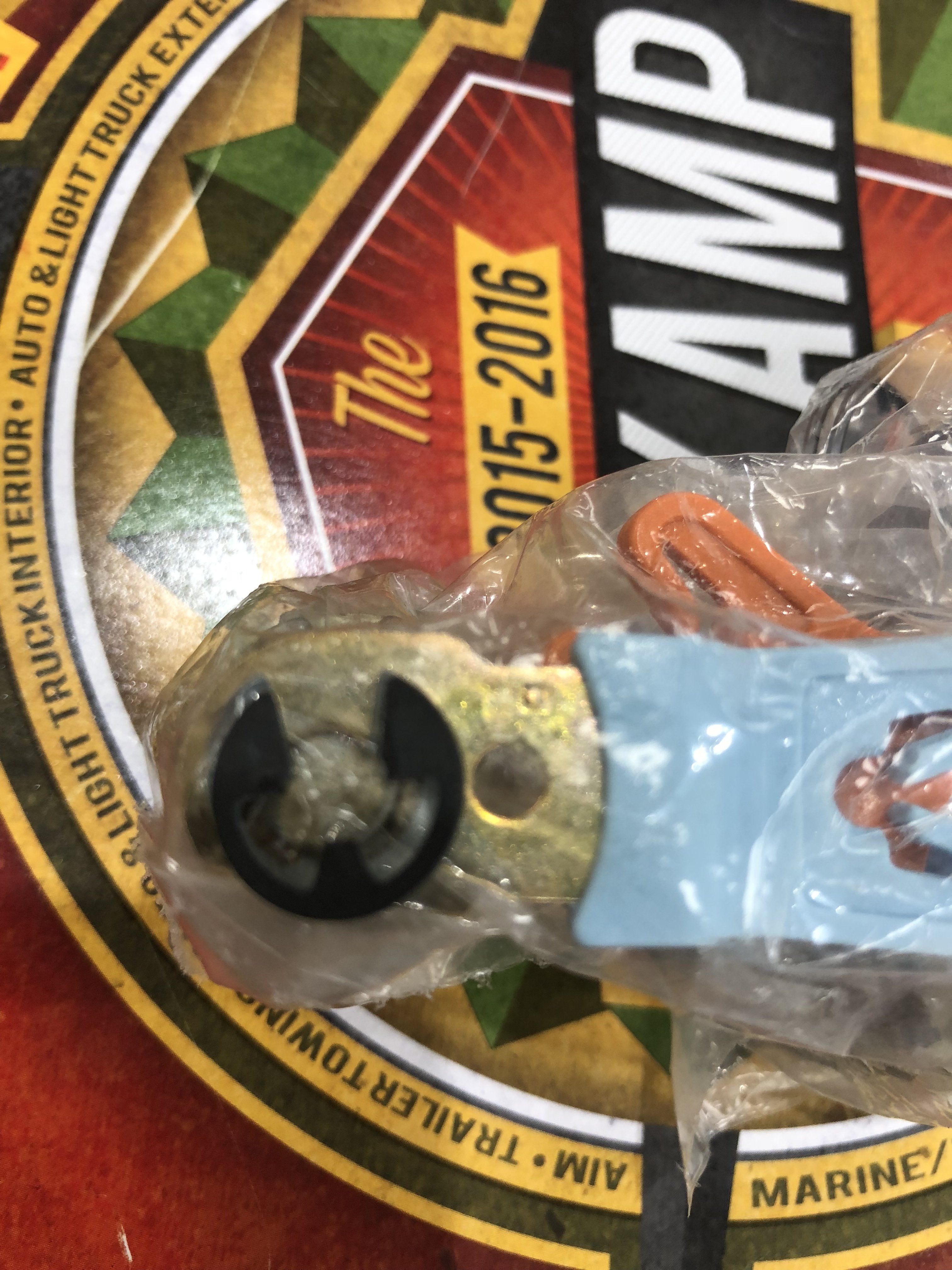

NAPA has the lock, and an assortment of E-Clips in stock. SER 1007 is the line / part number.
Good info...thanks!
This just happened to me. Did you have to replace the lock itself or just install a new eclip and connect the rod?
Just a new E-Clip
I just used a little jb quick weld and it's fine now

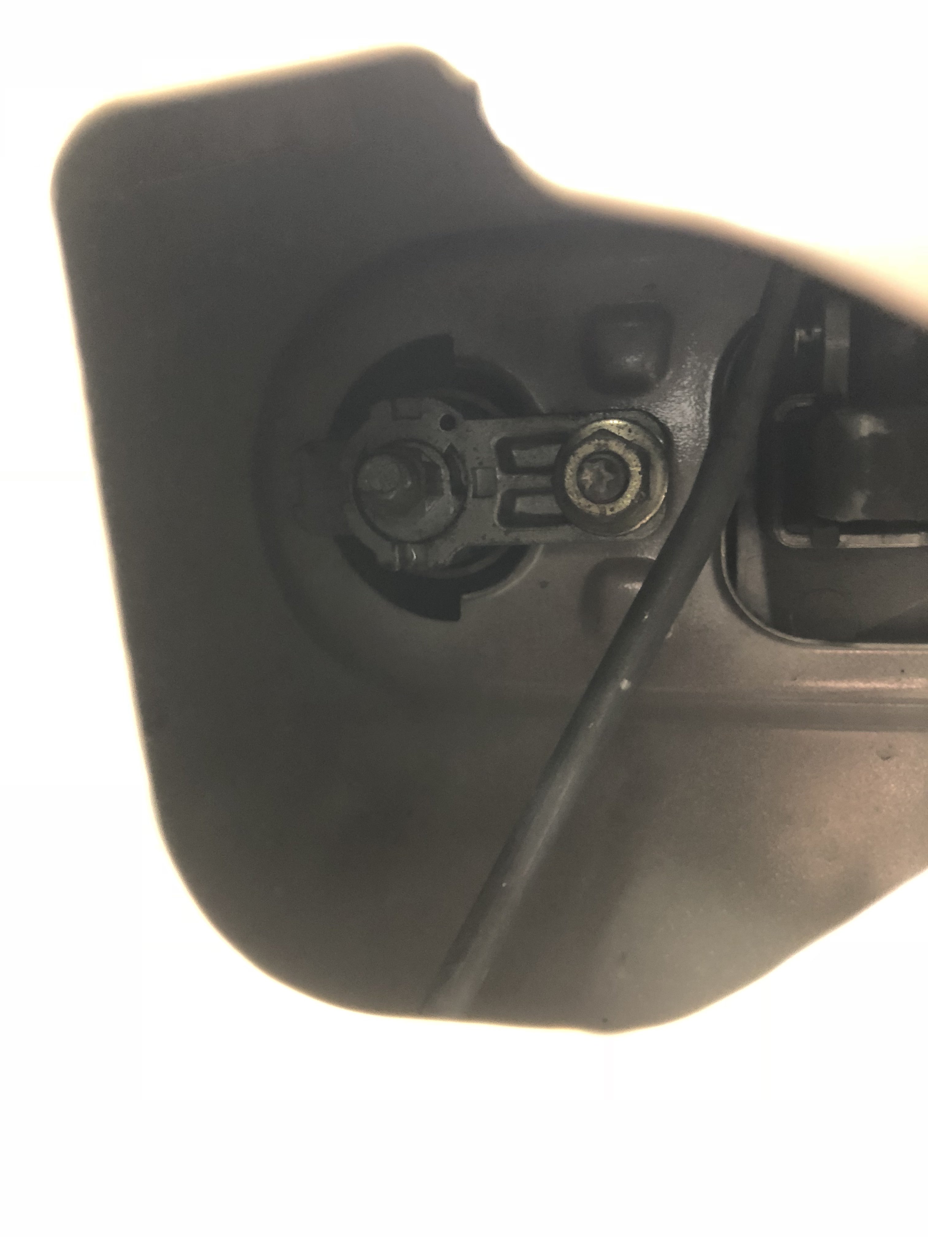

I’m in the middle of this. Removed door panel and peeled back the foam insulation. I see the hook and missing e clip. But how do you get to it? The door has tiny cutouts in the interior sheet metal. Your pictures look like bigger holes. Do I need to remove the lock from the outside?
Edit: never mind. Just attached the lever first through the holes, then attached the hook second.
