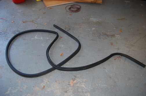

The howling sound of wind and road noise leaking past tattered old weatherstripping finally drove me to remedy the situation. The front passenger door of my ’99 has been leaking air like a window screen in a hurricane and the resulting noise required attention, immediate attention.
The front passenger door weatherstripping had seen better days. I obtained the door weather stripping ( part number F1TZ7820708C
) from my local Ford dealer for $41.00.

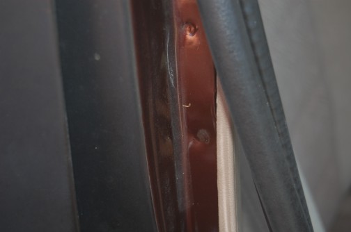

The first step was removal of the old weatherstripping. This was accomplished by first loosening the plastic trim components ( no need to remove ) and then simply pulling the old weatherstripping free.

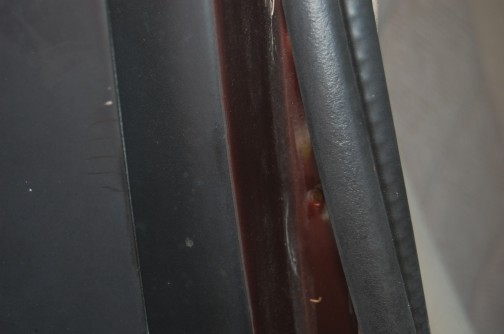

The new weatherstripping was simply put into the metal on the body around the door. I started at the center of the bottom of the door so the joint would be in that location. The weatherstripping was worked into place all around the door.
This incredibly simple task took all of 10 minutes including loosening/securing the plastic trim.
A road test proved the worth of this project. Next step will be to replace all the other door and liftgate weatherstripping.

The old weatherstripping ...
