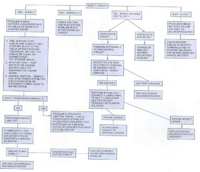

EDIT: check this picture out, a simple flow chart, but it makes me think... (explorerDMB, yr the **** for this)
At first glance you would be like... what? OK? Look under where it says, 'just clicks.' Ground to the block? Ahhh!! i painted the block! There is one spot where the starter cable gets bolted down onto the side of the block, above the oil filter. Im wondering if it grounds there?
But now that i think about it, i think the click the flow chart is describing is the kind of clicking you get when try to start the boat after its been sitting all winter. The machine-gun type of 'clic-clic-clic-clic'. When the battery is about dead. My stuff makes three distinct clicks and stops.

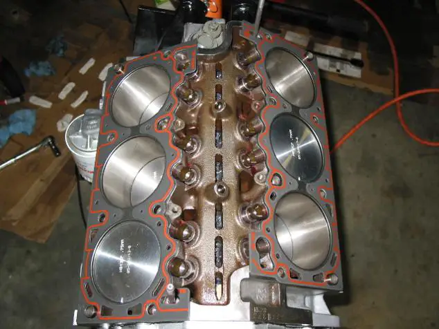

To teast you a little bit, here is a pic taken right after the oilpan was buttoned up.

Those lifters are a pain to keep clean, not because of north carolina has tons of organic crap flying around, but because moly from the cam lobes likes to spread its love, all over the lifter bodies. Once it gets on the body, it acts as an adhesive to the lifter. You can see this when the lifter is supposed to 'fall,' if moly is in there it simply wont. I believe the moly would put excessive wear on the lifter.
In the second pic i got the head surfaces cleaned up and ready to be bolted on.

Pic one was shows the deck surface ready for the headgasket, towel-clean with laquor-thinner.
Pic two shows the headgasket pre-seated and ready for torquage.
Pic three is the heads placed on, finger tight.

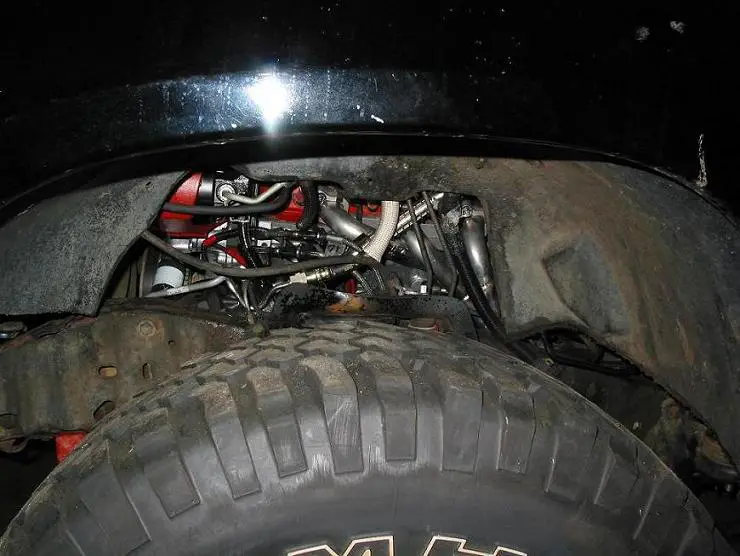

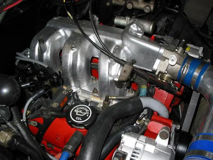

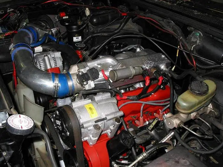

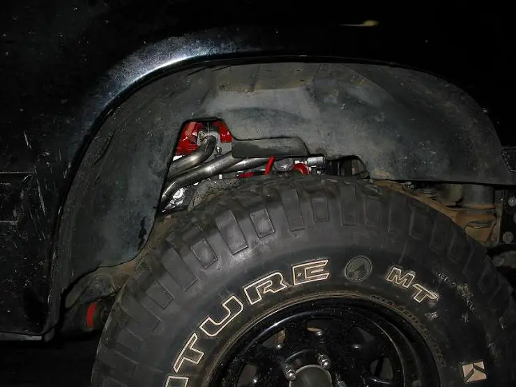

Here it is!
And ill repeat! its mean!
The blue couplers and the current air filter are temporary. I just boils down to when i get around to measuring and ordering red replacements for that stuff.
I'm definatly going to go through and try and run the stuff on the driverside of the engine comparment a little more clean. As everything is now, its all in a good enough spot where its not stretching or touching anything it shouldnt, but i can probably make it look a lil bit more factory.
I also have a replacement fan, but the fan-clutch i bought was such a peice of junk. I had it on the water pump originally, but the fan would hit the radiator hose and was rubbing one of the pulleys, so i ripped that sucker and put the factory one on there. Ill probably put the new fan on the factory clutch, the clutch works fine as of right now.
