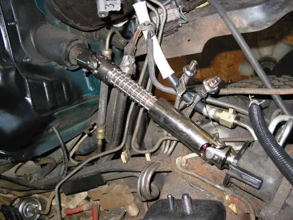

I got my Flaming-River Easy-shaft installed today. WOW is all I can say, heheh and I haven’t actually got to drive the truck around yet to really tell! So far, I can tell all the looseness is gone, and the steering wheel is more responsive. No more knots, kinks, and dinks in the steering, completely smooth, BETTER then stock. I tested this by pushing the truck up the driveway (about 30’), and rolling back down into the garage, steers incredibly.
For all those who might be interested in this shaft, the one I used was 14". When I used Flaming-River's formula to determine what length of shaft I would need, I found that I would have needed a 15.5" shaft. I almost went with the 16" shaft (flaming river doesn’t make a 15" shaft). But I realized 16" would have been too long if I wanted to remove the body lift. As it turns out, the 14" shaft actually fits perfectly at full extension from the steering column to gear. There is a 3" slip in the shaft, so this shaft has plenty of space to slip for when I remove the body lift, the slip on the 16" shaft would have already been maxed out. One of the best $270 I’ve spent so far.
These are the yoke dimensions from flaming river; these should be identical for all explorers 91-94.
Column's end shaft is a 1"DD, (not sure what DD means, obviously it has something to with the interesting shape of the column end shaft, these numbers were provided by flaming-rivers tech support, they should know what it means)
The gear input shaft is 3/4X36 splined shaft.
Bada Bing bada boom, for once I actually have DECENT steering! I am almost more excited to see how it steers then I am about the engine! Haha, my steering has been completely trash, utterly unsafe since I've installed the body lift. Now it’s more responsive then stock.

Couple shots of that new, sexy steering shaft
and... Oops, looks like i missed a spot with the ol rattle can there

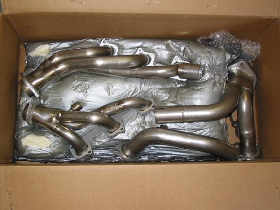

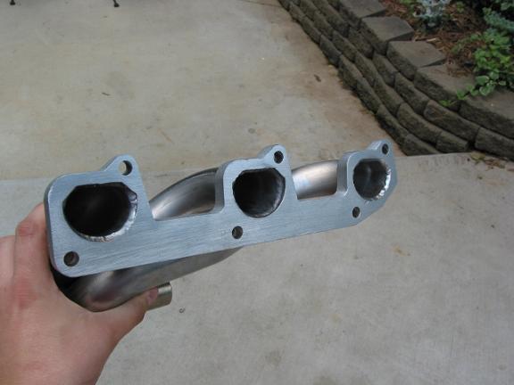

And the new Borla Headers...

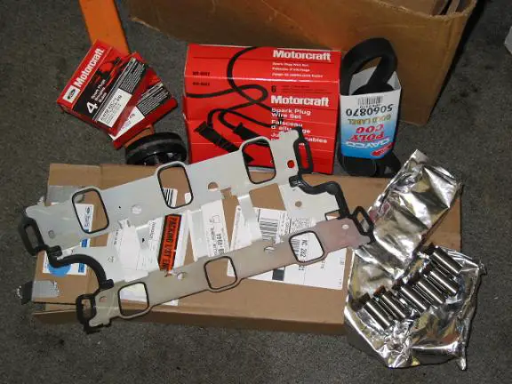

Heres a picture of all the recent additions to the collection, notice the *new* (not rebuilt!) lifters.
When i opened the bag with the lifters, i found one of them had their little cap come unclipped from the top of of the lifter body. I popped back on, and fits nice an snug. Is this anything is should worry about? Buying a new $30 lifter wont be that big of a deal if i should need to replace it.

Looks good. How much did those Borlas run ya? Where'd you get them? I'd like to get a set for mine (I know that I won't gain much/if any power but I mainly want them for the sound)
Body lifts, cause with those, you're making a larger gap between the steering wheel and frame (steering box obviously bolted to frame). Suspension wouldn't affect this.
There probably wouldnt be really any improvment over stock; unless your stock one is shod, which mine pretty much was after a few years of the greater steering angle caused by the body lift. Like what BMX stated, a suspention lift wouldnt have this issue. The only thing with the steering that needs to be changed with a suspention lift is the pitman arm, which needs to be dropped, or made longer, which is after the steering geer.
I bought the headers directly from borla at their web page. Costed me like a little under $400 after shipping.

hahah the shaft was a tad pricey, but under the circumstances i was very glad to fork out the $270 (after shipping) for it. Flaming-River fabbed it up.
