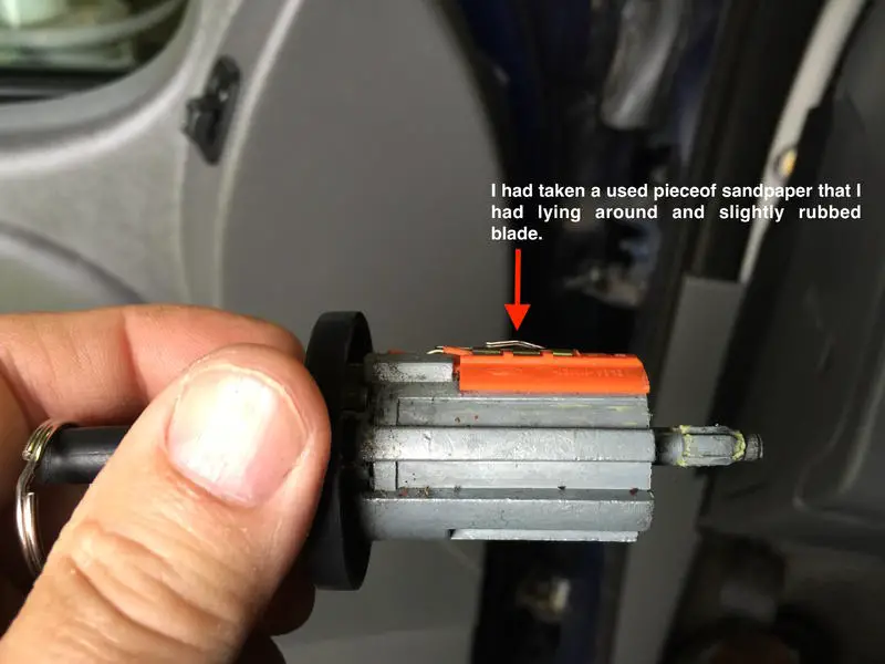

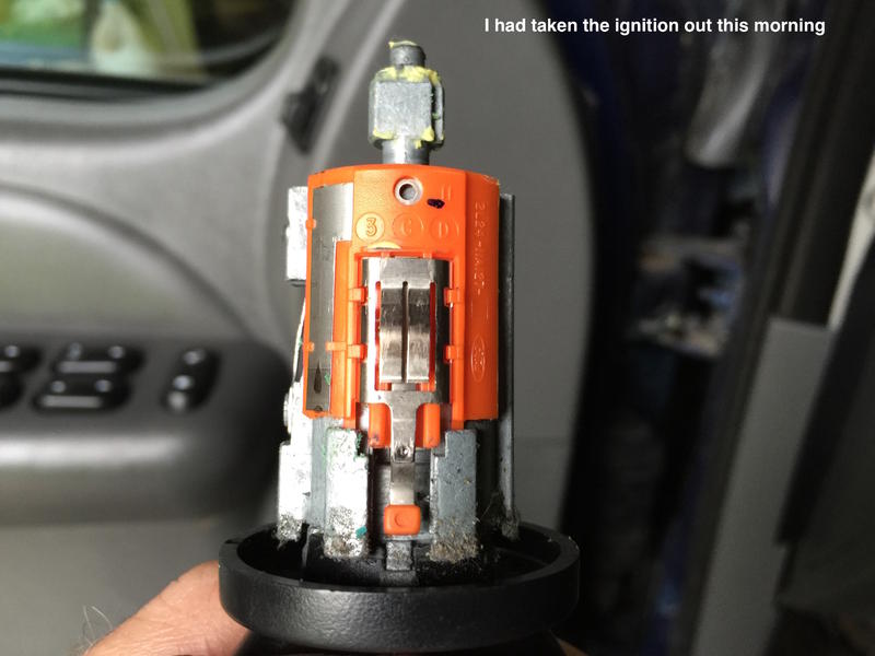

Can anyone tell me what this orange and blue thing are and what it's function is. Thank you for all of your help!!!!
