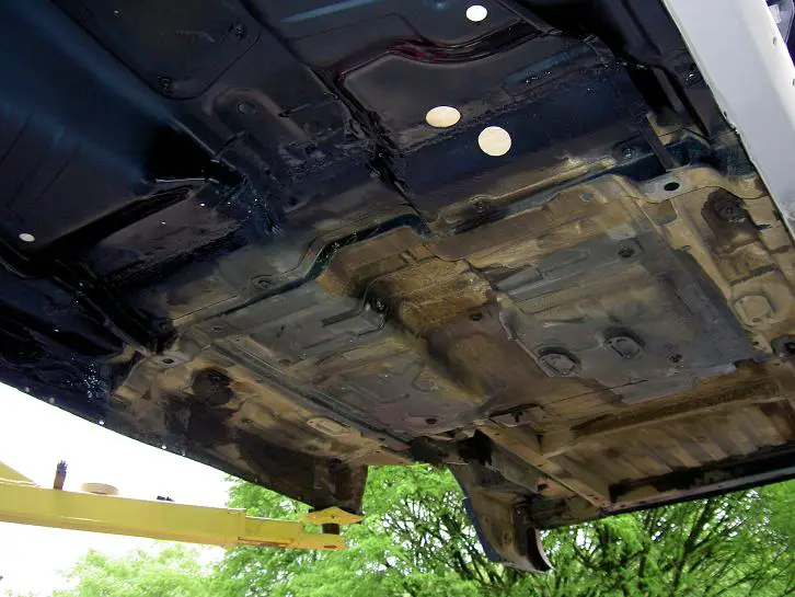

Got a hold of one of my 3 main mechs to ask if he noticed anything about a rotten subframe or suspension bad. He never had it up on the hoist so he said he couldn't say BUT he did say that he would be shocked if the entire suspension was shot. I mean I could take it to him at this point to check but he also said that he doesn't want to see me spend more money on it if not needed. Told him that I am trying to determine if it's a sellable truck at this point or to the wrecker.
Tough to get pics of this without hoisting it but I got a few. Had to use my phone unfortunately, was not able to use my better cameras.
This is the hole that is on the driver side just by the door hinge. Mechanic said that someone likely tried to jack it up there and punched the hole.
This is the passenger side from the ground up of some of the frame along there. I was trying to get where it was bent from what the mechanic said shops hoisting it and damaged it. Looks like I was close, the bent part was just a bit further back. Will try to get another pic of it.
Those pictures are all of the body, which no one should ever try to lift with. So that mechanic or others were idiots, these must only be lifted by the frame.

Yeah that doesn’t really matter. We are concerned about the frame components. The big C channel that runs the length of the vehicle, the crossmembers attached to it, and all the suspension components (control arms, leaf springs and shackles), the shock mounts, etc.
These have a very good frame, thick steel of course, but if it rots away where the rear suspension attaches, it's basically done if it gets that bad. Here's my old 93 Limited chassis in 2006 which I scrapped, you can see what is the frame there in the back with no body on it. Below that is the front part of my 99 when I was rebuilding the rolled body. I cleaned the front section and painted the frame. That frame should be strong enough to lift it from anywhere, but typically they lift it from the side rails for a car lift. That's the part you need to confirm is okay, the body can rust and the chassis still be safe to drive.
Okay thanks. Isn't the side rails the frame though?
Well the mech yesterday tried to put his hoist legs on the trucks side rails and said he couldn't do it. When he showed me, one part on the passenger side was bent (he said from shops hoisting it there) and that's why he didn't hoist it in fear of the thing falling apart.
He took his hand and from a light rub was able to get a couple small pieces of rust to come off with no effort. This is when he concluded that the chasis was rotten.

Concentrate your inspection on the frame in back, around where the leaf spring brackets attach. You can see those in the picture I posted above, the frame brackets are riveted to the frame ahead of the back tire, and the shackle is bolted on behind the tire(see the side of the frame). That frame area around those is what in worst cases is too thin from rusting. The frame there will bend/buckle when the rust eats it away too much.
Ignore the body for now, that is bad and definitely hurts to see, the body mount bushings are likely loose in most positions. Here's my 99 body alone, from underneath, just notice that none of it is bent from lifting it up. Of course I had to carefully lift it off of the frame to work on that part, I saw clipping the whole rear body as a replacement.

Thanks. Just got a lot of pics. Have a feeling this mech is full of ****. The back looked fine to me. I notice the shop owner just hoisted the truck fine and where he hoisted it from the truck is ilon the frame.

That frame looks usable to me in the handful which show it. The body along the bottom edges is bad, that's common at this age up north there.
The suspension parts almost all look very old and untouched for ages. The BJ boots look bad or dry on at least three of them, I'll bet all four are indeed bad. The shocks are bad too, but most of the trouble could be the labor to actually change anything under it. So any shop is not going to like working on it, but I wouldn't say it's time to give up on it yet, based on the pictures.
I would want a trusted shop's opinion on the overall frame condition(not the body), and what they think of rebuilding the front suspension, with four new shocks. I'd use that estimate to decide where you are, truck value versus future costs etc. Any other similar age vehicle might have similar issues and expenses right after you buy it.

Thanks. See I had a feeling once I got under it that the mech yesterday was exxagerating and being full of crap. I'm not surprised to find the ball joint boots bad or dry (like he said) but to have every single bushing and suspension part under the truck being completely shot (like he said) to be full of it. Otherwise I would hear significant noises when driving it if EVERYTHING was completely shot. Right now I get no noise.
The ball joint boots, I could probably have done at a reasonable cost from one of my main mechs. If the BJ boots are just dry, can't you regrease them? The front shocks likely as well. I want to see if I can buy me time before getting the shocks done and just start with the BJ boots first. The ride isn't overly bouncy and if I press down on the driver side and passenger ends, it doesn't bounce that much up and down.
I agree though, I feel this is still safe and the chasis looks fine. The rockers are rusted yes but thats body only, not frame.
