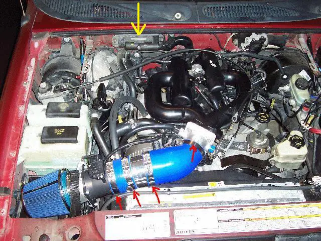

If I am lucky, this is the location of the PCM? What are the chances of it being dead? I just had it reflashed 3 days ago and it had a full working signal to the o2 sensors.
May have bent a pin in the harness
If so just carefully bend it back
Wires look fine to me. No cracks or broken wires.
