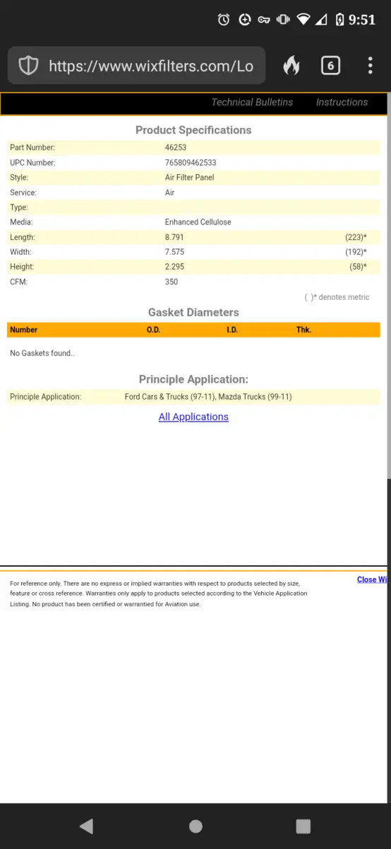

No micron info from wix, but it did give a cfm rating
I also found this info

No micron info from wix, but it did give a cfm rating View attachment 440143
I have learned to never believe in posted ratings on anything! Real world numbers 👍💯
I've seen somewhere else it's 340 cfm. I'l may ask for the flow rate of a afe one as well
