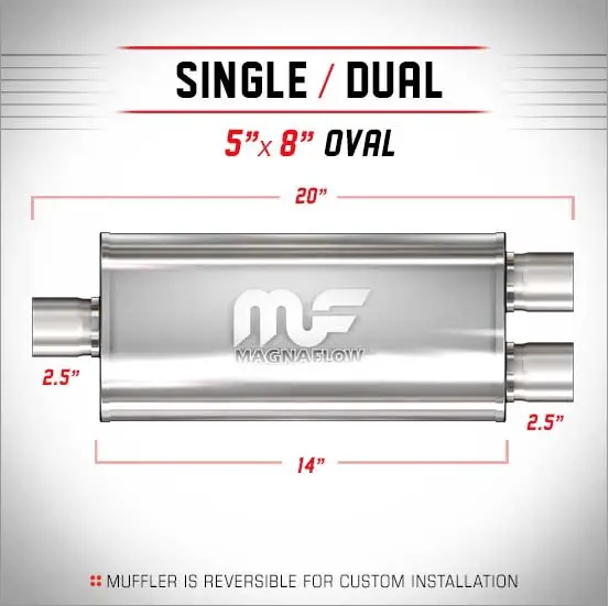

Who makes a 2 in 1 out muffler?
I've seen plenty of 2 in 2 out and 1 in 2 out but no 2 in 1 out.
Dual In/Single Out
The stock muffler on my Sport was a dual in/single out. All of the Magnaflow single in/dual out mufflers are reversible.
^This
I have a Magnaflow on mine. It's a little quiet for my taste though. I may have to get one of their louder ones.
