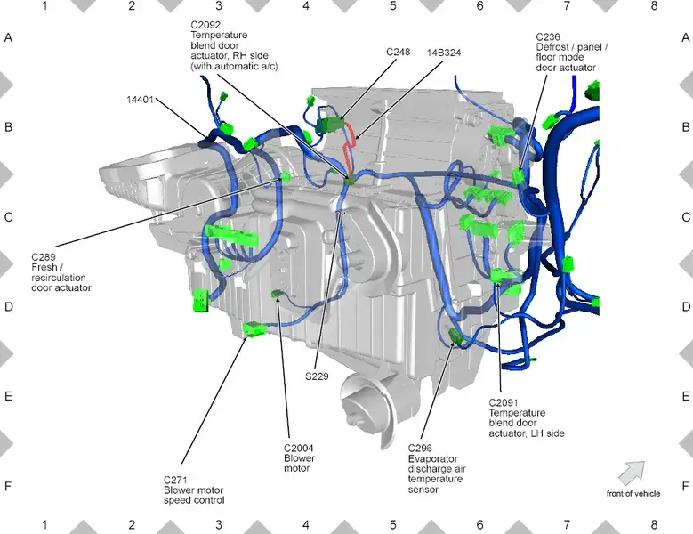

So I used the search function and found that my issue seems to be the passenger side blend door actuator. My issue is my passenger side will blow full hot and driver side will blow cold, when both are set to say LO temp. There is no way to cool it down unless I park the car for a week, which isn't a problem for me right now.
So, I have 2 questions about this.
First, it seems that the passenger side blend door actuator is behind the glove box, from what I have been reading, is it easy to get to? I am only home for a few days every other weekend and live in the Midwest... We all know how the weather can be. Just wondering if it can be swapped out in like 30 minutes or is it going to take longer?
Second, if it's going to take longer, I thought I saw somewhere that you can turn on or off dual zone AC? Is this possible? Would this maybe help to get through this crazy winter we are having where temps can be anywhere from 5 to 50 in a matter of 2 days?

I don't know how much work is involved in changing the part but I did find this.
Peter
I replaced mine last fall. It's a bit of a tight space to get to, but I'd say doable in less than 1hr.
The rear screw that holds the actuator in place is the difficult one. I could only do like a 1/8 of a turn at a time, but at least the screws are coarse thread.
I think the other semi-difficult part was getting the plug on/off due to the tight space.
