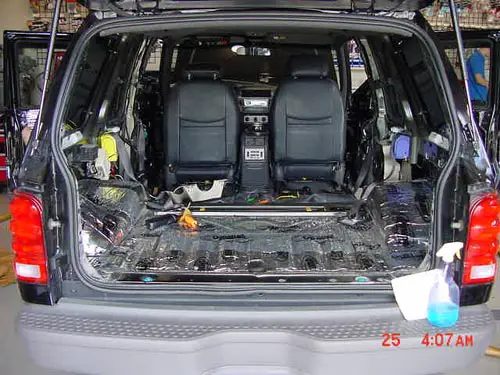

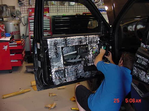

B94Sport.
I checked out your setup. It looks wonderful! I love the wiring job on the amp rack....really cleans up the bulk of the wiring that most people just leave tangled up around the amp.
Did you do that yourself? If so, you did a GREAT job!

Originally posted by overkillphil
B94Sport.
Yep, did it all myself. Design, building, install, everything :) It took a ton of time, but was well worth it. Thanks for the compliments!
