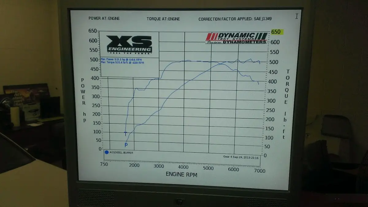

Took the car down and we started trying to tune it myself (with a friend's help), we ran into an issue with not knowing how to change to 3 bar map sensor but we'll figure that out tomorrow. I used Torrie's tune I had in the car previously and adjusted fueling in the aux injector controller. The first pull the ECU limited the torque to 500 and boost to 15PSI. The car rewarded us on 15psi at 505 HP!!!! 15 PSI!!!!! I knew it felt fast but HEY!
You can see the car limiting the torque to 500 FLAT as a pancake.

In my previous dyno's I knew that if I unhooked the factory boost controller that I could get more boost so we did that. The car rewarded us with 23PSI on wastegate spring.
The car has another 5-10PSI available to it once I get everything figured out. We rolled into the throttle at 3K RPM and got a nice pull.
