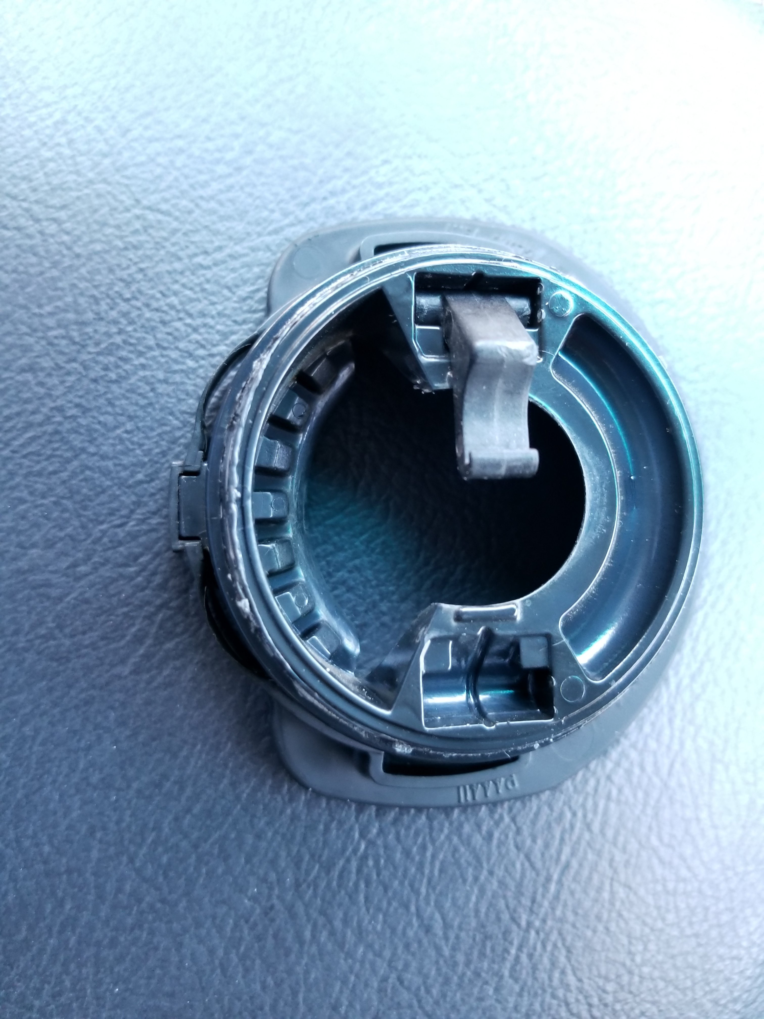

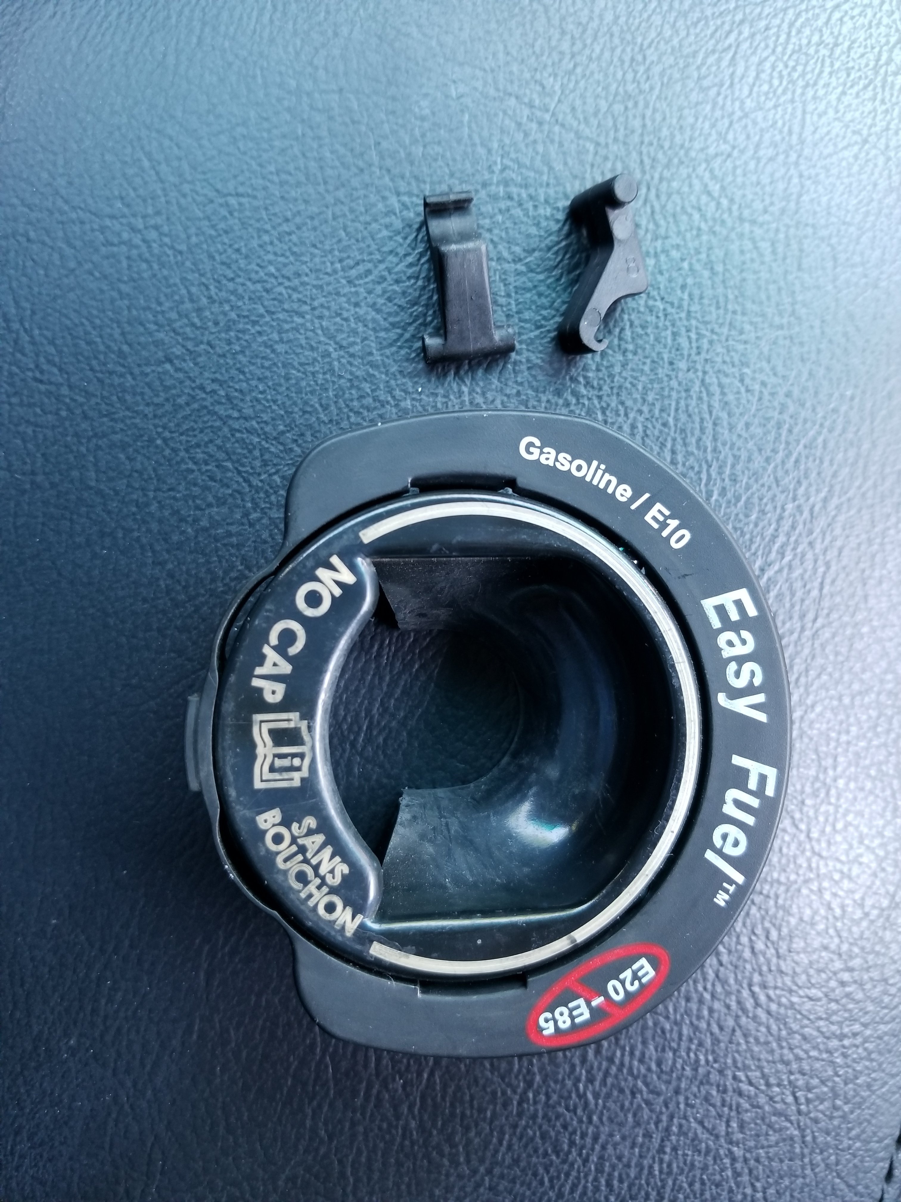

That's a good question, I'm not sure anything jumps off this diagram as what I have... maybe #10? Here are two pics: #1 is the part and the clips that popped off, # 2 is what it looks like now. Hopefully this can just snap back in somehow. Thanks.
Is there anything on the bottom of that ring that those clips would 'clip' to? It looks like those clips might sit in those small grooves shown in the 2nd picture. Just a guess.

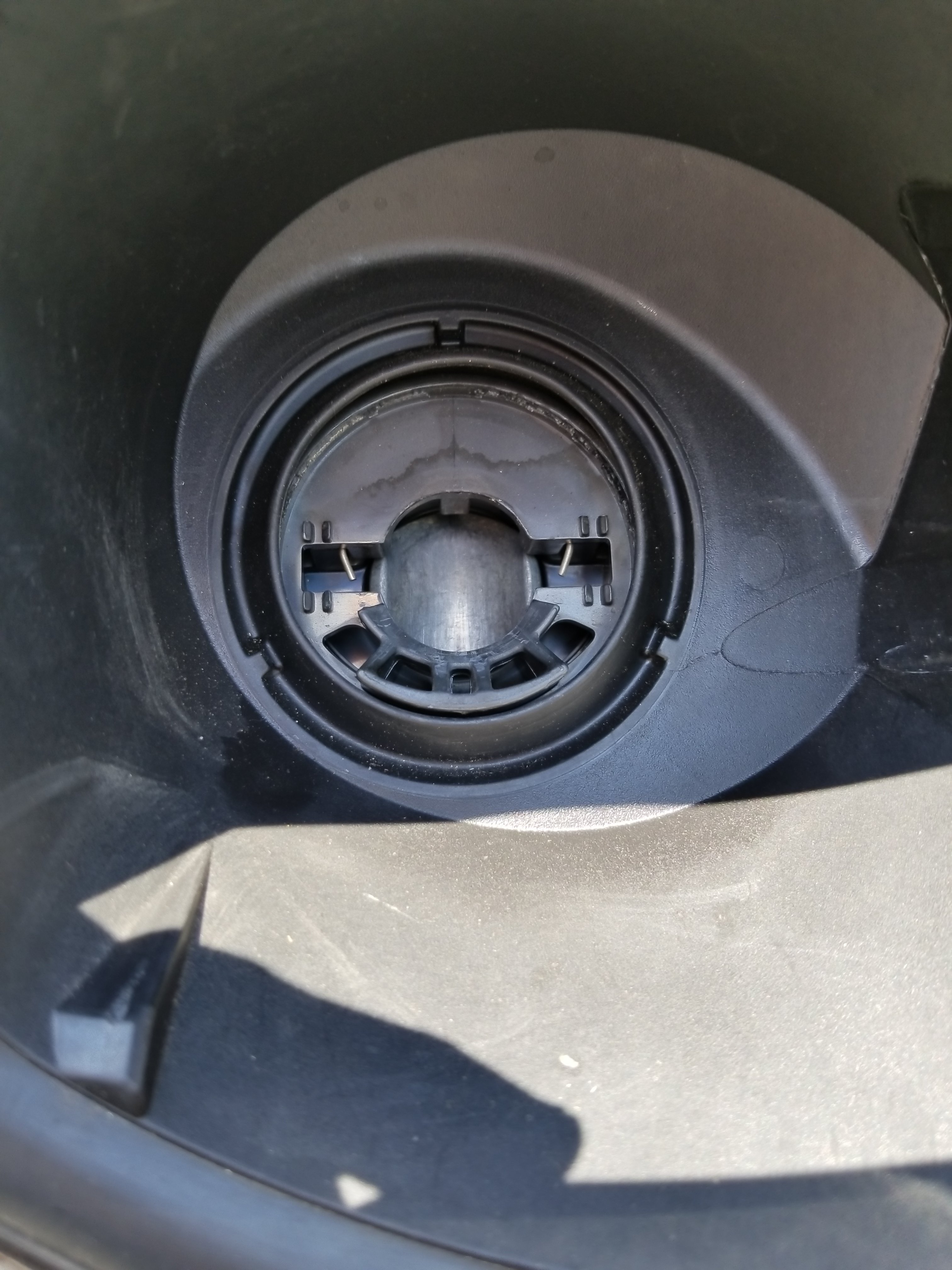

Yes, so as you'll see in this photo.... these clips sit right into the groove. You can also see on the previous photo that there are grooves on the car for it to sit on as well. For the life of me though, I cant get everything to stay together which led me to believe I could be missing something, but just cant find any sort of diagram anywhere on this exact part. There must be a proper way to get it all seated and clicked in place.
Do they lock on the sliver pins that look bent in the last picture? Look to see if those pins are supposed to go across the opening into the other side. Just a guess
The problem is that there is nothing to hold the locking pins in place. I don't know if the two small circles on the side of the slot where the locking pins sit are an indication that some retaining pins broke off or not. It's a puzzler. I think a trip to the dealer is likely in store.
This shot is upside down. You figured out the little black J hooks, they fit into the two slots in the bottom picture from first thread. I really think the hook piece is supposed to go over those silver pins in the last picture in first post. If they go all the way across and lock in.
