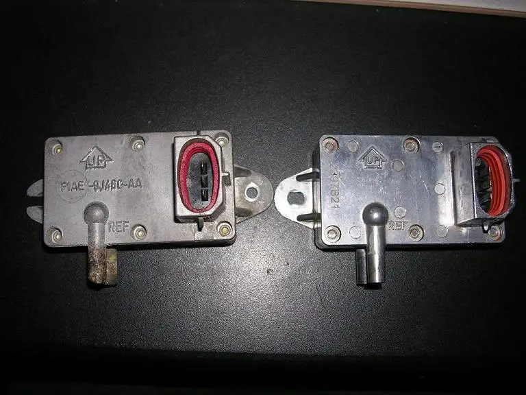

dpfe... the new one i just got looks very similar to the first one i took off the truck a year ago ....very,very similar...but as to it's guts i suppose thats anyones guess. pics........
the one on the left looks like the one i just bought except that where you see the code below the arrow was routered out and is blank for better words .the one on the right is the one i just pulled 3 days agos ...note the difference between the two units.
the back view is very different indeed ...note the missing panle on the one i just pulled on the right .
i wonder if the new one i just got was a actual ford sensor that was sold off to whoever ( under a different name ) and they just took off the ford part code but it still has all of the good quality oem ford parts still in there when ford went to a plastic case dpfe unit ??

yes i understand what your saying ...... i know that the pics that i posted were of "after market" parts .all i was trying to say was that the one that came with the truck from the factory ( right ) looks the same as the new one i bought sevaral days ago and is different ( both oem and the new i bought ) look much different than the the one i just replaced ( left ) .

OK, went out to the 94, and looked at the DPFE. It's black and plastic, but the part number must be on the back of it. The connector is definitely spliced in (physically different than on the old metal DPFE).
The tubes are also attached differently. The tubes on the old style DPFE (as shown in the pics above) are arranged in a front/back relationship (front/back of the DPFE, not the truck). The tubes on the new style are arranged in a side/side manner.

Crap...they offer DPFEs wtih oval and D shaped plugs....I'm out of state for work and want to replace when I return in a ocuple of weekends...any odds on which is most likely the one for a '94??
OK, I have some cobwebs shaking loose now...
Looking at the pics of the "D-connector" and "Oval Connector" versions on the Rock Auto site...
The one that comes up as the "D-connector" looks exactly like my new one. The one that comes up as the "Oval Connector" looks like my old one.
So, where does that leave Boggs? He has the newer connector, but the body of the unit is the older style. Gotta love Ford...
I vaguely recall that while I was hunting around for a new DPFE, I was told by a few parts stores that the part number of the DPFE in my hand (that I had just pulled off the 94 Explorer) was coming up as a 93 model. Seems that Ford recycled an old part when they built my 94 Explorer (must be an early 94).
When I bought the newer one, I had to cut off the oval connector and splice in the D-connector. Wish they had the stupid part number on the front so I could post that here...
I still have no good explanation as to why the aftermarket DPFE that I bought (as an "exact" replacement for the old style I had on there) only lasted 6 weeks, while this newer model has lasted over a year...

so what does this mean the new one i just bought that has the oval connector but looks just like the factory oem one i replaced a year ago ( left pic ) is ok .
did i get a oem dpfe that was sold to an aftermarket company and they ground off the ford part number on the front of the unit ( below the arrow) .....so i'm good right :confused: !? because the one i just replaced ( right pic ...case wise not connector) looks much different than the oem and the new i bought (guess thats why they olny offered a 1 year replacement compared to the new i got that now has 2 )

If you look at the pics on the Rock Auto site, one is black plastic with a D-connector. That's what my new Ford unit looks like.
The other is metal, with the same body as shown above (metal), but it has an oval connector.
Yours seems to be a combination of the two, it's the old body style (metal), with a D-connector.
Does that make any more sense?

ahh ok . so i got a hybrid dpfe ....dam you ford .... lol
just looked at the rock auto site and i see what your talking about now .the new plastic motorcraft one is only $20 bucks more than the one i picked up .
